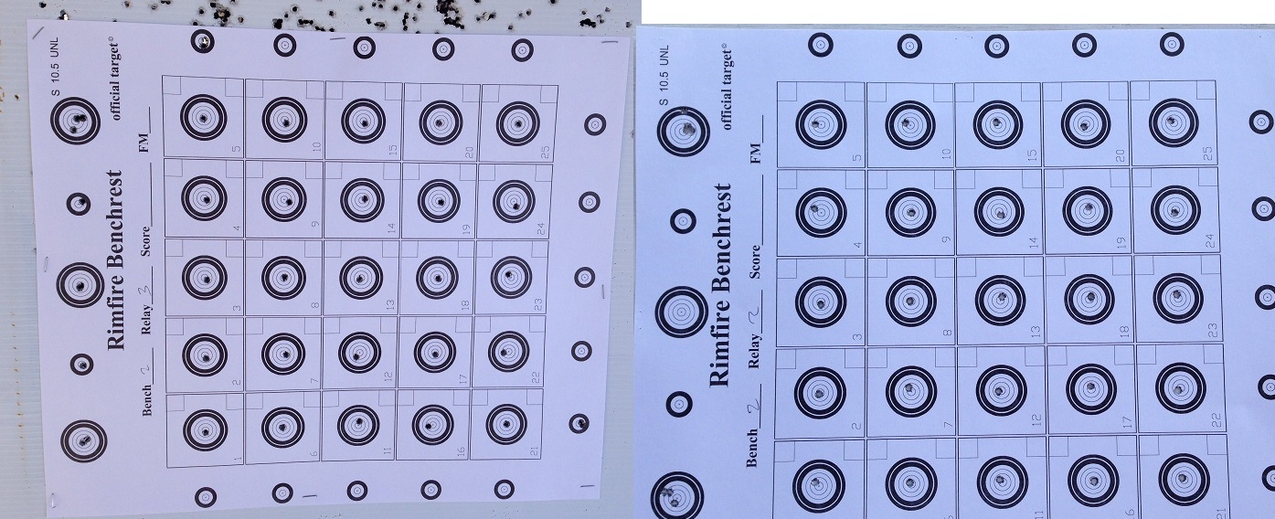

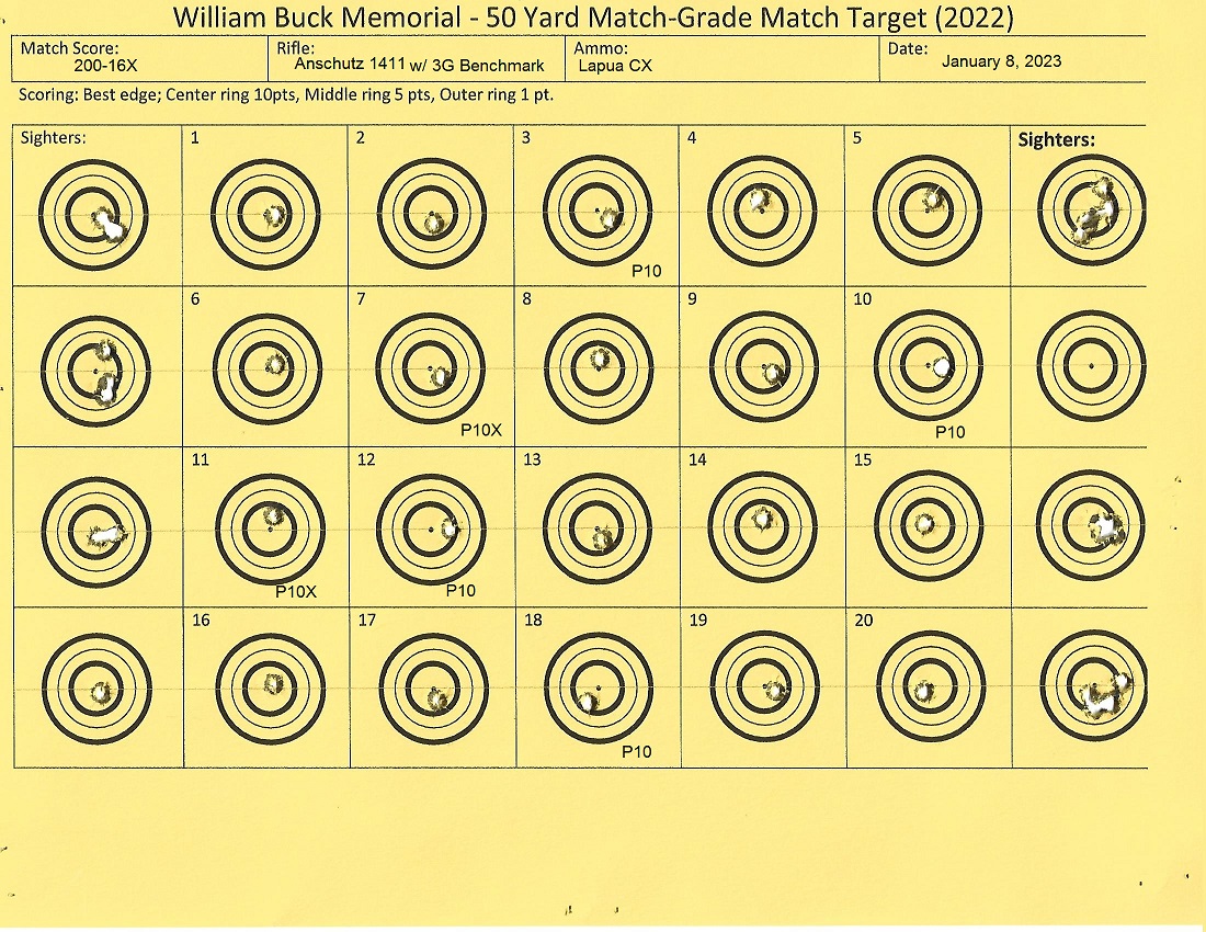

I shot this target this past Sunday in 39-degree temperatures with a new lot of CX that this rifle had never shot before. tuner has been at the setting of 90 for at least the last 6 years. same rifle in 100-degree temperatures shot the other target with a different lot of CX at least a 60-degree difference in temperatures and no adjustment made to tuner. so yes, it is achievable.

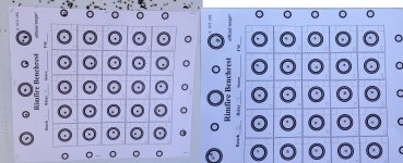

These targets are a good example of what I am saying target on the left was shot in February (250-19X) of last year and the right August (250-21X) of last year where temperatures were vastly different. if you look at the horizontal height for each shot on both targets and they were shot with the same lot of CX if you drew a line across the shots would all, be intersected by the line. all I did was adjust POA lower for the August target.
