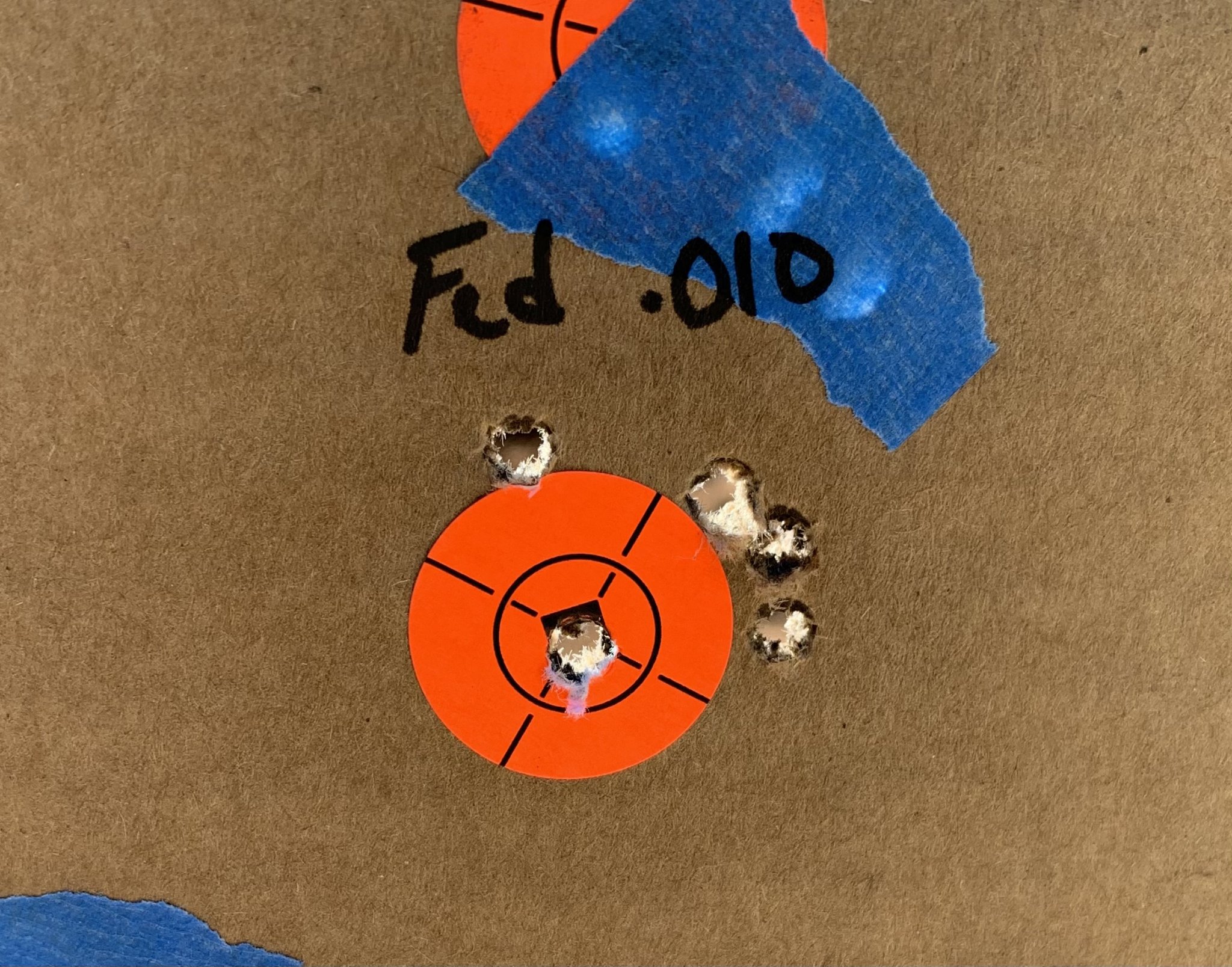

    So far I haven’t had luck with my tikka 223. I’ve had some very small groups, but followed with a ES of 30-40 and a SD not much lower.
    Lucked into some federal match primers and trying them... had this group shoot with an ES of 4 and SD 1.4..... but grouped like this: what gives?
    Play with seating depth to tighten up the group. Load up 3 rounds each with progressively longer jumps by .003 or .005" increments. You'll find a couple of groups that are nice and tight. Note the seating depth and load to the long side of that seating depth load.

    I had three different loads with the same powder charge today and this was the load that had the shortest overall length. The other two longer loads shot about the same group size but the numbers were not as good.
    Seating depth changes should have little to no effect on ES and sd of the same charge weight. Neck tension variance can play a considerable role in es and sd's. I would double check you neck tension and start eliminating variables from there.

    I was wondering if this could be the issue. I am just using the basic hornafy dies. Wondering if I should upgrade to a nicer set for more consistent neck tension.

    ES and SD have little relation to precision, at least until the range extends enough that vertical spread becomes an issue. ES is basically meaningless, it's possible to use it to reject a long range load, but otherwise it has no value. SD is meaningful to estimate maximum vertical dispersion at long ranges, but only if it's measured over a 20+ shot string. An ES of 4 and an SD of 1.4 is pretty much impossible to measure without Doppler (and no, the LabRadar does not qualify) as the inherent instrument error is greater that that.

    Precision and accuracy are not the same thing. The displayed problem is one of precision. Many possible reasons for this, none of which are related to the velocity spread/deviation.
    Does the rifle shoot any factory match ammo well? If so, it may be best to start trying to replicate that, so one can eliminate problems in the reloading process

    I have only had one Tikka, a 10tw 243, but have read, most tikka's have some screwed up freebore lengths. I would try find bullet to land relationship if you have not. What bullet and powder are you using, there are some easy combo's out there that may simplify things.

    8208 and 77 smk.
    I seated some at AR mag length just to see how they do jumping.
    I have tried at the lands, .02 off, .025, .030 off....
    Seems the deeper I seat them, the more promise my SD shows. Have had some really good groups but numbers not so much.
    Will report back tomorrow after I shoot the mag length ones
