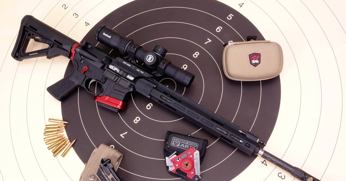

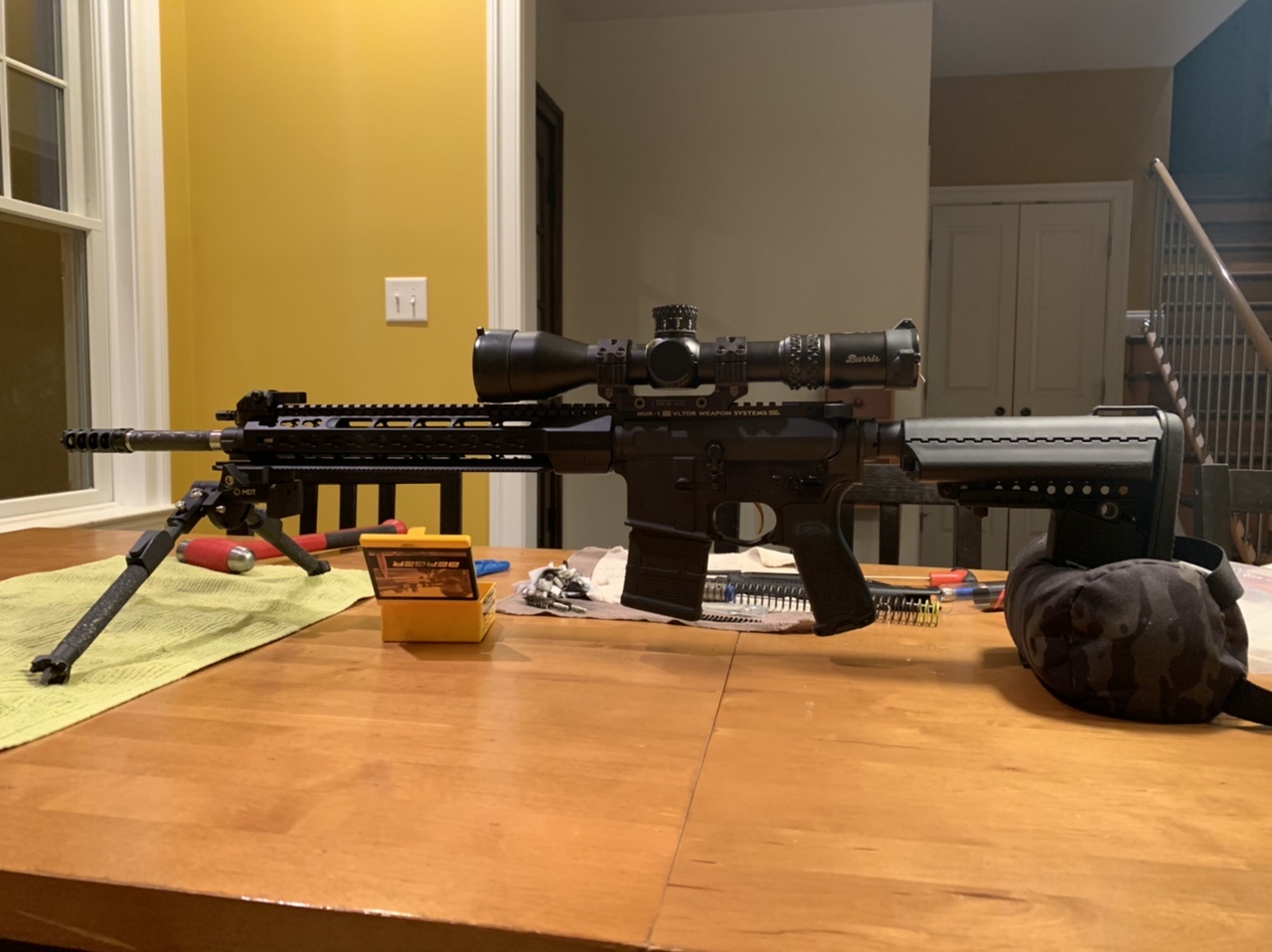

    I got a deal on a barrel (4th of July sale) so decided to build a gun around it. Purpose is to shoot PRS style IWI & Geissele gas gun matches.

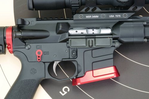

    Build list:
    Upper.
    VLTOR Mur-1 upper that's unmodified. Accushim added to upper for a slight drag fit of rear take down pin.
    Mega Wedge lock 12-5/8" rail that I had to mill out the front of (I know sacrilege)
    Proof Carbon 18" 223W 8T. Gas system is .815 dia & 5/8" shorter than RL so intermediate I guess. The gas block is Iron, pick rail on top, fully adjustable, keyed to barrel, retained with a nut, & straight gas tube attaches via flared compression fitting like a brake line
    SRC low mass BCG - Head space was Go +.002
    Geissele Airborne CH
    Precision armament Hypertap brake
    Area 419 Keymod Arca rail (I also had to mill this to fit)
    Topping it off will be a MPA 1.25 x 34mm mount & an XTR 3 3.3-18 SCR-2 mil.
    Lower
    Std Forged Lower machined for Ambi bolt catch (Teal Blue Bravo catch)
    AR Gold trigger set +-2.5lbs
    BCM mod 3 grip
    VLTOR EMOD stock with the RE10/A5SR extension & A5 buffer/spring setup.

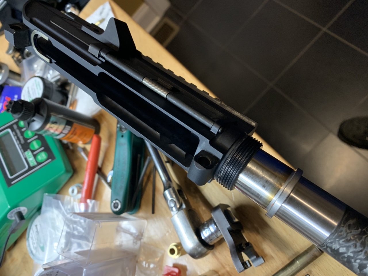

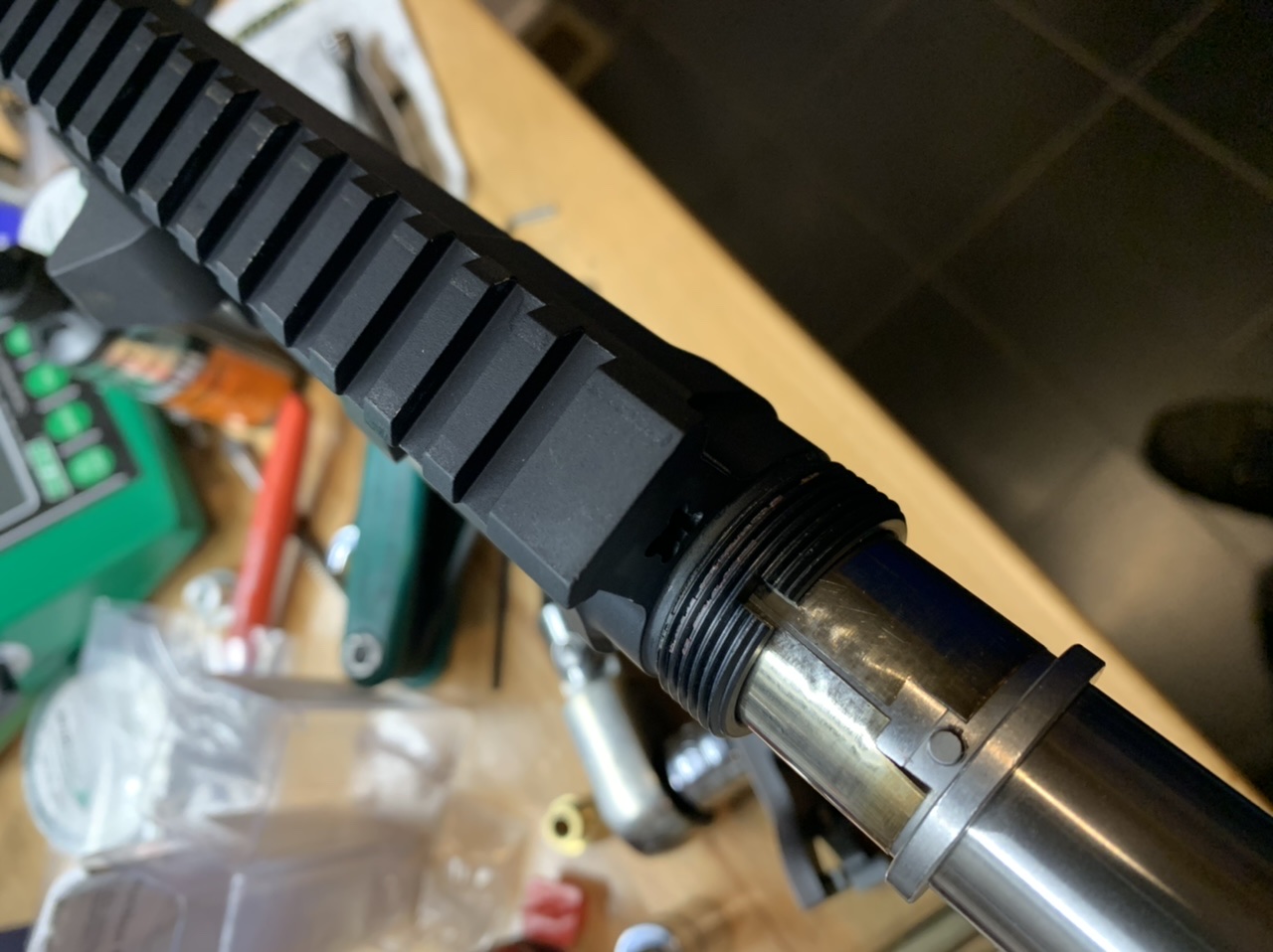

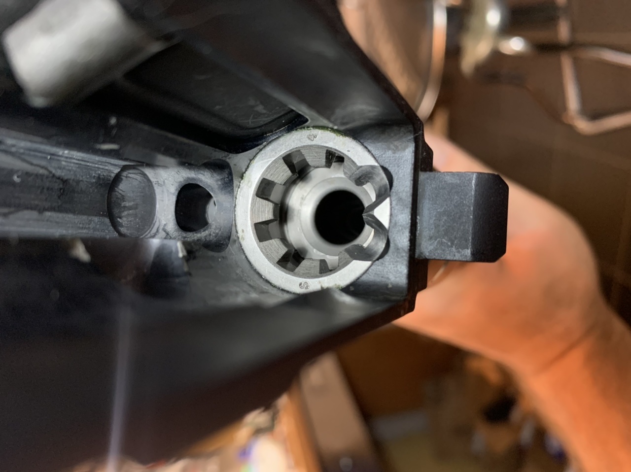

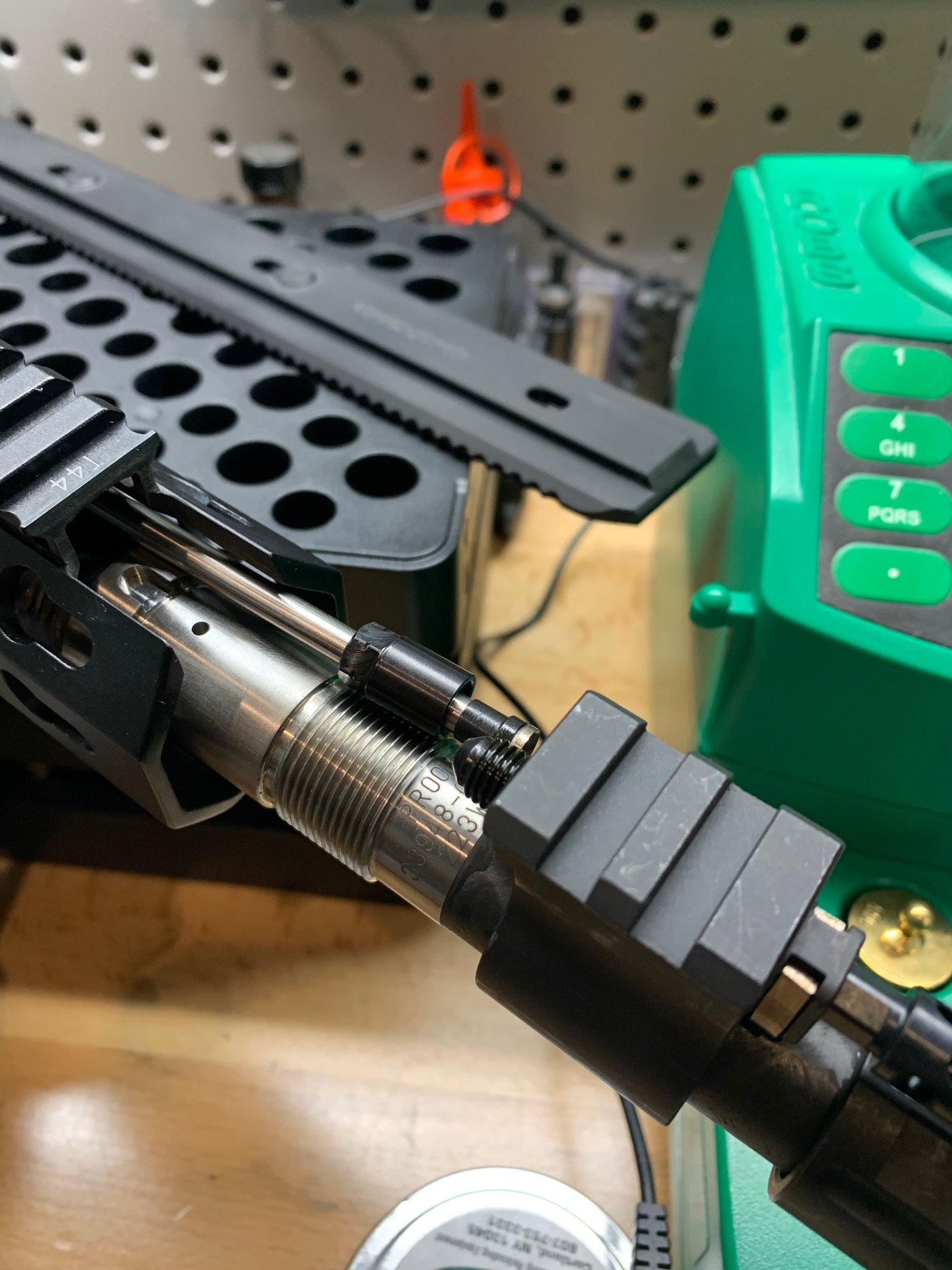

    VLTOR MUR-1 upper receiver face unmodified & barrel extension was pretty loose. Barrel just torqued 60 ft lbs dry fit.
    As detailed in the build list above, this barrel is and oddball. It was a run Proof did for the Savage MSR competition rifle. As of 2022 Savage has, without any notification removed all AR platforms or even mention of them from their catalog.
    Thanks to their Woke-mess & the likely lack luster sales for the $3000 MSR I got a great deal on the barrel from Stockey's. It included the Steel Gas block, gas tube, & a really ugly 2 port brake.
    Unfortunately the Savage handguards for this rifle were probably all burned in a fire pit to pledge some sort of Woke allegiance BS.

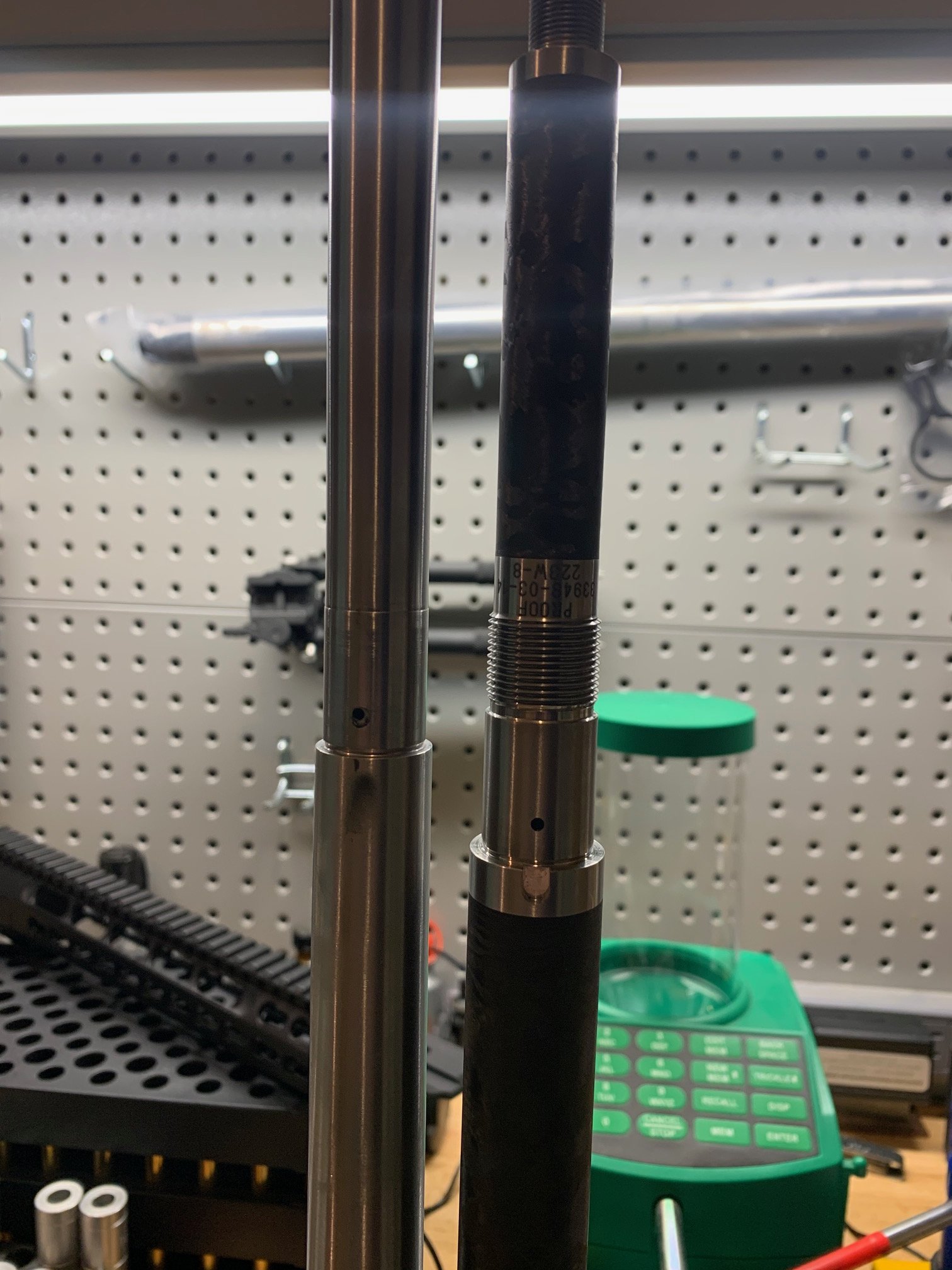

    The gas system is 1" short of rifle length & combined with the pic rail gas block, limits handguard length to about 10.5".
    There's a lot to like with this barrel. Profile is IMO pretty close to ideal for a Carbon 223 with the .815 gas block size, the threaded/keyed block retention, and the flared straight gas tube. I liked it enough to offset the PITA it would be to fit a handguard. Plus I already had the 12-5/8" Mega wedge lock (keymod) & the Area 419 Keymod Arca rail.
    Pictured below is this barrel on end next to a proof steel 20" with rifle length gas. Also a pic showing gas block/gas tube - handguard fitting.

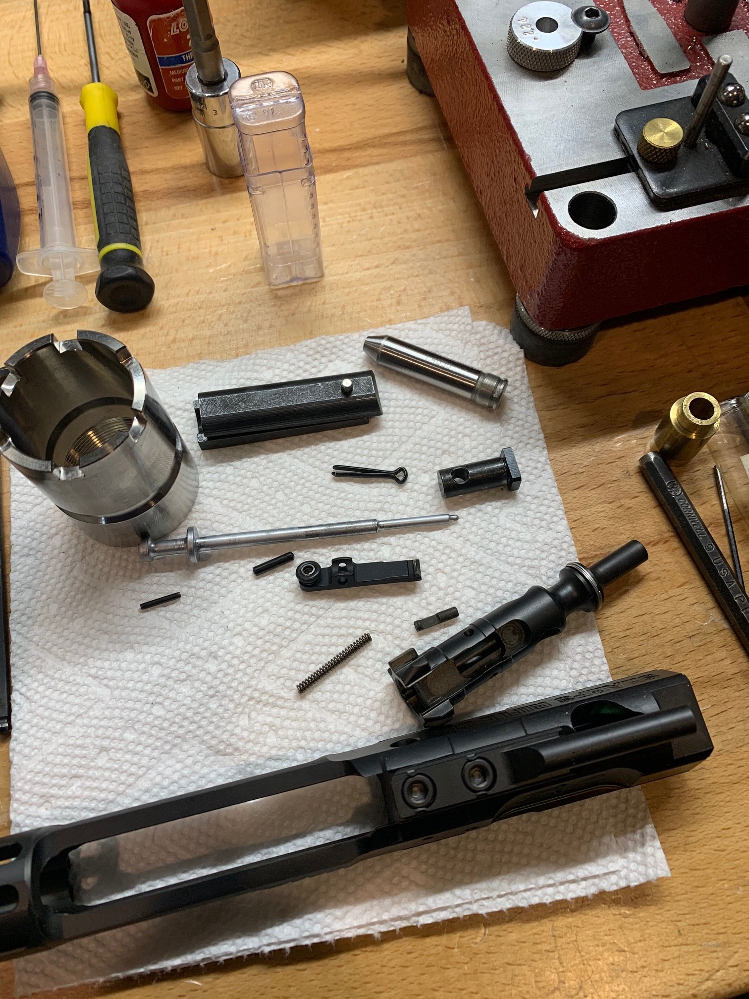

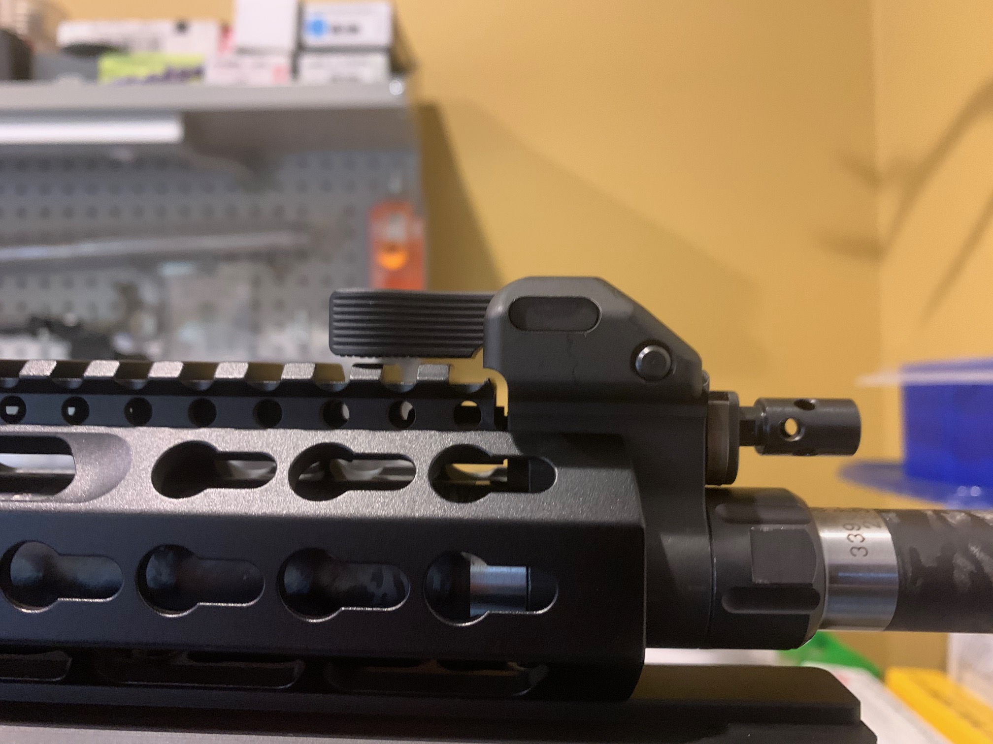

    Did the usual tricks. Bolt extractor & ejector removed to check head space. Rounded the ejector & deburred the extractor. Not pictured but check & blend M4 feed ramps as necessary (they matched really well on this one).
    Yeah I chopped a Mega wedge lock. At least it was a key mod I chopped on. Insured clearance all the way around this bastard gas system to handguard. Even had to cut the bottom back of the LWRC front sight to clear. I like the look, it was worth the effort to me.
    Just need to get a taller scope mount so the rear buis will fit.

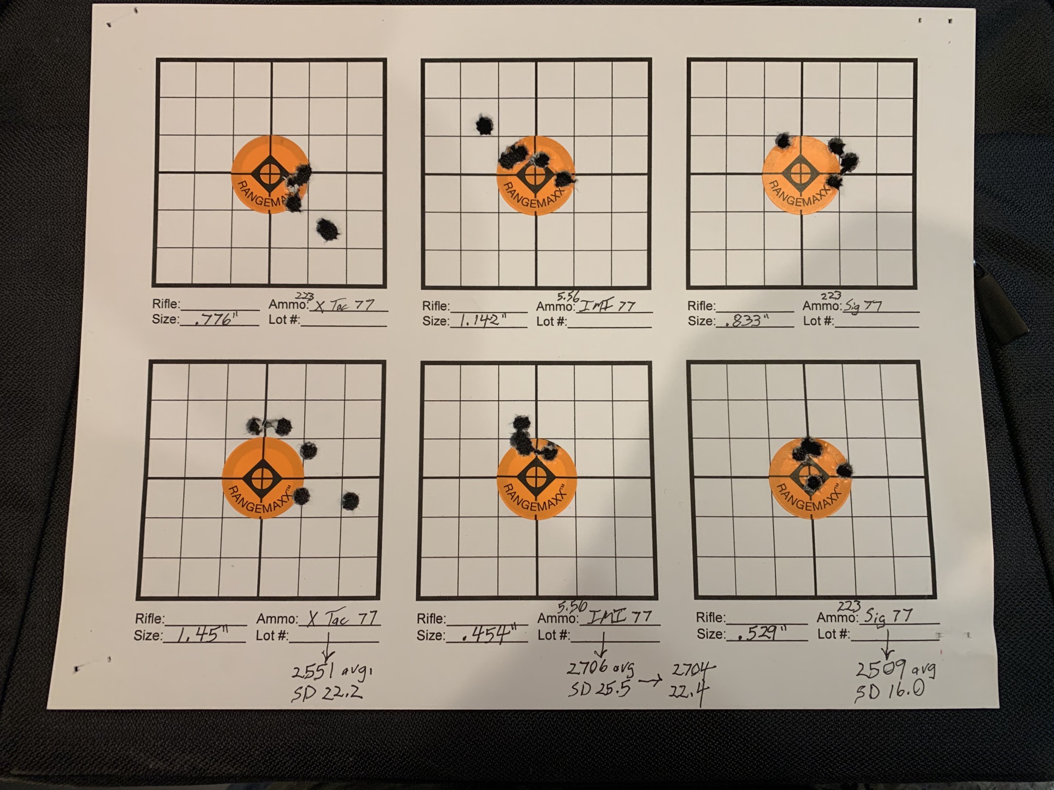

    Part A first groups.
    Factory 77gr Ammo used.
    Break in sidebar: When I say break in it means adjusting gas & that's about it.
    I think "Barrel brake in" for a quality single point cut & lapped barrel is hogwash! If it's right it needs a couple patches and then let it rip.
    The above is exactly what I did. Few patches & off to the range with no cleaning gear.
    I was short on time for the range today.

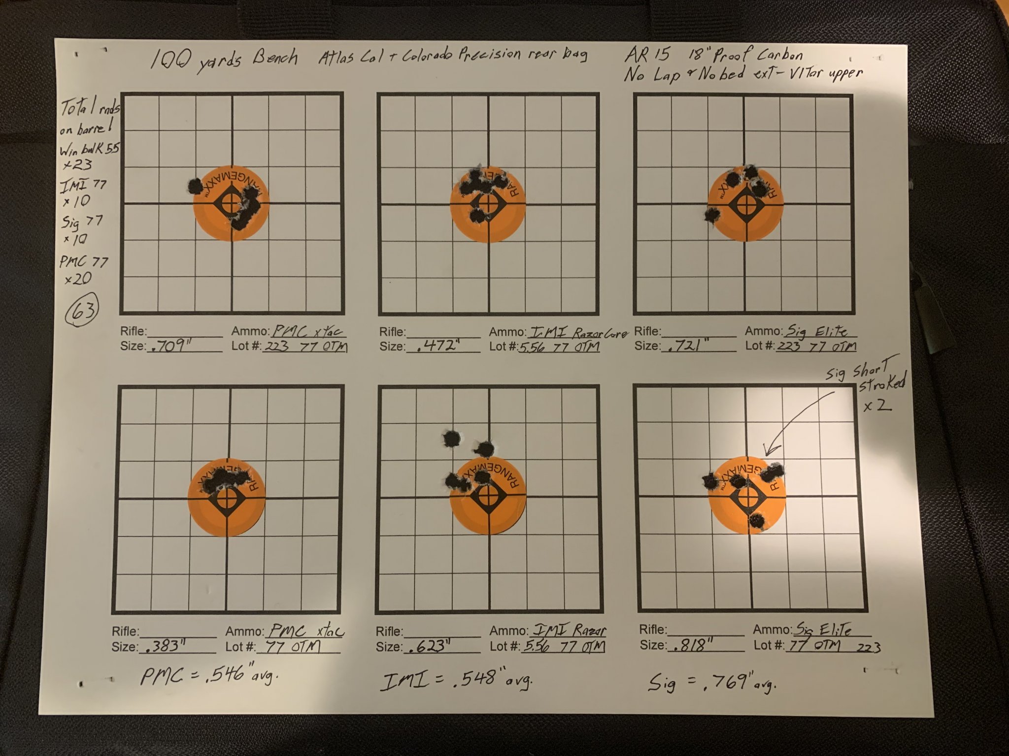

    Started with Winchester 55gr bulk 5.56 FMJ. Shot at paper @ 50y, missed paper, burned 1 at a leaf in the middle of the berm, up 10mils & right 1, then hit leaf. Added 2 clicks gas & shot paper. The bulk 55gr group @ 50 was pretty bad.
    Total of 23 rounds Win 55gr shot at 50y berm.
    Moved to 100y & shot 5 x 77gr PMC at a 3" target. Adjusted scope & shot 5 more.
    Then shot the below 6 x 5 target. The target was shot left to right top & then same for bottom. The only malfunction I had was on the last bull (bottom right). I think the Sig 223 77gr is slow or at least makes way less gas then anything else. It didn't lock the bolt back on the first group (top right), but I didn't want to add gas in the middle of the 6 x 5. So the bottom right bull I had 2 short strokes and had to come off the gun Twice.
    This was shot off a stupid T bench. Whoever came up with that bench design should get punched in the dick. Arms hanging off both sides.
    I also realized today that I'm going to need a flat rear squeeze bag for the Emod stock. The foot on this stock is really small so the round rear bag wasn't ideal.
    Rounds 33-63 shot on 6 x 5. Barrel is broke in now.
    I'll tear it down tomorrow. After the next 6 x 5 I'll get some speeds.

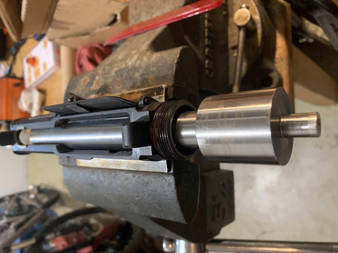

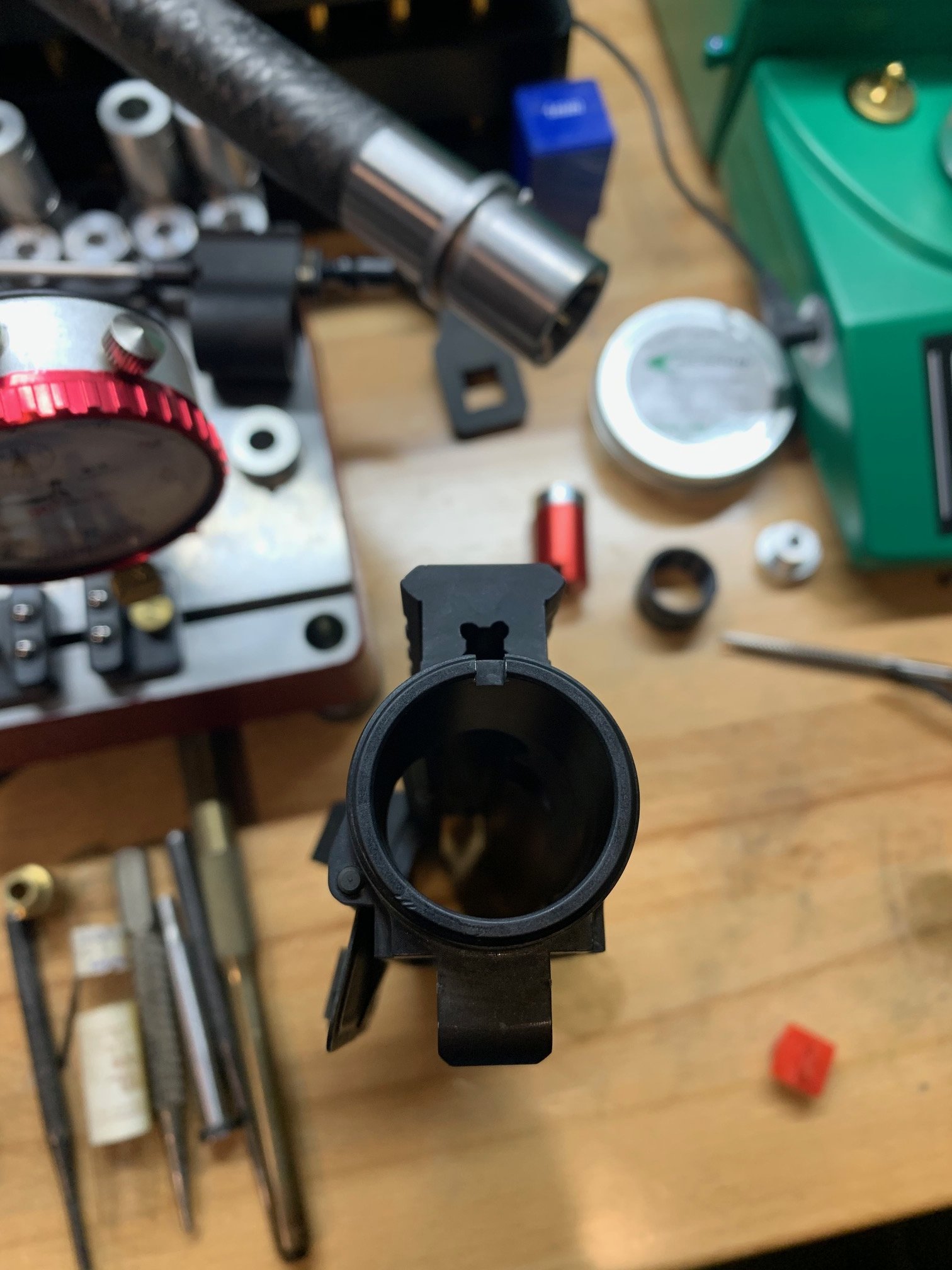

    How did you go about measuring the relationship between the face of the receiver and the bore to determine the it was "squared up" after removing a bunch of metal? You removed so much metal that it was off 10-15 MOA at 50 yd ? not sure how that would give you the confidence that it is "MUCH MUCH better now"
    I used the Brownells tool. Some of my uppers just needed a little lapping, some needed basically none. This one was an outlier, it took me a while to get it square. TBH, I think the barrel must have been canted or something by the the receiver face being so “unsquare”. It’s been a long time since I mounted and zeroed that scope on that rifle, but IIRC it needed a ton of adjustment (more that what I’d call “normal”) zeroing it. I had always assumed it was the scope mount or somethin.
    BTW, I never removed the scope or the scope Mount when I lapped that upper, so it wasn’t a scope issue.
    ZA

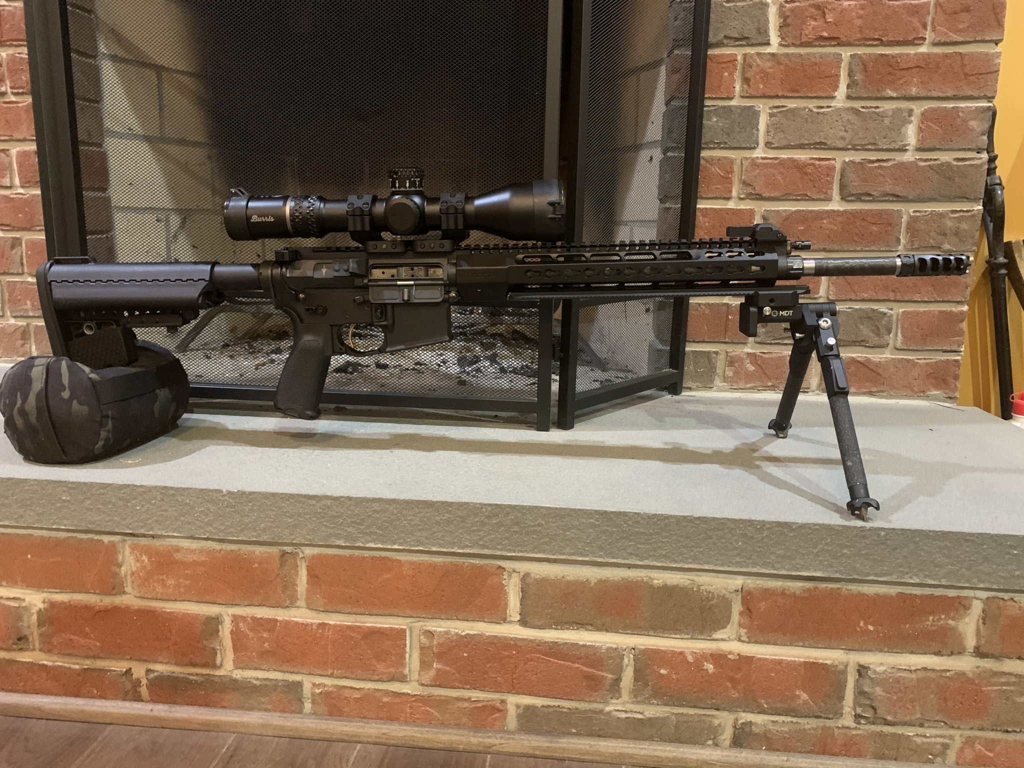

    Spoiler alert, the damn thing shot better when I slapped it together. Hell .621” avg for a 6x5 with 3 different factory loads would be pretty hard to beat & it didn’t.

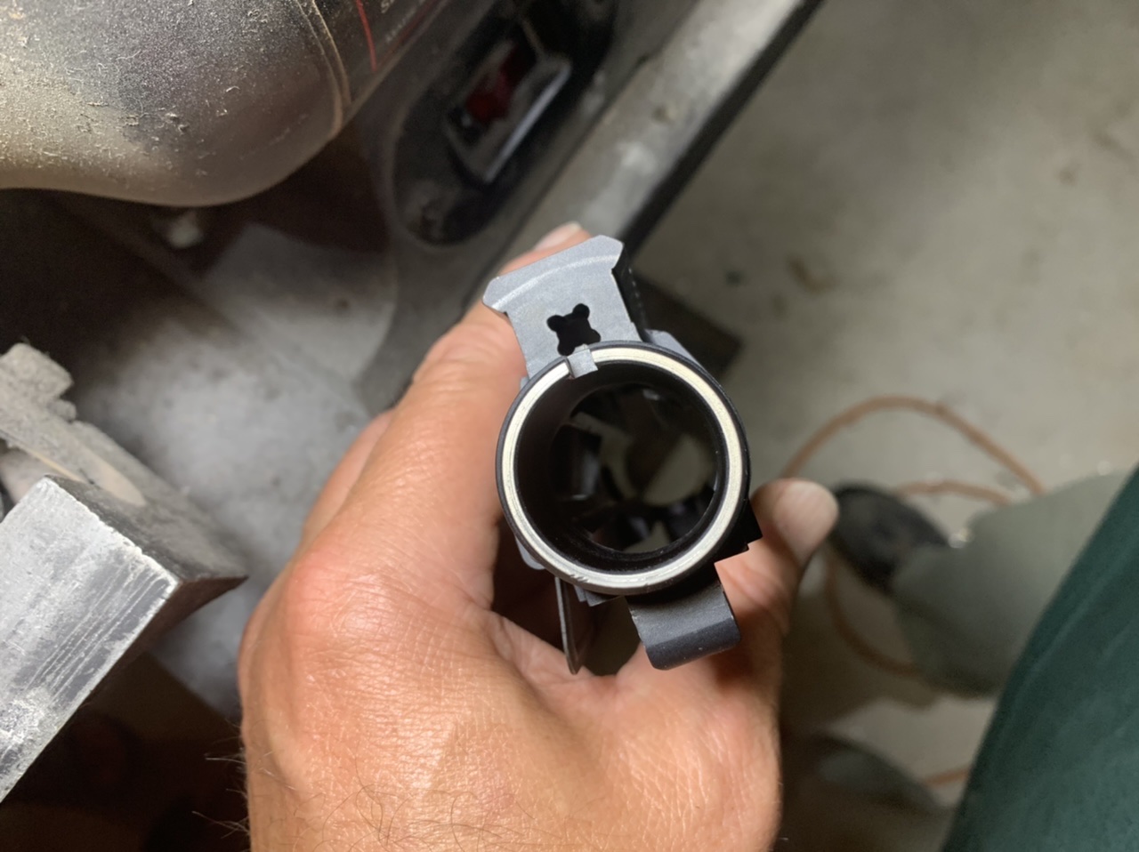

    So when I went to lap it, to my surprise it was the squarest VLTOR I’ve lapped. It was also the only gen 1 VLTOR I ever built.
    Since it cleaned up so quickly I went ahead and shimmed the extension also. It was loose & took a full wrap of .001 shim + Locktite 620. That gave it a tight fit that I was able to get within about 1/4” from fully seated before having to tap the last bit with a rubber mallet. If you look close at the image showing extension and ramps the edge of shim & a little 620 is just barely visible.
    Everything else was the same with 1 exception. The Geissele airbore charging handle was binding so I swapped it for a known good geissele super CH.
    Didn’t even add gas since I wanted to be the same.
    Same shitty bench, same bag & bipod. Same 20rd pmag. Same ammo lot shot in same order. Same round count from clean barrel. 23 x 55fmj, 10 x 77 xtac, & then 6 x 5. No out takes or do overs.
    I did need .3 mil rt. & .1 up to get same POI, but scope was also R&R’d.
    Some of the inconsistency was surely me as I wasn’t super settled in. The last 2 groups bottom right I was pretty consistent (loose hold). The gun shoots well with all 3 brands of 77 that varied 200fps.
    After the 6 x 5 I ran all three loads over the Magneto V3
    PMC 223 X-Tac 77 = 2551 avg SD 22.2
    IMI Razor Core 5.56 77 = 2706 avg SD 25.5
    Sig Elite 223 77 = 2509 avg SD 16.0
    Left the Magneto on and ran 5 Of the IMI @500y 10” plate. It held a 1 moa group, but I suspect the large SD is just starting to show at 500. At 700+ I’ll want hand loads with hopefully sub 10 for SD.
    The test wasn’t great. A rest would make sense for something like this, but I don’t own one. I shoot bi-pod bag or positional bag.
    My take away is that with Quality parts & 60+lbs barrel nut torque combined with a free floated rail. Lapping and shimming doesn’t do much.
    Looking forward to putting some of my own loads through this.
    View attachment 7933499View attachment 7933500

    You can’t deny how well this thing shot on the first 6x5 with just proper assembly.
    I am satisfied with my conclusion & that’s why I did it. By all means run your own test. Hope you prove me wrong.
    No doubt a better test could be run. It would take more rounds, a repeatable rest, and only make 1 change at a time. I don’t get payed for this & my time comes at a premium these days.
    In my case, either I couldn’t shoot the difference, couldn’t shoot consistently enough, the next box of ammo (same lot) might not have been as good, or it changed harmonics for the worse with this ammo. It wasn’t even gassed optimally, but I wanted both 6x5’s the same. Even if it did hurt it harmonically with these loads, it may have improved it’s potential for a tuned load.
    It is kind of noteworthy that it shot the Sig the worst on the first 6x5 & the Sig shot the best on the second 6x5.
    That's debatable, mainly because you separated the # of rounds fired with each ammo into separate groups, so as to get smaller "group sizes". If you overlap both targets for each ammo on the same target/POA, NOT centering on POI, then your group sizes change. Even more accurate would be to measure mean radius to POA for all of the rounds, and then compare that number.
    Even beyond that though, you fired barely a minimum amount of ammo to even start getting an idea how it performed. Certainly not enough to conclude whether truing and gluing makes a difference.
    You also only tested 1 rifle. Go talk to any scientist or test engineer and tell them you ran a "test" on one sample, and drew a conclusion about a general operation for all rifles in a population.
    Personally, I'd say that your info is one data point out of many needed, and somewhat incomplete at that due to the # of rounds fired and methods of measuring groups.
    @Yondering - I agree with that assessment.
    I also acknowledged the test was not the best. I only had enough of the Sig factory 77's same lot to run the Two 6 x 5's.
    Still I'm satisfied that with bipod/bag 6 x 5 it didn't produce the magical mythical results many imply. I couldn't shoot the difference. My bolt lugs will thank me though. It might also have benefits as the barrel gets hot? Don't know, but I could see it helping consistency when conditions get unfavorable.
    Although it was my 3rd VLTOR MUR build & it was the only Gen 1 VLTOR I've built. The Gen 1 was considerably more square on the face, but it was just as loose on the extension fit. Also did 1 VLTOR Fusion monolithic & it was out of square & loose on the receiver fit. Every other VLTOR build I've done has been squared and shimmed. Same for Aero. BCM's just get squared since they are thermal fit.
    What I hoped to learn from this was 2 fold.
    1. Does lapping and shimming make a big/shootable difference when already using quality parts & good assembly practices.
    2. Is the extra effort worth it in practice?
    Of coarse the unseen benefits include improved bolt lug alignment. I will continue to square and shim all of my builds. Shimming is a large PITA and I've been mostly using BCM's lately that only require squaring.
    I just think some of these things get blown out of proportion as to there importance and expected results. Squaring and shimming a shitty barrel with a questionably machined extension that shoots like crap isn't going to magically make it shoot.

    I hear that, time and money (for components) is limited so it's hard to run a really comprehensive test. But that's my point - knowing that your test wasn't comprehensive, don't jump to a conclusion that your test doesn't support. Your target results before/after are within the scatter for each other. And if you overlay the targets instead of separating them into smaller groups, your results are more the same than different.
    On top of that, you've said it yourself - you started with a setup that was already very square and shot well. Of course you didn't see much or any improvement. So why did you conclude that truing doesn't help? That's not a logical conclusion.
    Do the same thing with an upper that's loose and crooked, and it'd be a different answer, and more representative of what the goal of your test was.
    I guess, being a professional test engineer, this is sort of a pet peeve for me. But handloaders and gun people in general are often our own worst enemies when it comes to "testing" what works and what doesn't - most of us conduct some half-assed "test" that has multiple variables, too much scatter in the data, and usually just a single sample, and then proclaim to the world that you've tested something and made a conclusion. Even worse is that most of this group has no idea how to judge whether a test has any validity or not, and just accept the conclusion as fact. And some people wonder why everyone argues about gun stuff - everyone makes decisions about what they think is truth without judging the evidence rationally, so they all come to different conclusions.
