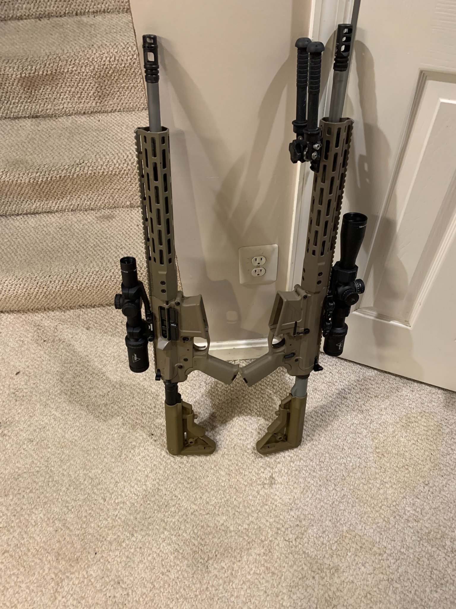

I went with a 16” Wilson Combat. My AR308 built on a standard aero set is about 7 lb 8 Oz naked with no lightweight parts

I did a 3 gun lightweight build of an 18 inch Gunner profile Faxon match series that was .7 MOA all day long even with xm193. Got a superlative adjustable gas block, but even so, seems the gas port is a good size, very flat shooting. Ideal build for a skinny barrel.
