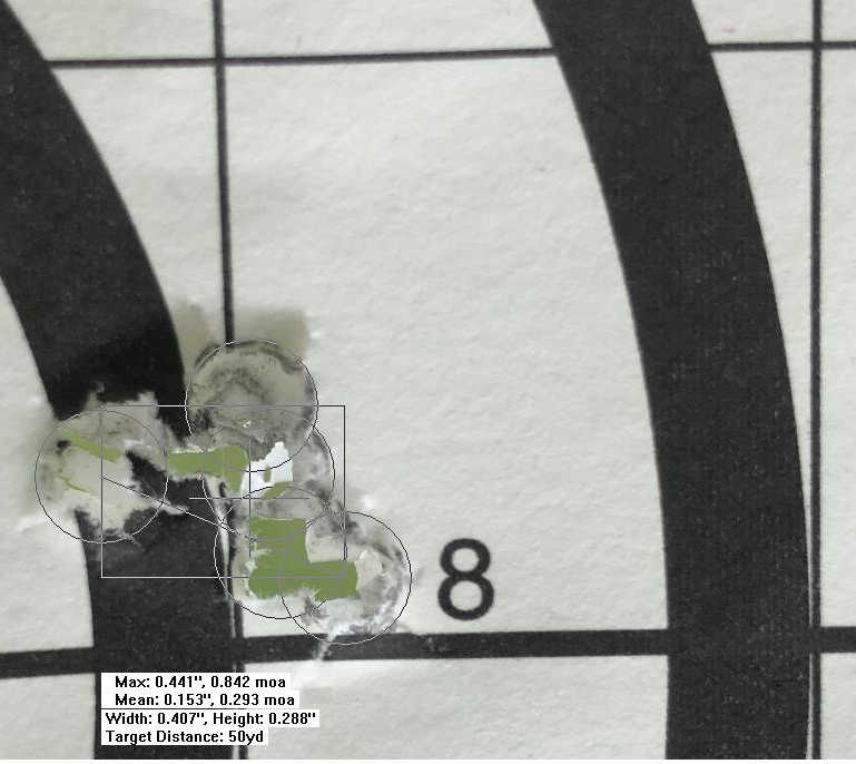

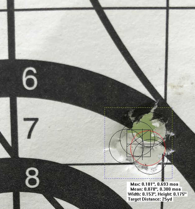

I was trying to buy a scrap bull barrel from Feddersen, but didn't have any luck. But Sandra offered to sell me a my choice of 2 barrels they had returned in the last month at a slight discount: one threaded and another not threaded 16.25 inch bull barrels. While talking to Sandra on the phone, I found out that one of them was the last return mentioned in this thread which peaked my interest. So I bought both barrels. (At least that's my "excuse" for buying both.)
I built a new <ahem> "cheap" custom 10/22 this week out of a Brownell's receiver (bought on sale), Ruger bolt and charging handle, EGW 20 MOA rail, Hogue over-molded stock, Kidd 2-stage trigger (slated for another rifle) and, of course, the Feddersen threaded barrel. I temporarily put on a Athlon Midas TAC that I had just pulled from another 22LR I traded yesterday. The first shots didn't even hit the target due to the inserts previously installed in the Burris XTR Signature rings. I didn't take time to replace the inserts or even zero it as there was some rain about to start rolling in. So I just aimed high and shot a few groups. I had groups that were better and worse than these. To make it fair, I picked the first 5-shot group at 25 yards and 50 yards rather than cherry picking groups.
25 yards:
50 yards:
Ammo used? Aguila SV bought at about 4 cents per round delivered. Remember that it's very possibly that it's the shooter rather than the rifle that produced the spread in the targets today. I am not an expert shot.
The question becomes if this is an average group for the barrel, given the ammo used, would you consider it acceptable?
