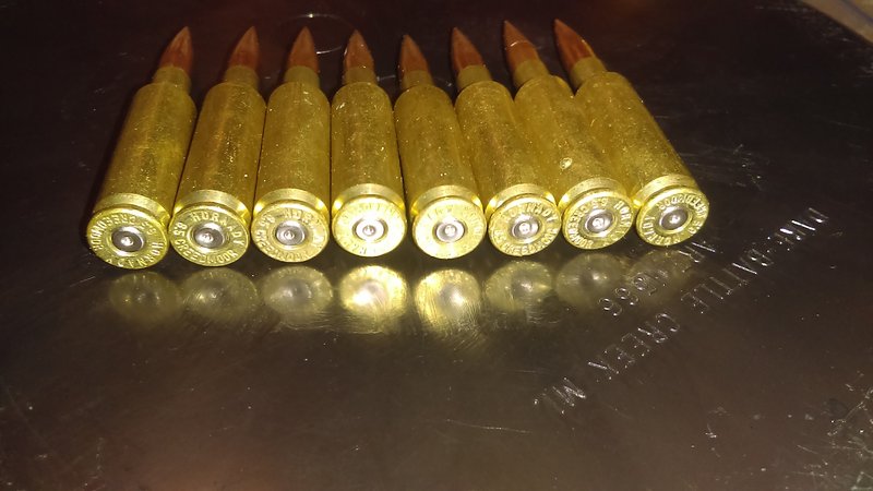

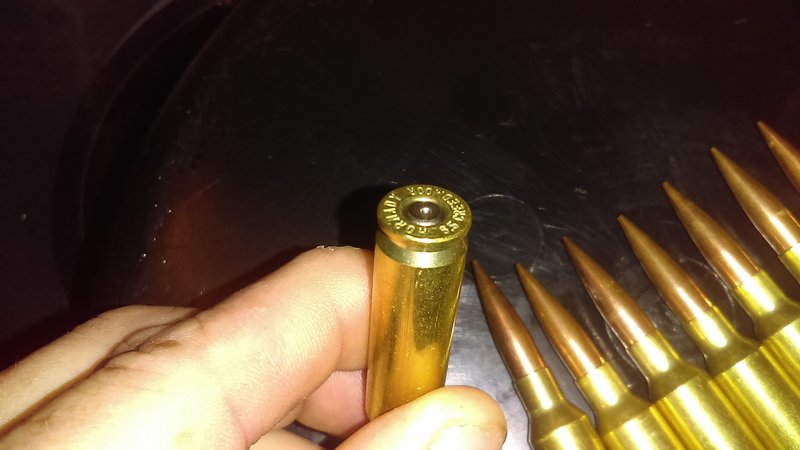

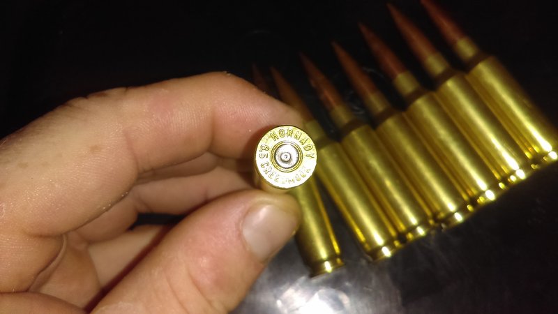

    Does anyone know of a bad lot number? Last night I loaded up 75 rds in my 6.5 and had 8 failure to fire. Put them all back in 2 more times and nothing. Good primer hits. Never had any issues with this rifle.

    Take an open flame to the primer and see if they'll ignite
    also try hitting one with a hammer. It's best if you have the hammer pre laid on the primer and strike the back of the hammer with another
    your primer pockets or inside the case weren't wet by chance? Just Want to verify you ensured cases were dry IF you SS wet tumble
    Only used Federal n CCI since the 70's. I've never had a primer fail to go pop. Interested to know if you're able to get them to go off. Interesting.......
    Igniting a primer that's not confined in a pocket and against a bolt face is not a safe practice. JMHO.
    Measure pocket depth on those vs the ones that did fire.
    Are you seating to a certain depth or bottoming out in the pocket?
    I had that issue with Federal 215M primers in my 338. Looked like good primer strikes but no fire. Turned out the firing pin spring was dirty and needed a good cleaning. Never an issue since.
    Sent from my iPhone using Tapatalk
    I'm seating them like I seat any other primer. They aren't recessed. Primer strikes are good. Just not going off.
    They have to be bottomed out and then seated slightly further to sensitize them. I seat everything with a hand primer and I can feel the primer reach the bottom then moved a little further which means the anvil is then contacting the primer compound. Shallow seating is the main reason for miss fires.
    Stupid question but it's happened to me one time. I forget to add powder to a row of 5 in my reloading block. Went to the range and had 5 FTF. The primers weren't enough to push the bullet from the case so they appeared perfect until I pulled them down and discovered the 5 cases were empty. Yeah, I felt dumb but I would bet money I wasnt the first guy to make that mistake.

    Might be a odd question, but what is your rifle setup? Some of the older Timneys would give a lot of light primer strikes. I know when changed out mine to a CG Jackson, my light primer strikes went away completely.
    My set up is :
    savage fcp in 6.5 creedmoor. Accu trigger. It has maybe 400 rds down the pipe. Last night I took apart the bolt and cleaned it. Didn't look too dirty. I'm pulling the rounds down today. I'm gonna deprive them and see if there is any visual imperfections.
    What I'm saying is they aren't too deep to not be hit hard enough by the firing pin, as you can see from y pics on the first page.
    Update!!!!
    well I'm officially a dumbass. Apparently I never put powder in those 8rds and since I had my suppressor on it didn't sound like they fired. The primers detonated fine like they should have. Luckily didn't have enough power to push the bullet down the barrel.
    lesson learned...inspect each case prior to seating bullet. Good thing this was learned without any serious injury to myself or my son who was shooting next to me.
