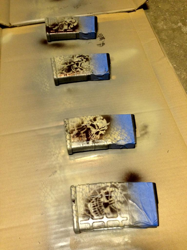

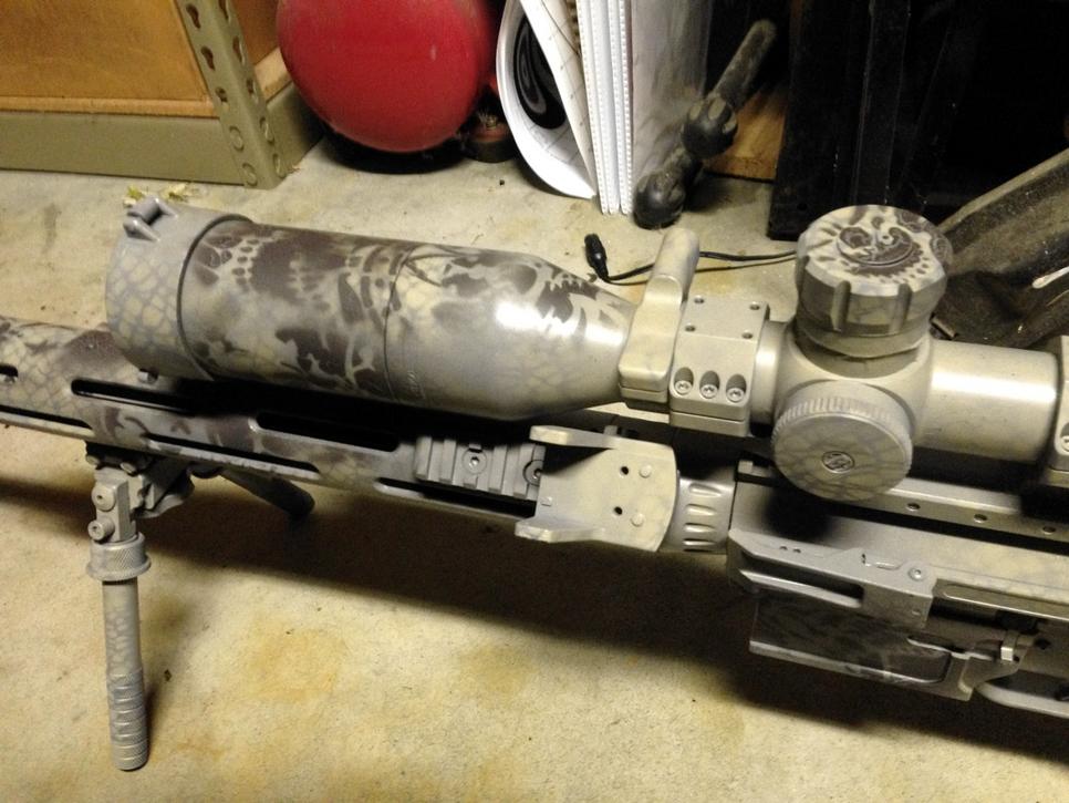

Maybe I went a little overboard, but this is what happens when you ask a couple of teenage kids how to paint a gun; my daughter had some great ideas, like finding the right netting and stencils, plus it was a reason to take dad to the craft store. My goal was to do a distinct breakup pattern for winter in Minnesota. I taped the necessary things, sprayed it with a warm grey base coat, covered it with netting and did a flat tan overspray, then added flat brown using a 8x11 airbrush stencil bought off amazon. The wife was really impressed, which was a pleasant surprise. As the environment changes (e.g. changes from brown to green) and the paint wears, I can just layer on more paint using the mesh and stencil.

Thanks. It was actually super easy.
1: wipe the rifle down with a solvent. I used an acetone thinner).
2: tape up or remove anything you don't want painted. I kept the taping really simple and just taped the markings on my optic. I also put cotton balls under my scope caps to protect against any possible over spray on the lenses.
3: spray (rattle can) the entire rifle with the base coat, what you want to show through mesh.
4: After about 30 minutes of dry time, lay the mesh over the rifle, it better if is imperfect (higher in some areas than others), then spray second color. I used tan on for this. The second layer is the predominant color.
5: Use a stencil or vegetation and spray the third accent color. This is where I got a little out of control and used an airbrush skull stencil. This was just a simple single swipe over an area on the stencil with the brown.
All in, I spent about two months worrying about 'ruining' my rifle, and then about two hours to tape and paint it. I was shocked how easy this was and will be doing this again.

How did you get around the barrel? Did you take it off?

I found one of the kids round wooden pencils, wrapped a couple of loops of masking tape around it and stuffed it into the end of the barrel. This was a trick I read / saw somewhere on the interweb and thought it made complete sense. It seemed to work and everything functioned fine today when I took the gun out and shot the 30 round SHOOTOUT.
