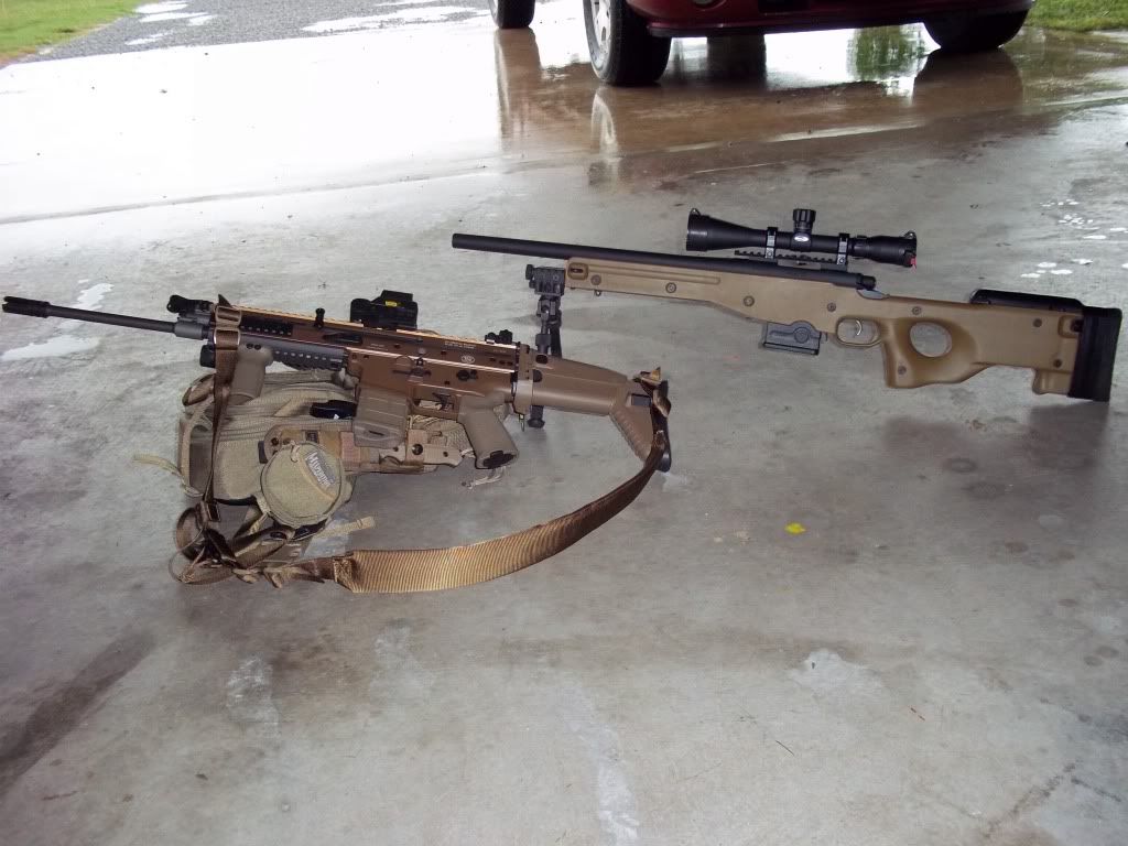

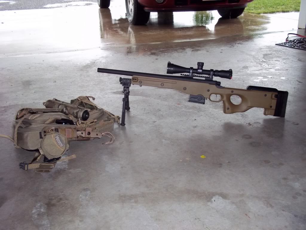

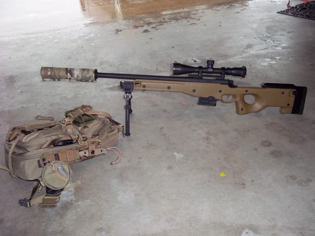

the bolt gun is my finished 300 whisper/300-221/300blkout built on a trued rem700(17fireball action) with a Douglas 1-8 twist 16.5 in barrel in a AICS 1.5 with the .223 AI mag. EGW 30MOA base and Weaver 3-10 mil/mil. The can is a AAC Cyclone.
With all the FDE figured I wold toss in the FN Scar 16 with Eotech XPS and some magpul stuff (I still need to work on the grip fit). A

He should be okay since he started with a Fireball bolt face which has the extractor in the proper position for a short case.
BTW.....SWEEEEEEET rifle!!!
Re: Finished my M700 300 whisper
My problem was with feeding in another stock since I went to the AICS and 223 mag I havent had one bit of feeding problems. Extraction is alot better in the fireball action.
