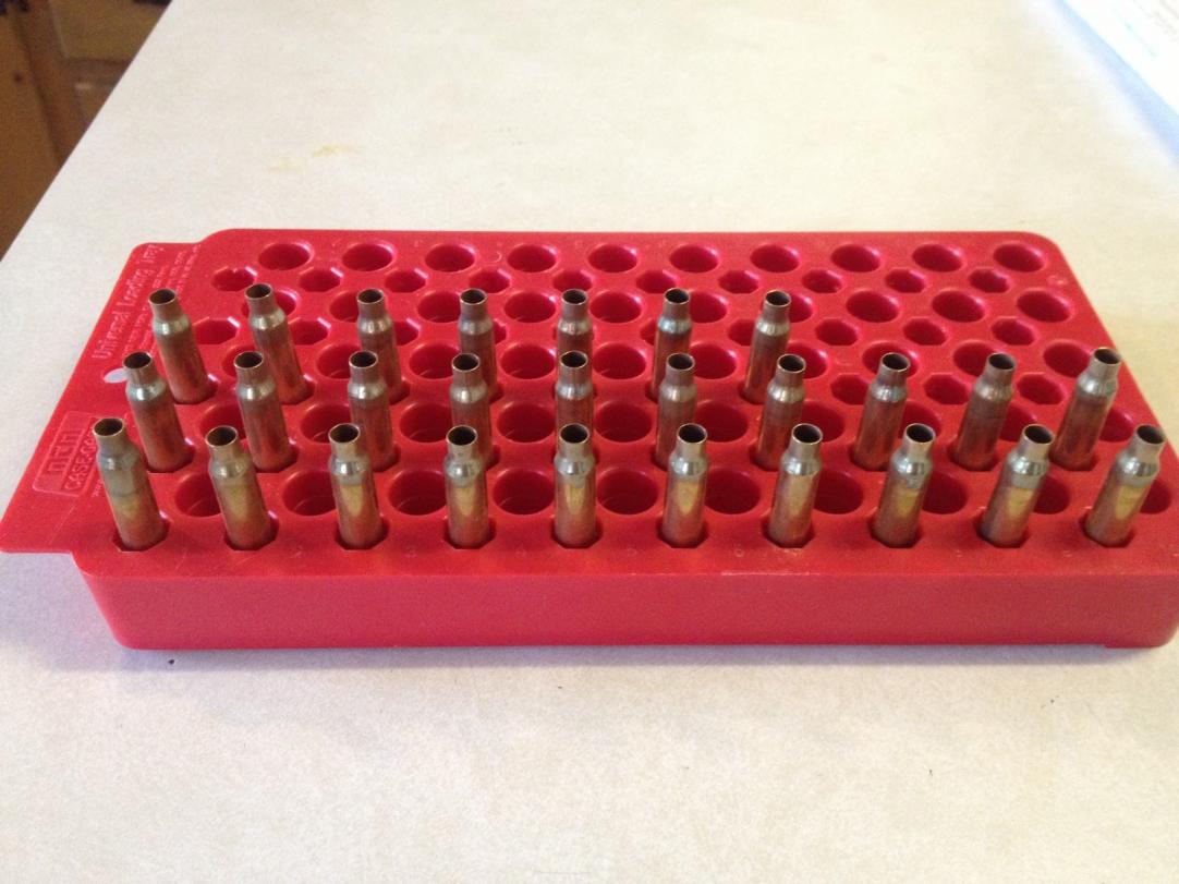

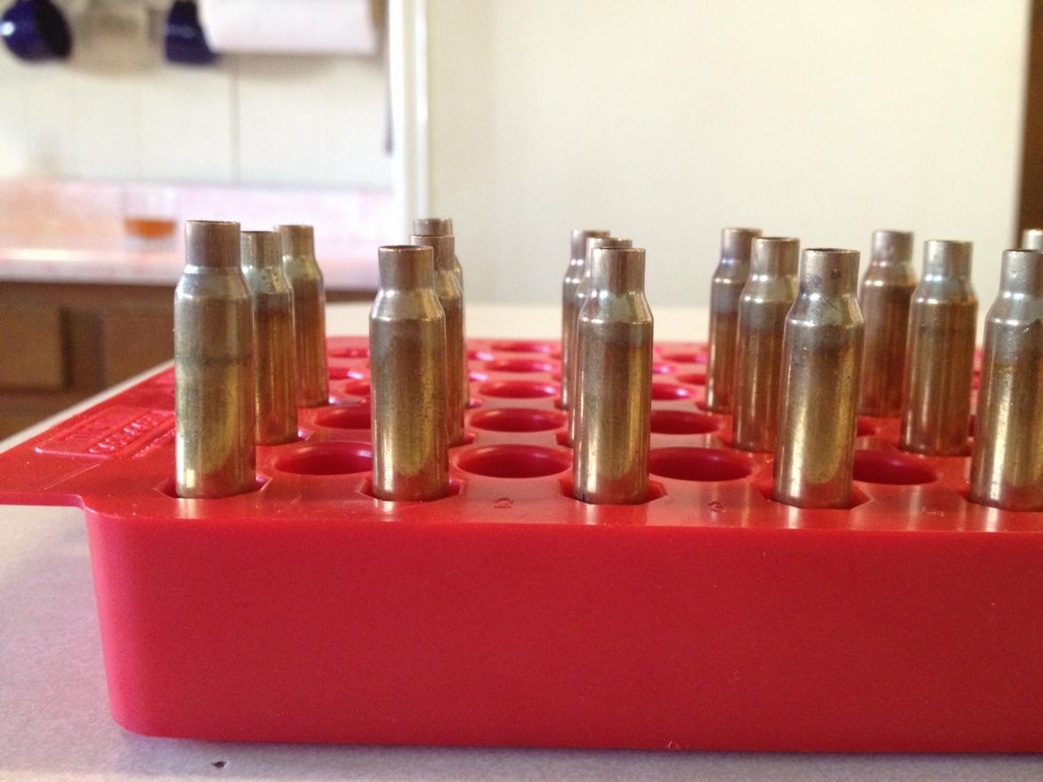

Well SVTHUH, you got me off my butt and trying annealing myself. I pulled out my stash of 5.56 cases that are Boxer(?) primed---two flash holes. I got Tempilstic 750 degree from welding supply store, chucked up a 3/8" deep well impact socket in a cordless, got out the torch, put the drill on low, a little mark of tempilstic on the outside of a 5.56 case at the neck-shoulder juncture, turned the drill on, placed slowly moving case into flame and started counting. I got to eight and the tempilstic melted, at which time I upended the socket over a little pail with about 2" water in it. I did this several times with new cases and then just started counting to eight with each case. I checked a couple randomly by applying tempilstic before heating, and 8 seconds held true. At the end, I popped them in a small cake pan in the oven on 200 degrees for 15 minutes or so, good to go.
Twenty six cases, a total of maybe six minutes torch time. I did pause a few times to check things, so I spent a half hour or so playing around all told.
I think 200 per hour is a realistic target.
Thanks for the impetus to try it. And thanks to all you others who chimed in on this thread with ideas/experience/information.
