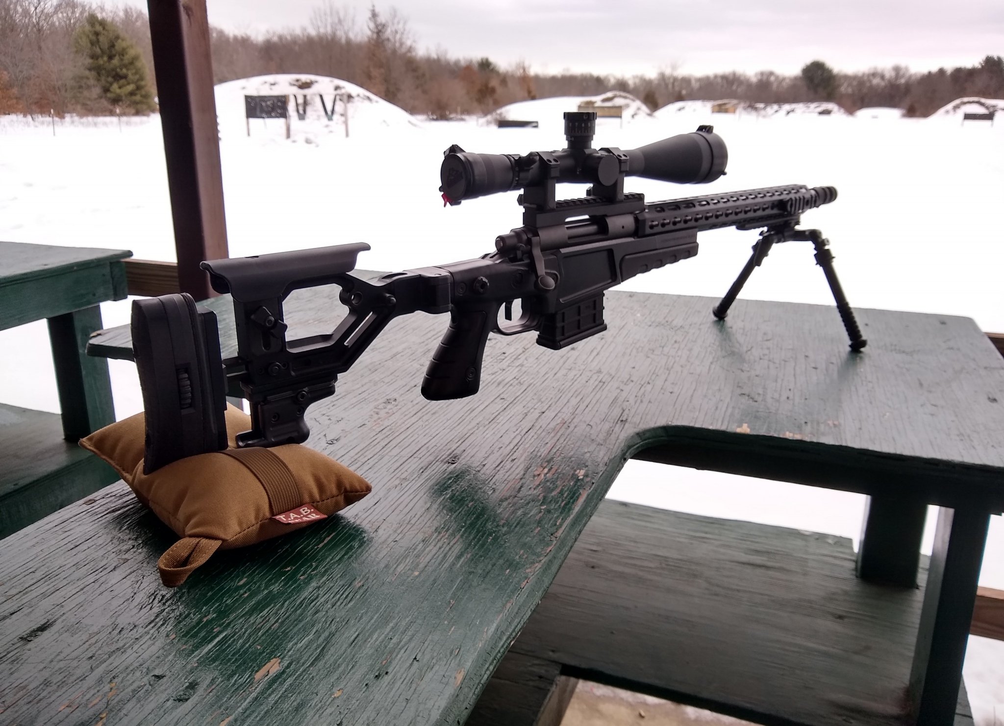

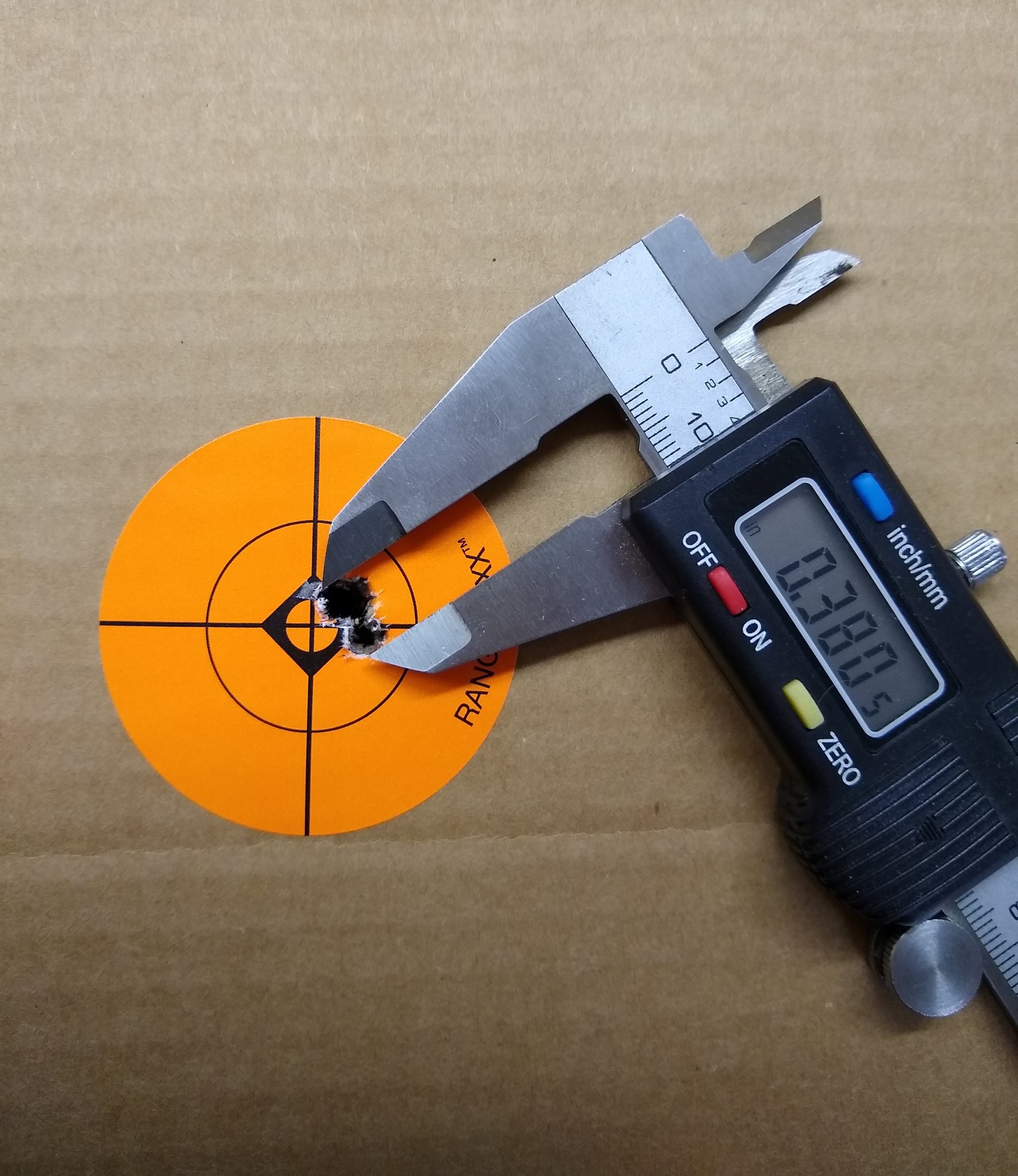

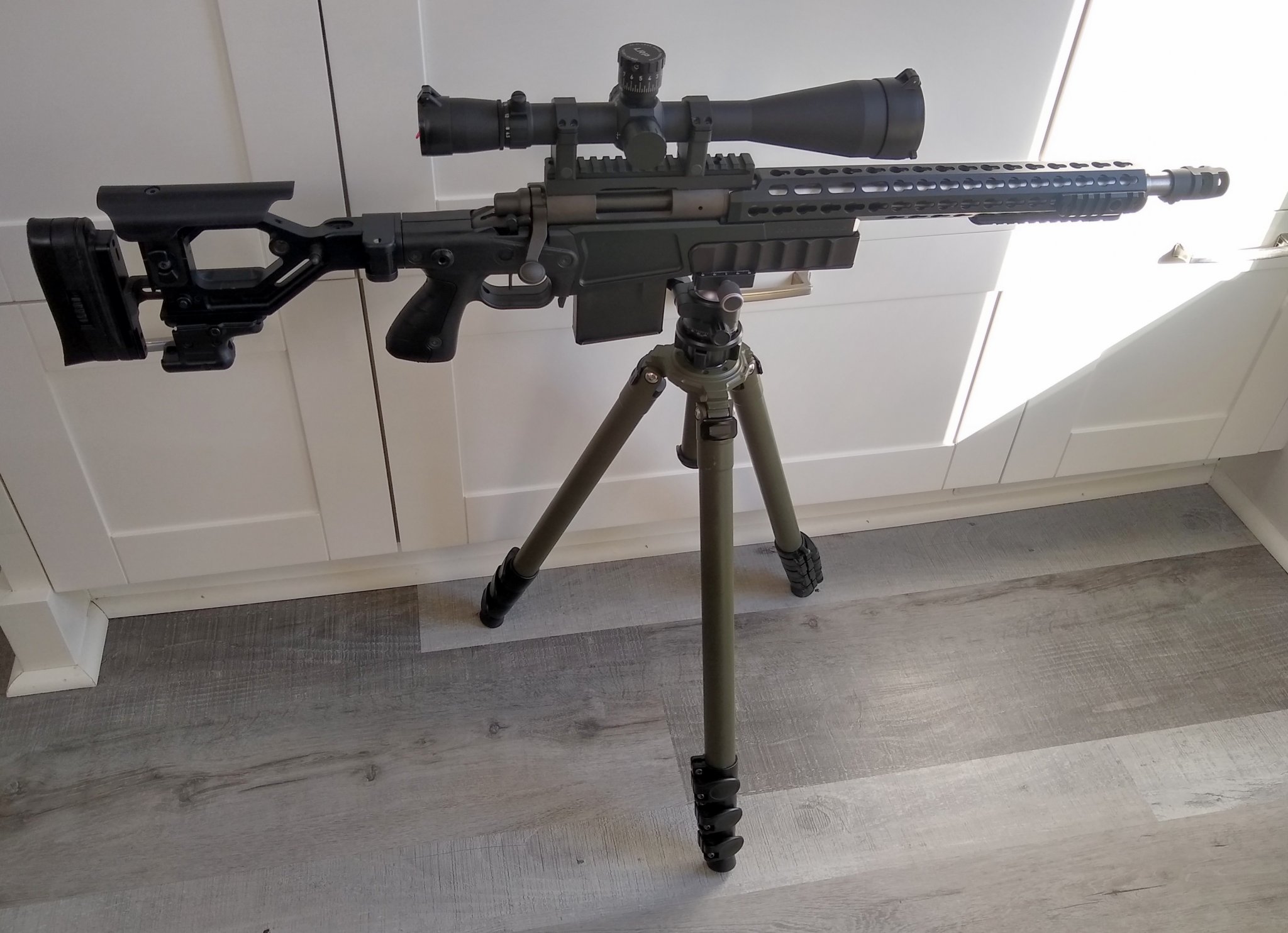

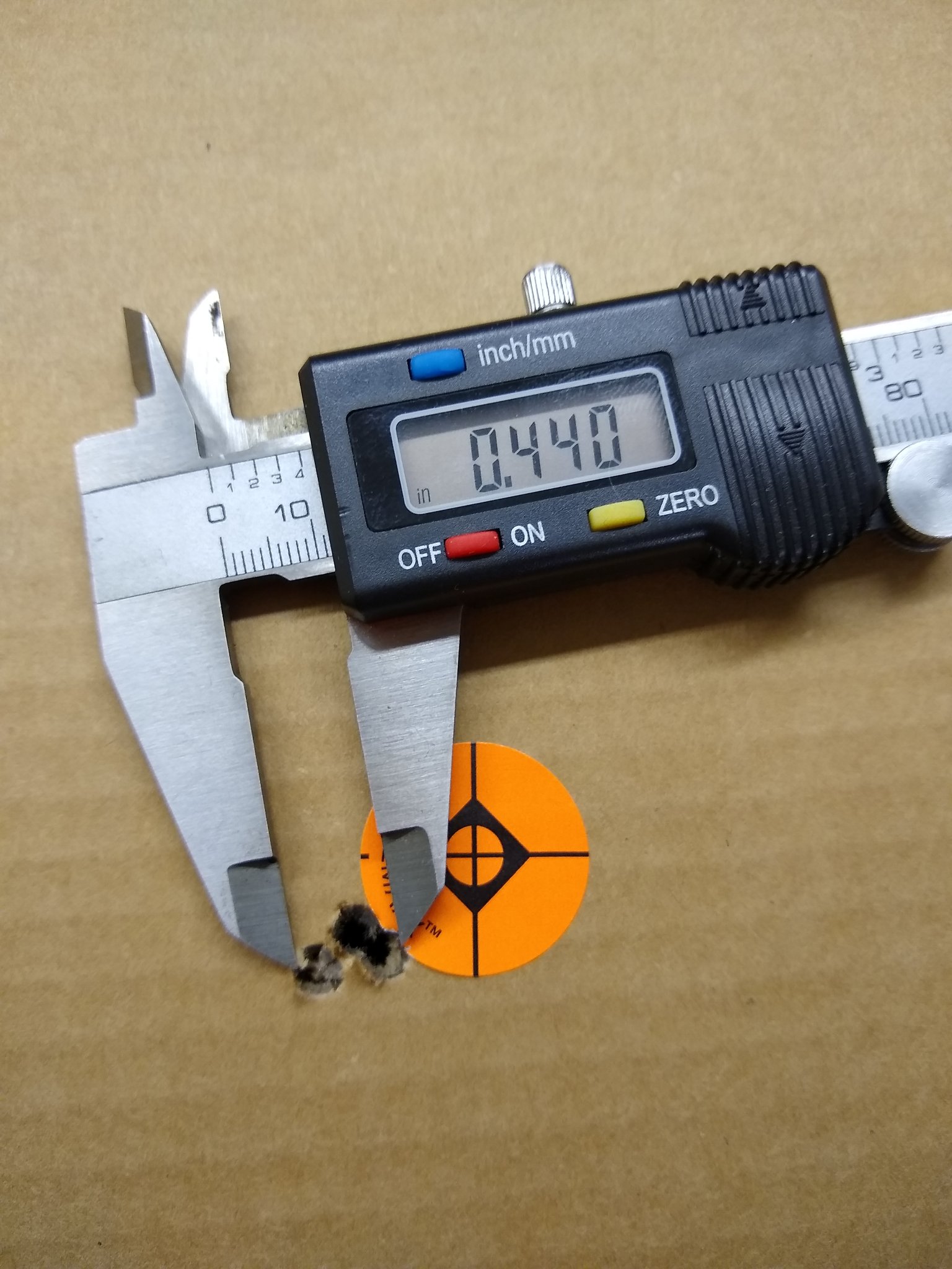

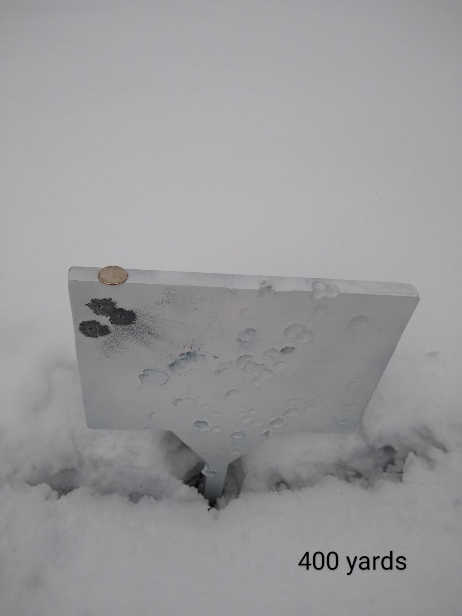

.223 bolt guns are just plain fun. Great wind trainers and economical to shoot.
I just threw a 16" together. Man it is fun to shoot with zero recoil and still have groups just larger than a quarter at 400 yards.
