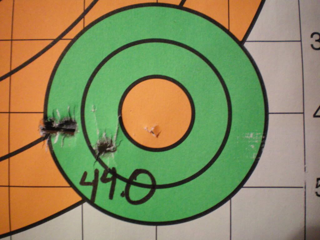

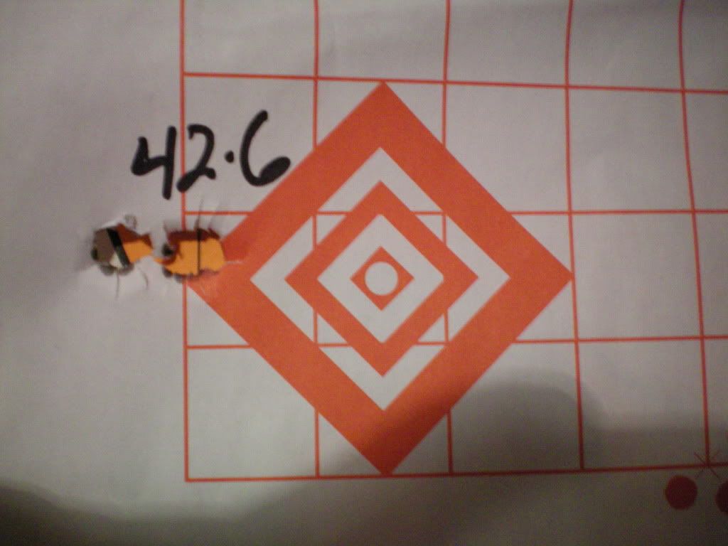

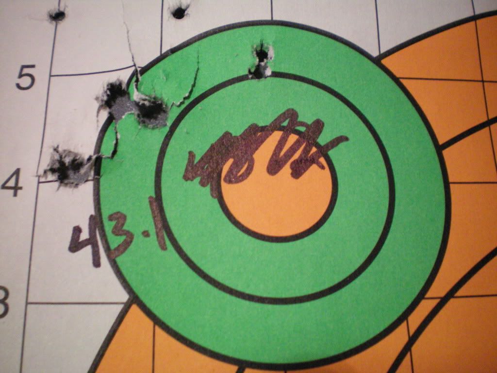

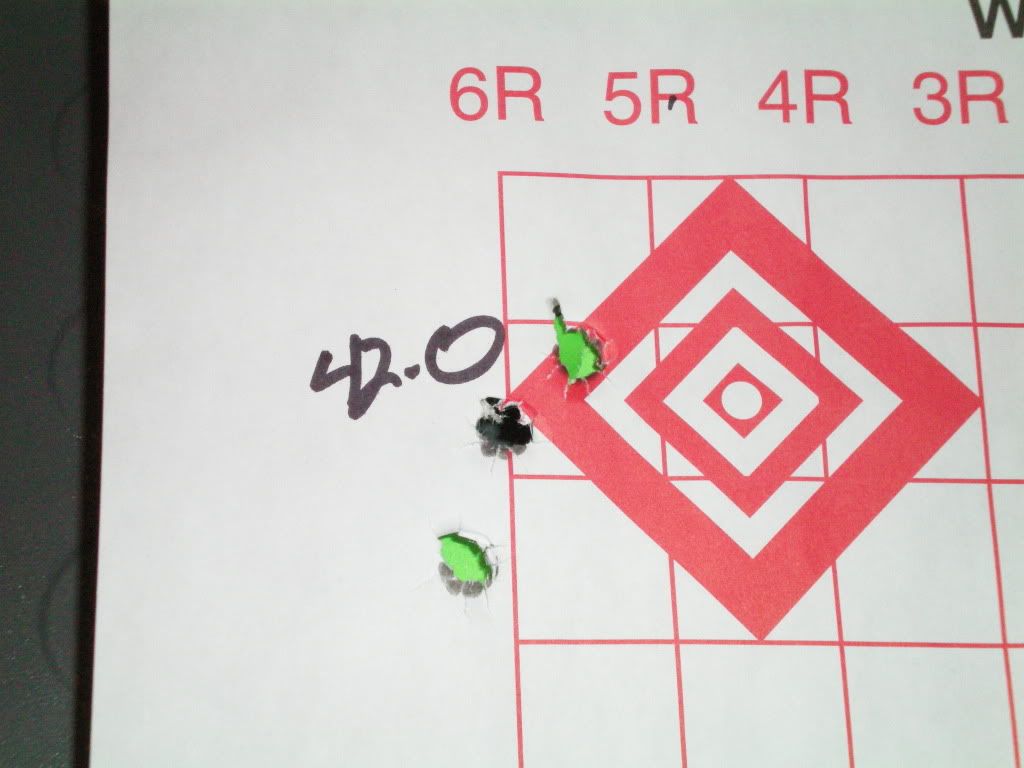

I went out a few days ago and did my first OCW test. Hoping on some opinions and suggestions.
Gun
Rem 700P
Jewell trigger
Ferrel 20 MOA base
NF 5.5-22x56 NXS
Harris bipod
Tacticals
Loads
175 SMK
Hodgdon Varget
OAL-2.800
Weather
Wind was gusting 7-15mph from 90
Snowing
Overcast
1:30PM
Groups
The area of 42.6-42.9gr looks like a sweet spot what would you suggest I do from there? Also I'm looking at an area between 2600-2650fps. Would this low of grains of Varget get me there?

ok im not a OCW guru...
first you should have same targets to aim at. if you're going to compare apples to apples
"Be sure targets are identical, and level" (dan newberry)
second it would help if you triangulated center and measurements to poa
also i like load more of a range to see where loads fall apart, on both side on node
while dan suggests 100y i think greater distances make measurements easier
how do you triangulate the center of group. mathematically not eyeballing it?
like anything there is also human error, primarily can the stick holder maintain any consistency from shot to shot?
can you post consistent groups?
to factor in above human factor i like to see multiple results from same test...... "repeatability" in other words shoot OCW a few more times then compare results. if you see a trend then its better results
also the sweet spot "NODE" is determined from 3 loads not 2.
sorry for not being so helpful. im re doing OCW and trying to be technically sound as possible. (aka anal)

I've done a bunch of the OCW type tests, and they work.
What cases and primers are you using? Varget and RL15 have nodes at similar ranges; 43-43.5 grains is a pretty common load with both powders, and I've seen lots of people happy with 44-45 grains in Lapua and Winchester cases. Looks like you're on to something there in the 42.6 grain range; the 175 grain FGMM loads have 42.5 grains of what looks and measures just like RL15. Might be the ticket where you're at. Vertical dispersion is more important than horizontal.
If it was me, and I was set with the velocity at that range, I would try from 42.4 - 42.8 in .1 grain increments at 200-300 yards to see where the vertical grouping is most stable. Then I would probably fiddle with the seating depth.

By the way, 42.6 to 42.9 looks like its producing very little vertical, which is good
... do a little more work in that area to verify, or search a little higher and faster, it is do-able in our rifles

The most common mistake people make in OCW testing is they dont shoot in a "round robin" manner. If you dont, your results are useless. Everytime you pull the trigger, you're fireing a different load. When you're done, all targets have three shots of the same load. I realize I'm probably telling you something you already know but just wanted to make sure because it is a common mistake. Good luck.
okie
Re: First OCW test Rem 700P
Yes I shot them in round robin. Also 6" of barrel would get me easily 100fps. I'm guessing then that the 44gr area would get me closer to 2600fps.
