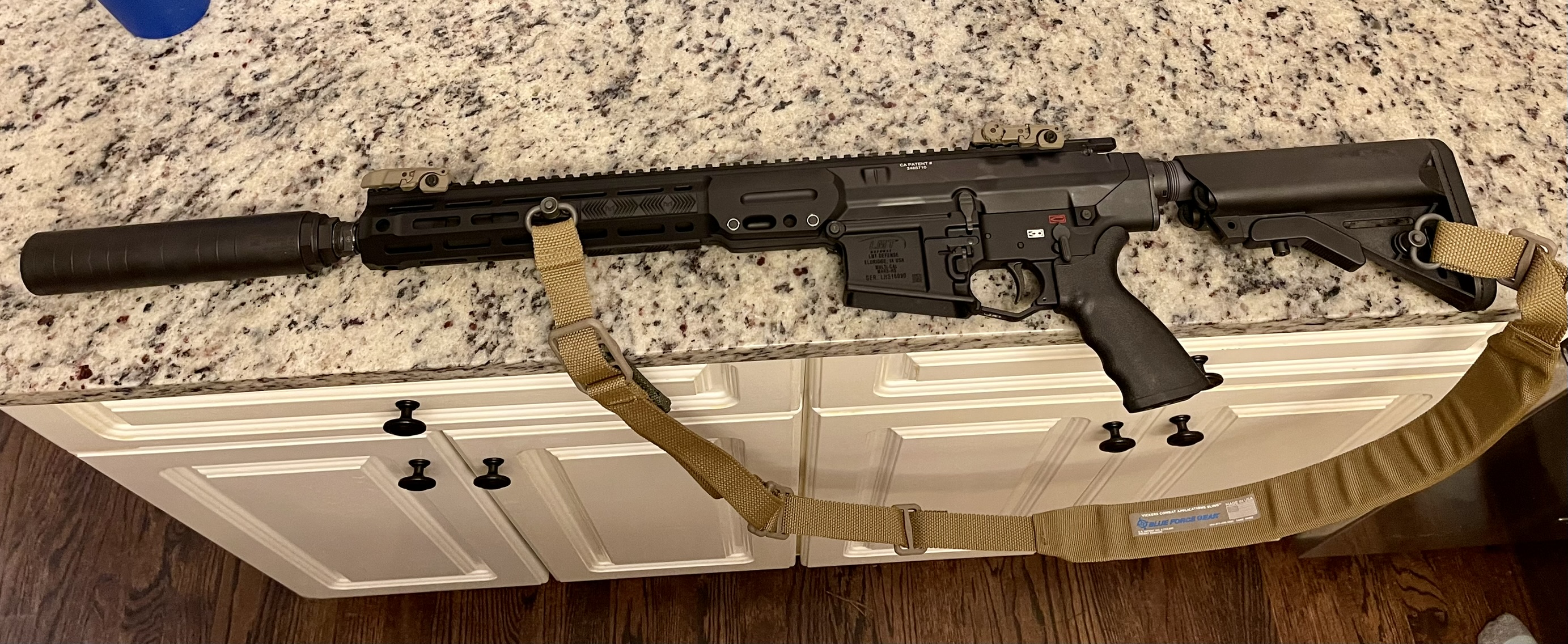

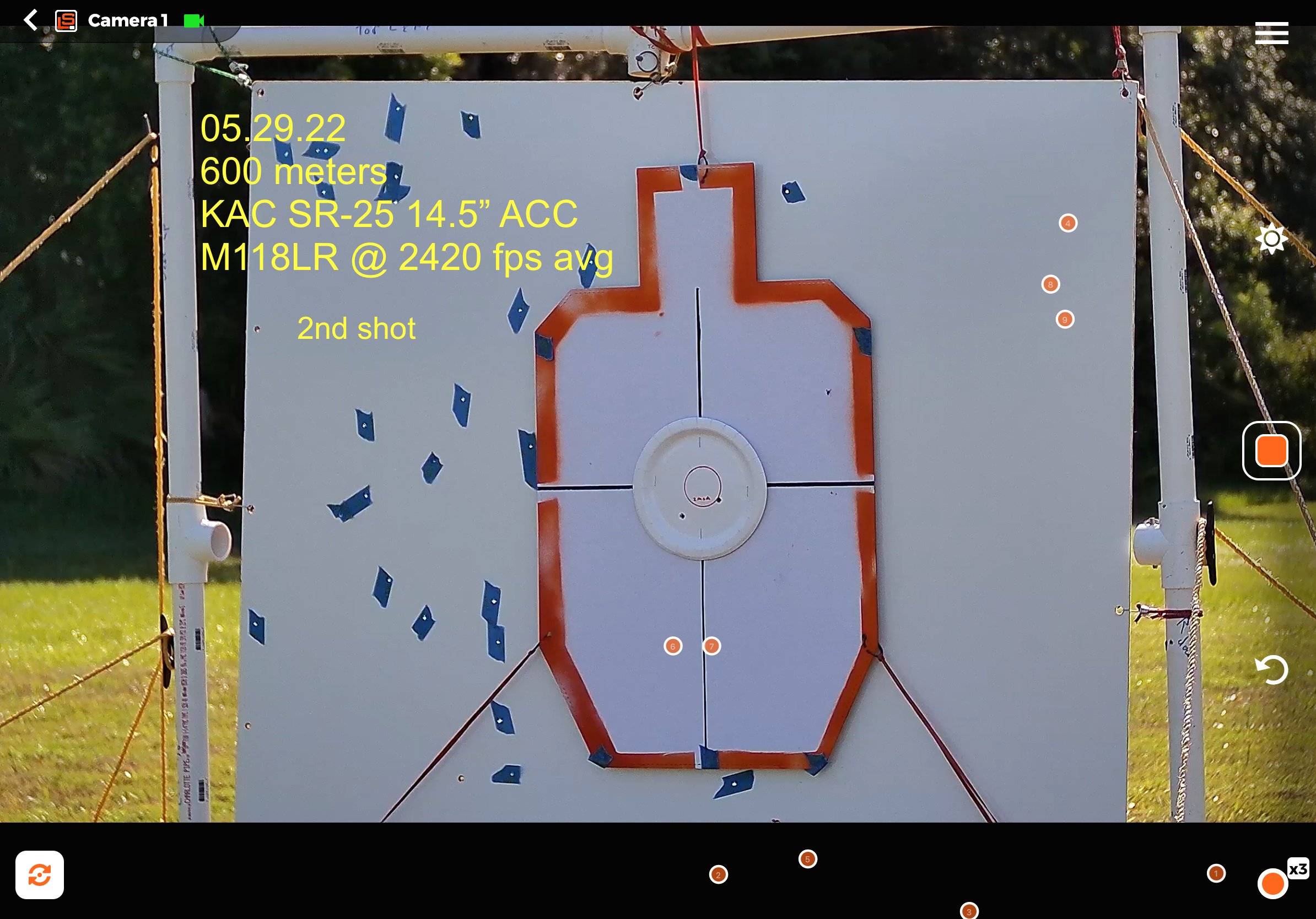

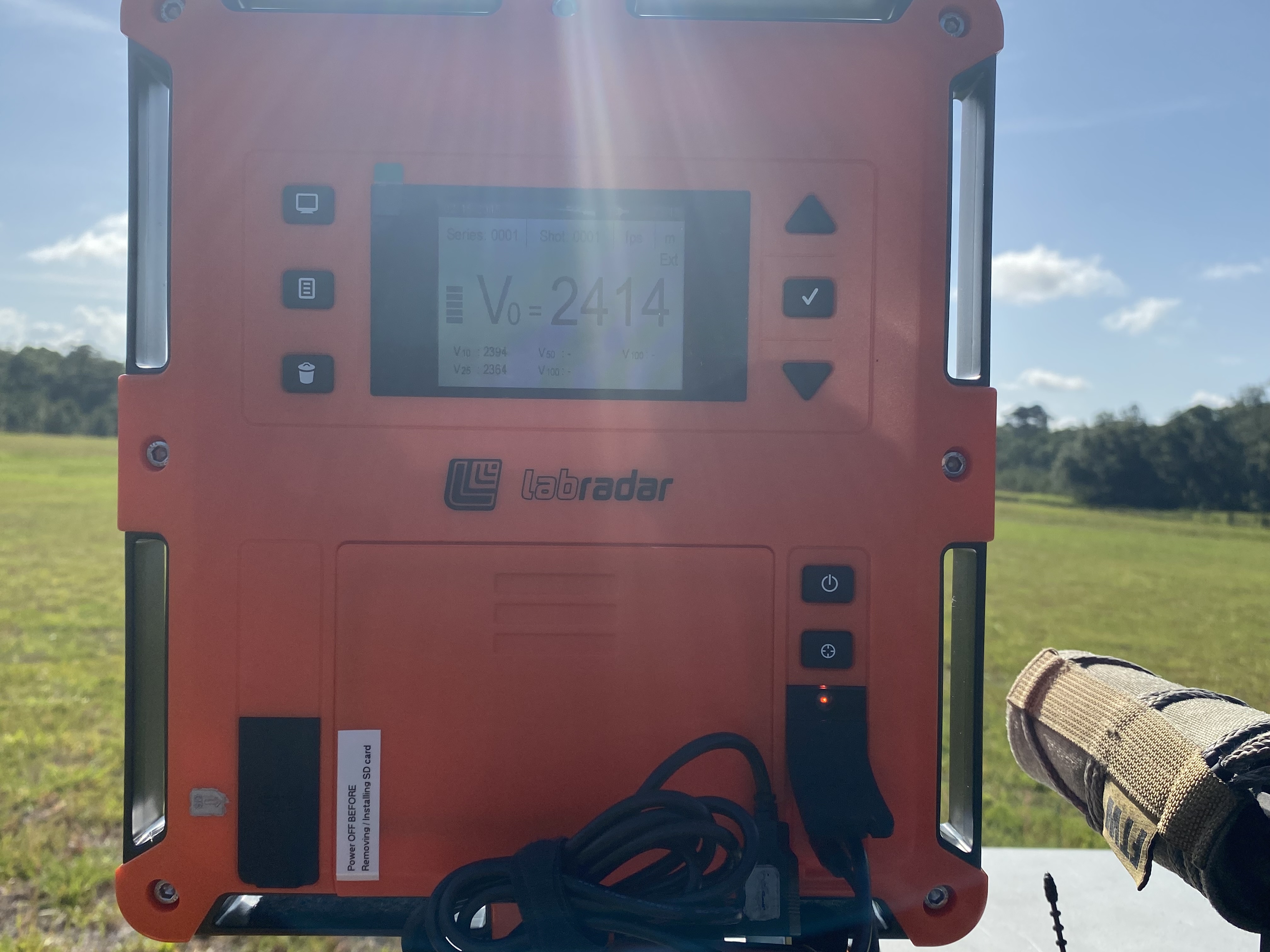

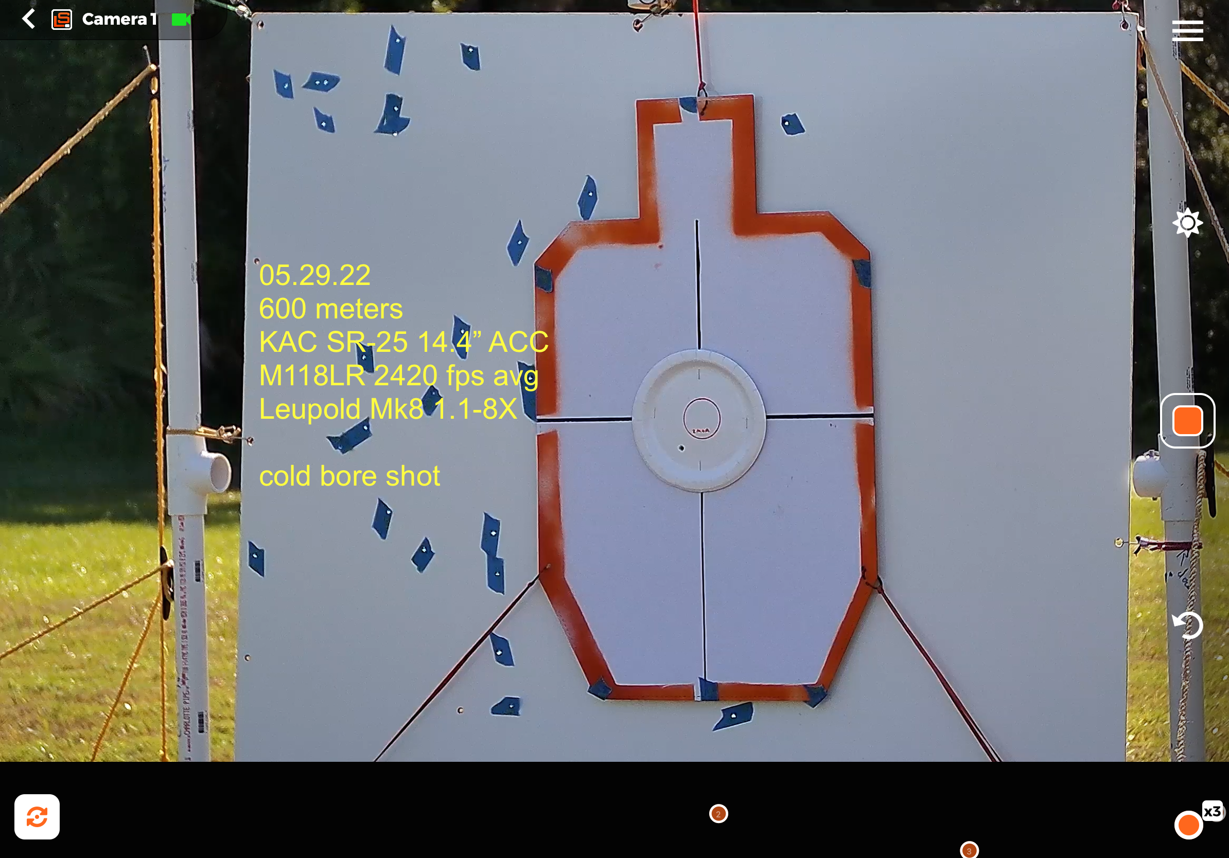

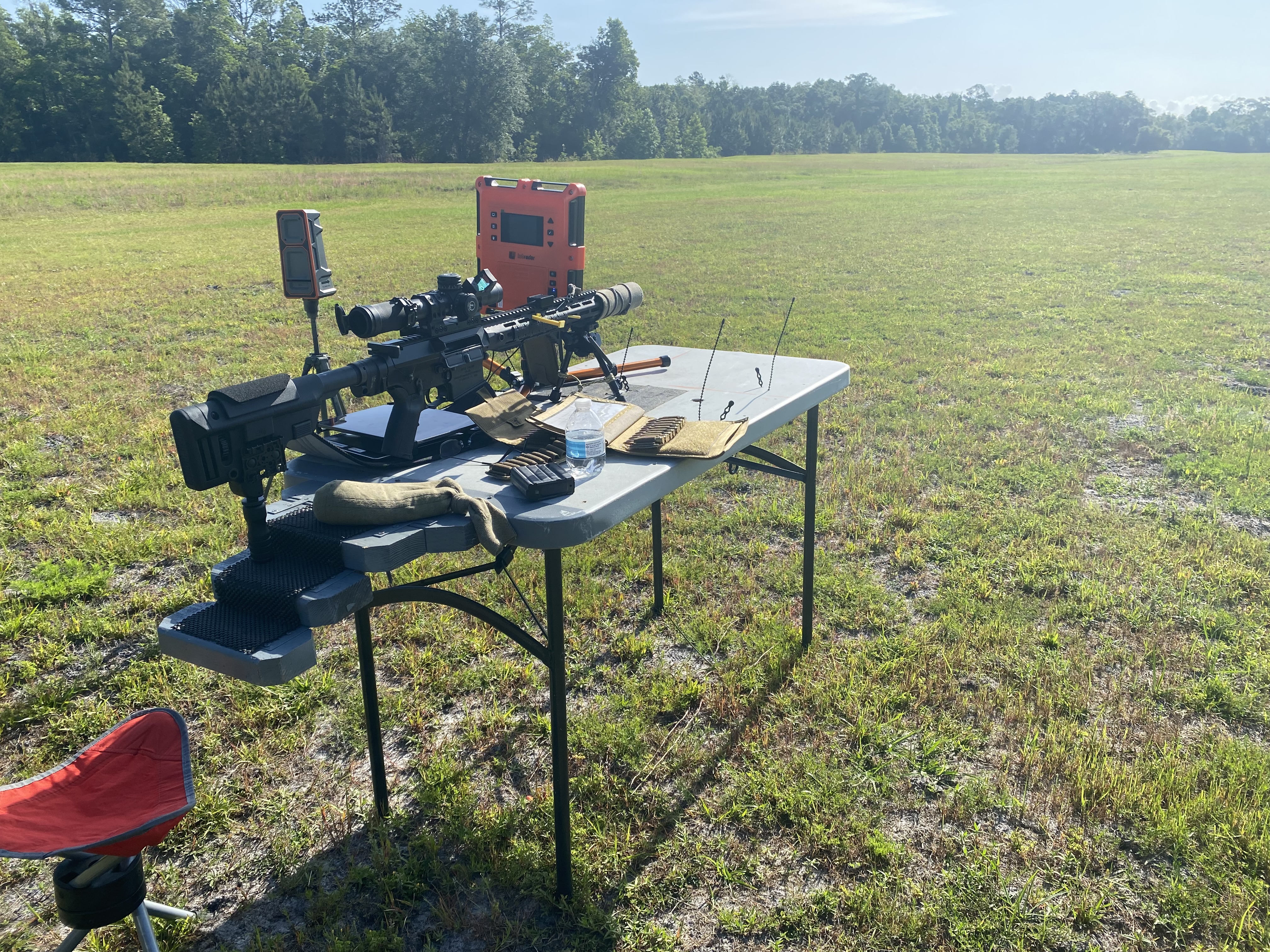

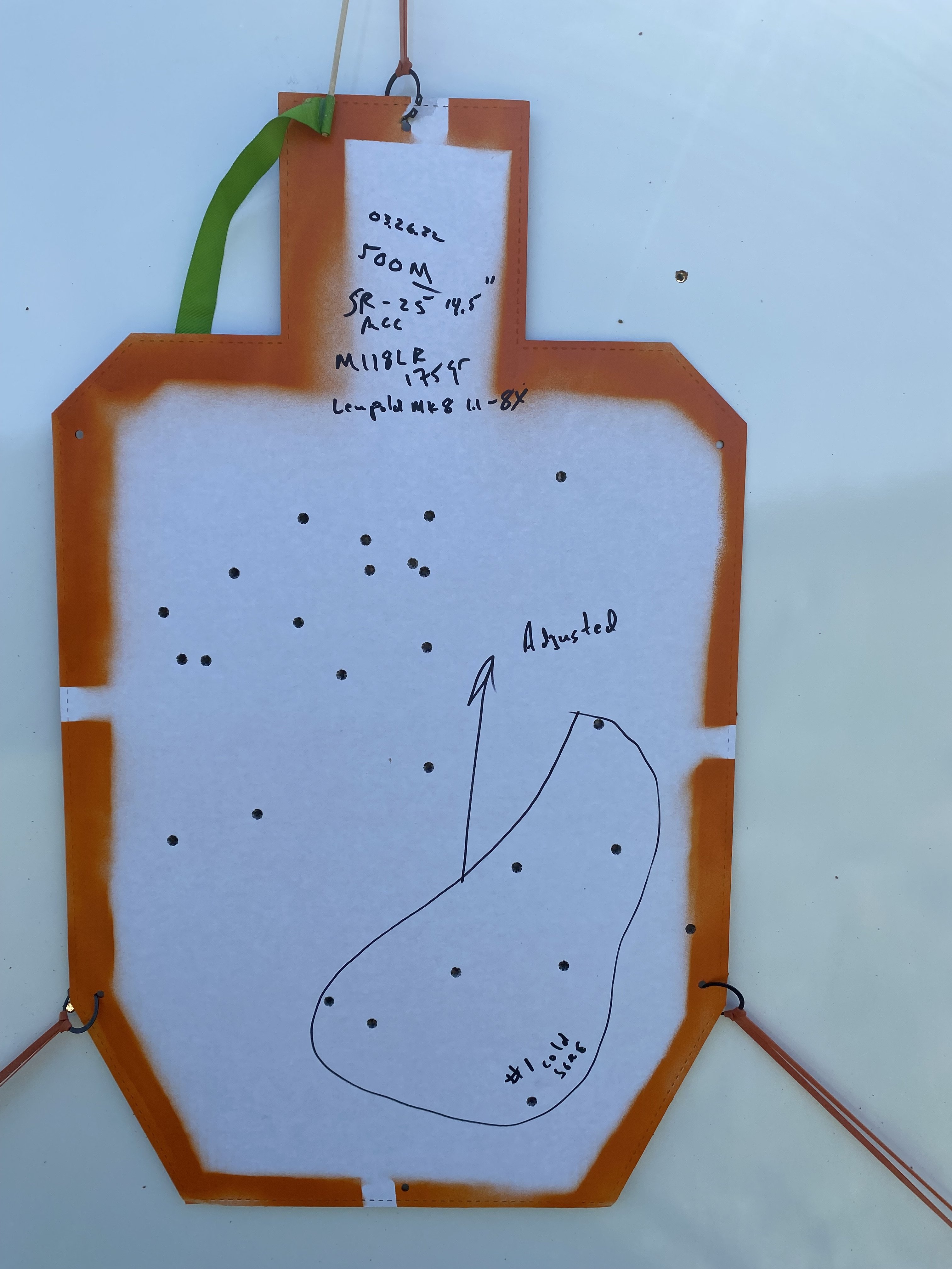

I set up this KAC SR25 14.5" ACC with the old school Leupold Mk4 1.1-8X CQBSS scope; does well out to 600 meters; offset RMR zero @ 50 meters. I find shooting beyond 600 meters with 8X scope difficult, especially with an heat mirage.
IMG_0182KAC SR-25 WITH SUPPRESSOR BLACK SCOPE & SLING RMR MOUNTED POOLSIDE 07.30.21 ANNOTATED ...jpg
IMG_3224CRACKER SWAMP KAC SR-25 7TH Session 600 Meters First Two Shots 05.29.22 copy 3.png
IMG_3225CRACKER SWAMP KAC SR-25 7TH Session 600 Meters First Two Shots 05.29.22 copy 2.png
