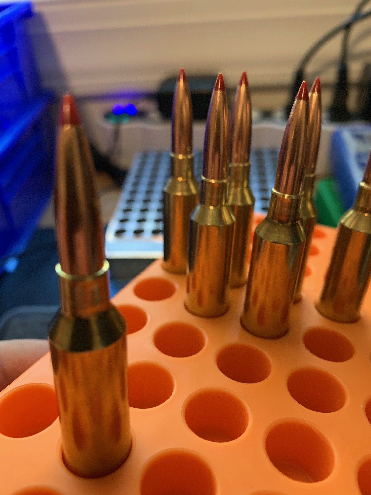

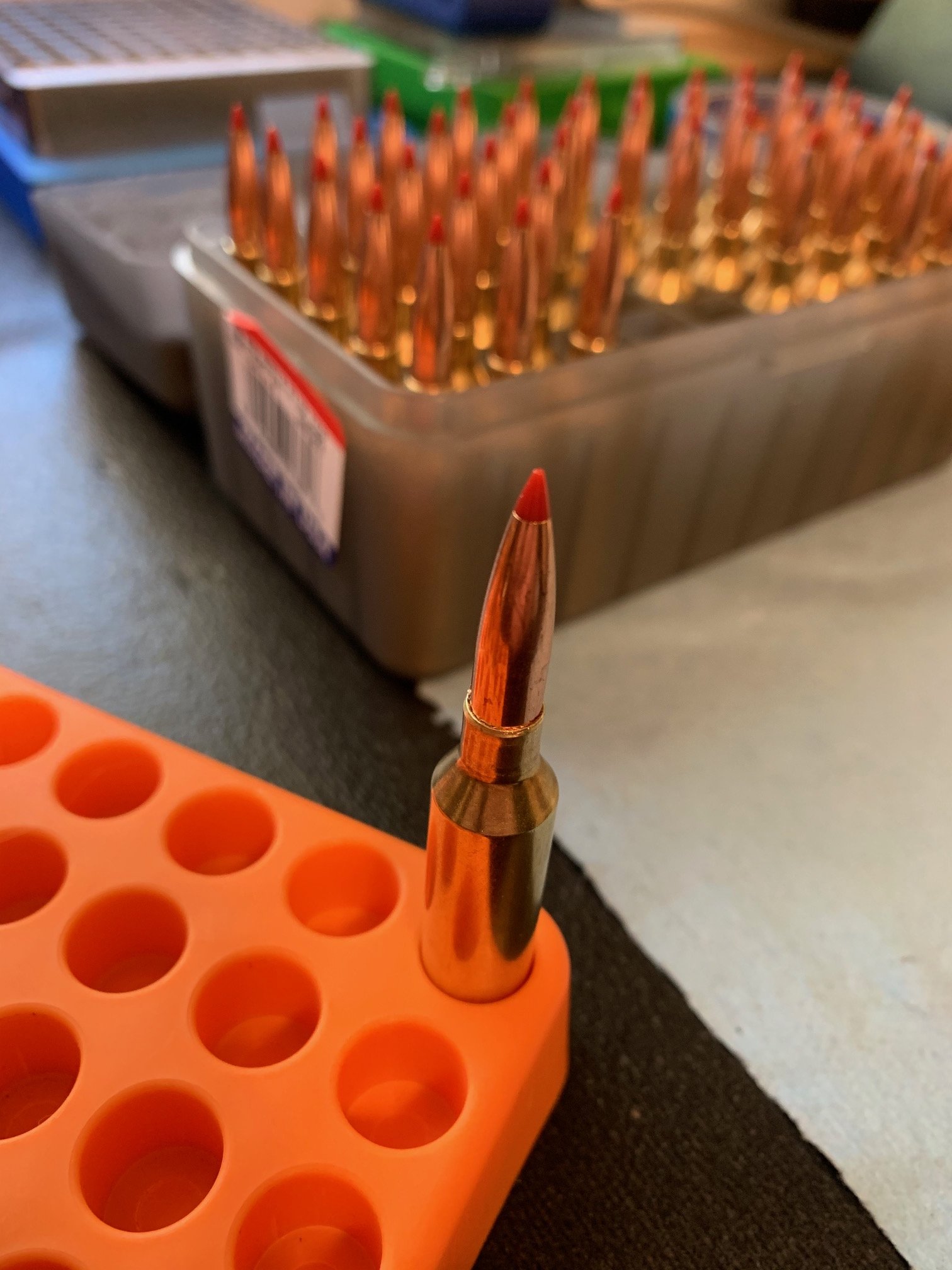

Can we see pictures of the offending reloads?

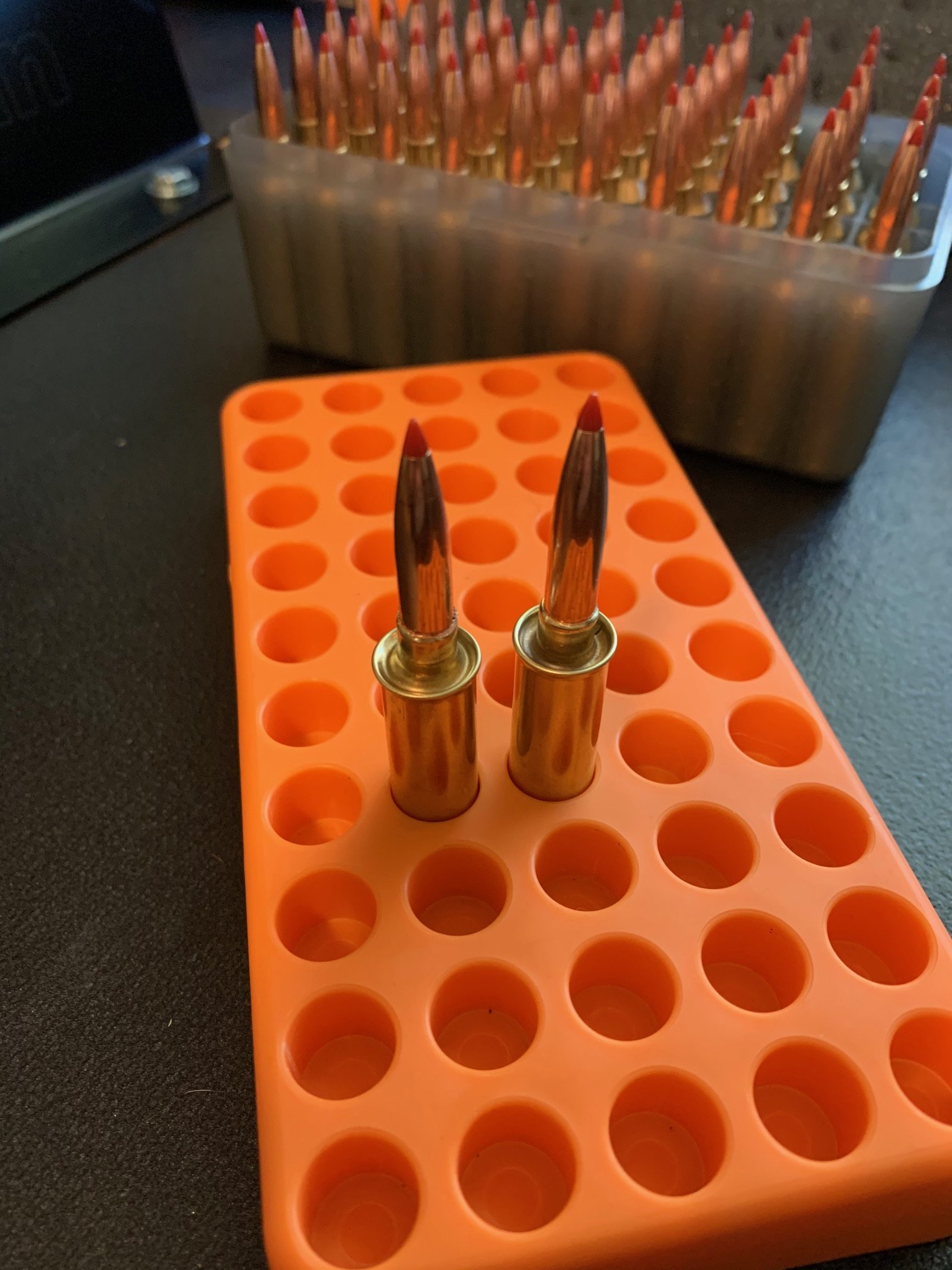

Most look semi-normal... 2 that totally buckled:
Nope, just counted to "7 Mississippi"... I know, scientific AF.
View attachment 7447682View attachment 7447683View attachment 7447684
By a simple process of elimination your annealing was the only real change in your otherwise successful reloading.
If your brass completely collapsed like that trying to seat a bullet it is way to soft and has been over annealed, take one of those two rounds that collapsed and pull the bullet out and I bet you can squeeze the mouth out of shape with just your fingers.

This almost looks like its stripping the jacket off. It appears rough where the bullet meets case mouth. After you trimmed them, did you look at the chamfer? Did it look clean and smooth?
I've seen this before - you forced it. So either too much neck tension, it wasn't centered up properly, or the brass is too soft.

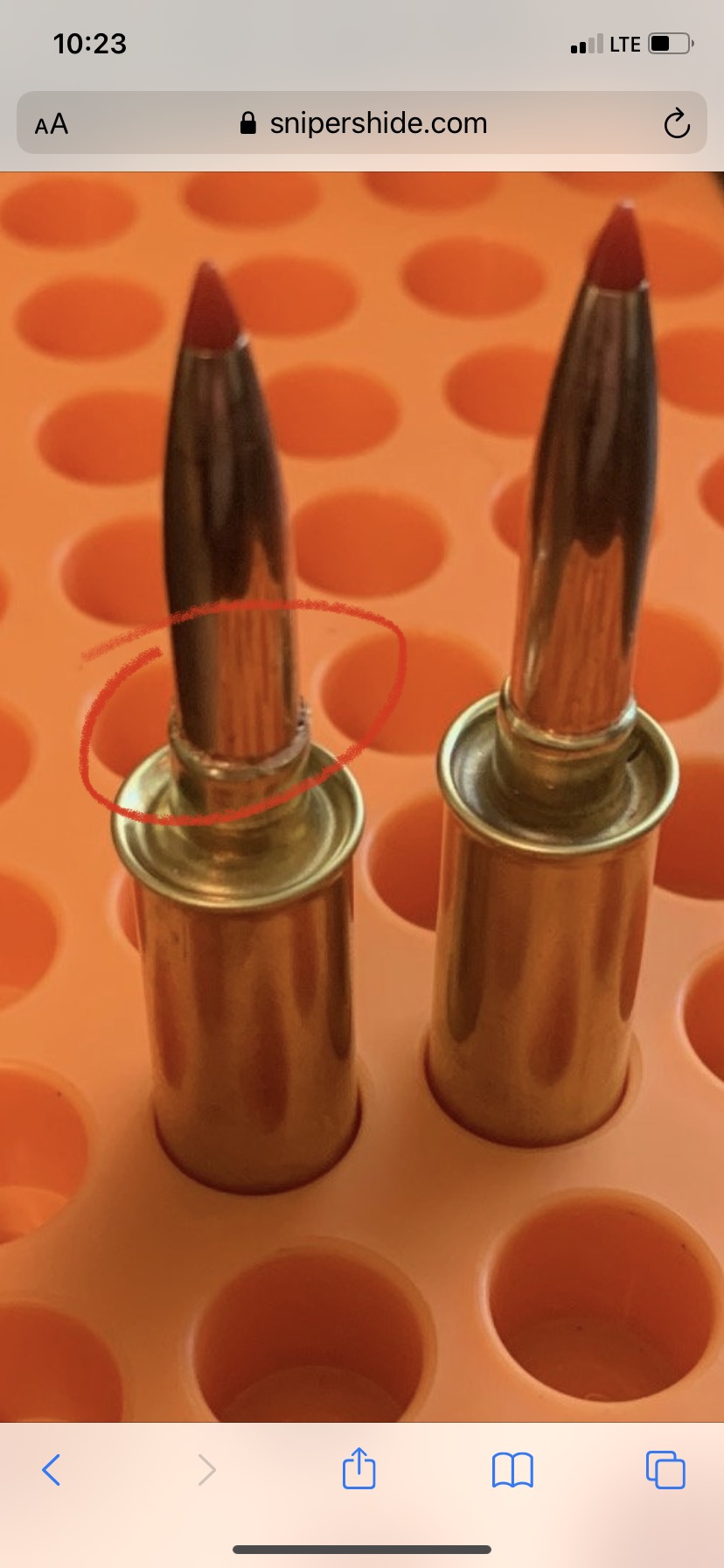

I'm seeing a chamfer on the outside rather than on in inside. Is that right? If so, then it's not surprise to me that you're squishing necks like that, particularly if the necks are too tight (having a lot of neck tension). and/or the necks are over annealed.
Chamfer should be on the inside and just a little deburring on the outside.

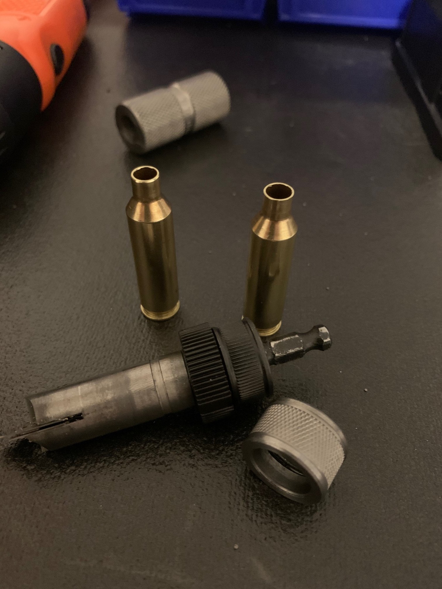

So after fucking around with the Lee Deluxe Power Quick Trim and the specific Quick Trim Die (6mm Creedmoor in this/my case) for another hour, looking at all kinds of possibilities, I finally think I figured out why it fucked up my brass:
The cutting bit has a piece on the tip that has to be pushed/compressed up/in to the body of the bit in order for the trimming /cutting head to engage the case and cut (the part that gets compressed handles the deburr/chamfer as the case engages/disengages the cutter, well that's how it's supposed to go anyway)...
There is a spacer/collar that slides on the bit assembly that is supposed to act like a "hard-stop" to prevent one from trimming passed SAAMI minimum length, the instructions say to use this spacer with cartridges longer than 1.25" (so I used the spacer).
SAAMI max for my 6mm Creedmoor case is 1.920" and that's about where my brass was at before I started, SAAMI minimum is 1.900" (so that's where I wanted to end up in order to not have to trim again until after 3-4 more loadings/firings).
Well, turns out the "hard-stop" when using the spacer isn't at 1.900", it's at more like 1.915" or so, BUT, if you keep the drill running thinking you're trimming further and just have a little more trimming to do (maybe add a little elbow grease to hurry it up), you're actually not doing shit because the cutter isn't really engaged anymore, but the debar/chamfer blade IS. So it just continues to "tread water" while the deburr/chamfer gets larger and eventually eats away at the case until you show 1.900". A totally fucked 1.900".
When I was dicking around, I removed the spacer/collar and found I could get the cutter to actually engage and take the case down to 1.88" easily before it hard-stopped at the case-neck hole in the die body.
Turns out if I had just stopped/gave up at 1.915ish" or wherever the spacer stopped/bottomed out, the cases would've probably have come out fine, but I didn't know, and the instructions said it should stop at 1.900", so I tried to roll with it and wrecked 100 pieces of brass finding out.

Notice the case on the left where I "stood on it" for a bit (not nearly as long as I had with the other cases I did earlier, but still) without the cutting head engaged (but continuing to debar/chamfer), and on the right, how it looks when I stopped even though I wasn't at the shorter length I was after. Also shows the bit and the spacer/collar:

Well, I feel there's some good news . . . in that that brass seems to be salvageable. Since the cartridge length increases after firing and resizing, I'd think you could get your brass to where you want it . . . eventually.
To start, I'd take this brass and just do another chamfering with a tool that just does chamfering so there's not other changes in the case and that seating shouldn't be such an issue. I'd even reuse the messed up bullets for cold bore shots or some siting or even running them through a chrono to record some load data.

I'm expanding the neck to -004 before trimming and having better luck with the trimmer.
I then run it to -.002 in a mandrell.
That being said I'm not happy with thier trimmer.
The only Lee product I have not loved it's worthless on short brass that still needs debur and champher.
I'm leaning toward a shoulder based trimmer because my Forster 3 way has the same issue on short cases.

Look at the Trim-it 2. Its like the WFT only has a 3-way cutter and micrometer adjustment.
+1 on the Trim-It 2
The cutting head is like the Giraud Tri-Way Trimer and like the Tri-Way does a great job fast (once you've got it set up, which is always the key with tools like this). And, unlike the Tri-Way, the Trim-it 2 has interchangeable dies for different calibers.
+1 on the Trim-It 2
Honestly, looks a lot like the same idea as the Lee thingy, just done and built correctly (instead of just trying to hit a price-point).

I trimmed thousands of cases with the Lee set up when I first started loading. It works fine and actually leaves a great edge when used correctly. I don’t think that’s your problem.
