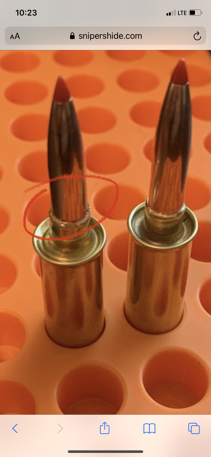

FL bushing sizing die & trimming shit-show...
Something looks really weird here. What seater are you using? Is it crimping while seating? View attachment 7448264
Yeah, I'm crimping them. I'm using a 9mm Factory Crimp Die :rolleyes:😜

From looking at the pictures it looks like you possibly have 2 problems.
1. You may have over annealed your cases. Try some of the above advice before you try annealing again.
2. It looks like you didn't chamfer the inside of the case mouth after trimming.

So, still relatively new to bolt-guns and long-range stuff, but have been getting great results thus far... I'm shooting 6mm Creedmoor and had bought 100rds of Hornady Match ammo to start me off and give me my first batch of brass to learn to reload for the rifle with... got a single-stage setup for the rifle stuff.
Everything had been going great, and my loads were turning out pretty sick, yielding around .3" 100yrd groups, under an inch at 300, so I seem to have figured out part of the puzzle anyways... I've never used the expander-ball in my sizing die even once, bushing only and my groups have been telling me I've been doing it right. But, after years of shooting pistols in USPSA/IDPA and loading thousands of pistol rounds on a Dillon I never had to trim shit, so no experience there.
Anyways, my brass had 4 firings on it and was right about at SAAMI max, so it was time for me to figure out how to anneal and trim: the annealing part went fine (blowtorch/power-drill method), trimming not so much lol.
I bought a Lee Deluxe Power Quick Trim setup, quick trim die & trim bit using a drill, thought it would be simpler because it deburrs/chamfers at the same time as it trims.
Steps were: decap, anneal, wet tumble, lube & FL size bushing die (no expander ball), dry tumble (remove lube), trim, prime, powder, seat bullets.
Seating bullets was a total shit-show, over half of the rounds are total shit (obviously not concentric), a couple fubar squashed, none of them really fit the case gauge like as usual for me... pulled the firing pin out of my bolt just to see if they'd even chamber in my gun, and except for the ones that are totally fucked, they do, just with a tight bolt-close.
Guessing the trimming was fucked up because I didn't use an expander ball or an expander mandrel die... is that the answer, have to expand the necks before trimming?
Or, does the Quick Trim just suck ass and I need to buy a better trimming setup?

Over annealed your brass is too soft plus if you expand your photo I see shavings around the seated bullet which indicate your necks are way too tight or not chamfered properly

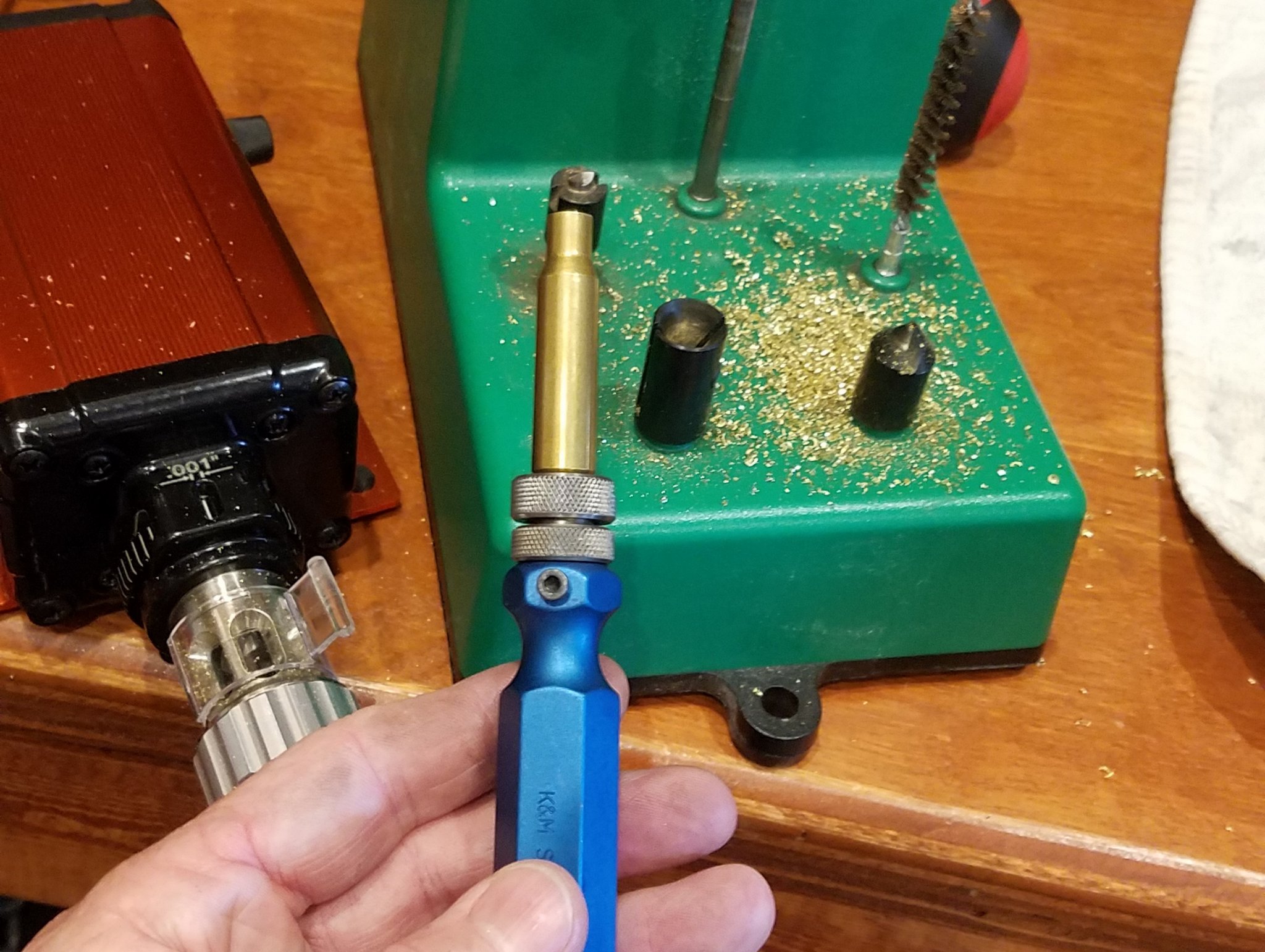

Both tools are now mounted to a small board at the angle I like and it makes the job I hate most, very easy.
I ordered the Frankford Arsenal Universal Precision Case Trimmer (basically a WFT with all the thingys included to do whatever cartridges), I guess I’ll see how it goes... Looks pretty fool-proof and with just setting the cutter to touch the mouth of a case to be trimmed, looks like I can set an easy “zero” and then use the butt-end of some calipers to find out where to park it to be right where I want to be.
I also spent the whopping $20 to buy an actual hand deburr/chamfer tool (literally hundreds to thousands into this stuff and I’ve still been using an old Benchmade up until this point lol). While I am a huge fan of speed and thought about going with one of the many options of motorized or drill-mounted deburr/chamfer tools, I decided the chance of me overdoing it with most of those and putting more of a knifes-edge on case mouths rather than getting a good feel for just hitting them lightly might actually take longer than just spinning a case around with my fingers a couple times, because honestly it shouldn’t take much if the trim cut is clean... guess I’ll see...
First, I have never replied to a thread until now. So there is a combination of stuff going on for you here. Yes you over annealed, but I'm guessing you used the same bushing when you sized. Your .002 press fit now became .006, then it's possible the trimmer pilot galled the neck I.D. add to that a lack of I.D. chamfer and you get exactly what happened. So again I'm guessing but find a way to measure the neck I.D. after sizing. Pins or ball gauge Or use an expander. I have been a machinist for 30yrs it's not always that easy to see what's coming when we change one small detail.
I'm in agreement on the over annealing for one, and for two the chamfer is backwards on the rounds shown above. The outside diameter should have the burr removed and a very slight almost unnoticeable bevel, while the taper cut should be on the inside.
This document is upside down, but you can see the correct end state result of a trimmed and deburred neck here. FYI the Gracey trimmer came with adjustable tool steel blades; they were not easy to adjust. Someone came out with a one piece carbide cutter with the correct angles for trimming chamfering and deburring. I've used both setups with success.
I'm not that familiar with the Lee product, but at the end of the day this is the desired result.
Lastly, there is the issue of whether or not you are using too tight of a neck bushing. Note that in one piece full sizing dies, you have to decide what you want to touch the neck last to determine your final neck OD. You need to use one OR the other - the button OR the bushing - not BOTH - though you can use both, but understand that the final size will be based on the OD of the button, not the ID of the bushing. Using both is a valid method assuming you are good with the ID created by the button, and in this case the bushing controls how much you size the neck down before pulling the button back through.

Well got shit sorted guys... thanks to the proliferation of free one-day shipping I was able to try my new Frankford Arsenal Universal Precision Case trimmer, which is more or less their WFT2 homage/rip-off, but with a couple interesting tricks that make it interesting (besides that it comes with everything to trim most any/all calibers from the jump): it has it's collet-guide-thingy which I thought looked dumb but turns out is actually awesome, and it's super fast/easy to setup and dial in.
First the collet-guide-thingy: IMO this is actually the thing that probably most sets the Frankford jobber apart and brings it into it's own vs the WFT/WFT2 and maybe some of the others out there: the collet-guide thingys make it almost impossible for one to trim cases lopsided or off-centre because it supports more than half of the case, holding it plumb/straight to the cutter for you (instead of just using the shoulder like the WFT). They got this right IMO, there's almost no way to not trim the case-mouths straight and fuck them up since the washer that provides the shoulder-index is recessed inside at the end of the "tunnel" made by the collet thingy.
Second, setup takes like 2-3 minutes if you go slow... I did it like this: assemble the thing with the correct shoulder washer and collet thing so there's no real slop in the case, adjust the cutter until it just barely contacts the case (no drill yet), mic the length of the ass-end of the case sticking out of the thing (remember this number), mic the un-trimmed case for length, decide how much you need to take off to get where you want to be and add that amount to the first measurement you took, adjust the thing so it pushes the ass-end of the case out of the front to reach that measured amount, done. Trim away.
I trimmed 100 cases in 10 minutes, no real variance beyond .00005"ish or the limits of what calipers can catch (same head stamp of course).
Cut was clean enough where only 2-3 spins on a hand-held VLD chamfer/deburr tool was all that was needed, wouldn't even be worth it or really any faster to use anything fancier, cases came out perfect and 100 cases took around 20mins.
