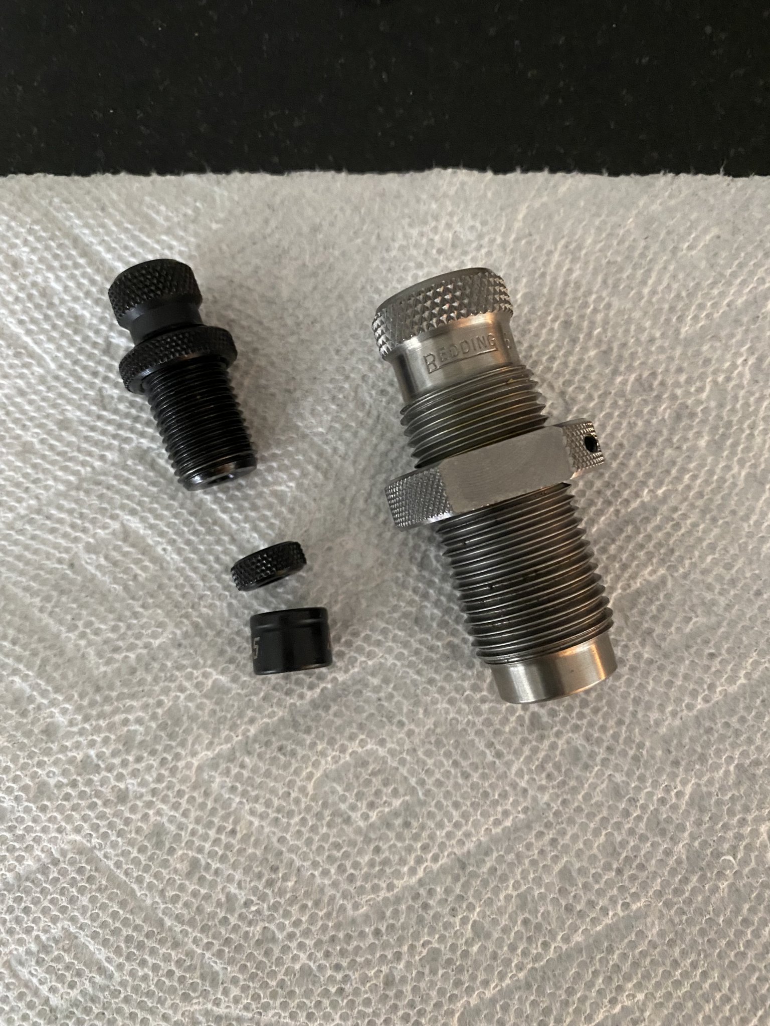

    Attached a crappy pic of the parts of the die I am using.
    Still rattle when top is bottomed out.

    From the looks of the picture, there is only 1 piece inside the die "the bushing". There should be another piece on top of the bushing as suggested by @rustyinbend in post #8. The bushing won't get tight without it. I use the SAC bushings and set them up the same way as Redding suggests to set theirs up. The small knurled nut is part of the original decapping rod which was removed
    O/P, do you see now when you removed the decapping rod with its locking nut on the bottom, it changed the distance of how far down you can screw the top down to secure the bushing. That bottom locking nut needs to be there. I suppose you could just drop it on top of the bushing when you install the bushing.
    SAC says their bushing dies will give you less runout than the other brands will. SAC bushings have a very short taper to them that allows the case neck to enter the bushing and center before sizing. You have to install the SAC bushings the correct way, there is a top and a bottom.
    Thank you. I felt like I was missing something.
    Reactions: max1840

    The setup using their bushings is the same has any other bushings. The mistake I was making was not putting the decapping rod lock ring on top of the bushing before screwing the die back on, as noted in my earlier post.
