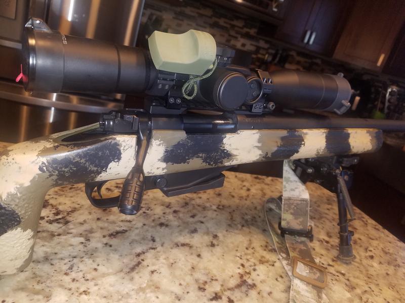

My SPR. Built by me, in my shop☺
Its a burris fastfire 2.
Its not all that practical for everyday use.
I put it on during a law enforcement school that had us (the students) dialing elevation for hostage target shots at 150-200 yds, then having to quickly engage pop-up type targets at 50-100 yards.
When shooting timed drills for a score, I found it way faster than trying to find the target through the scope and holding under by the amount dialed up for elevation. Its also way faster than trying to hit an 80yd target with a pistol.
I got it after getting smoked in scores by they guys using them.
After that school, ive never found the need for it, but it weighs almost nothing, so i keep it on.

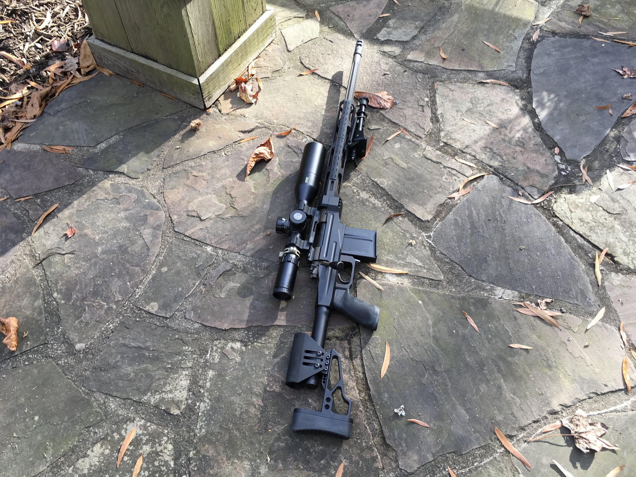

Have a look at the MDT chassis for FN SPR with optional carbon forend and a light weight butt on the optional AR adapter:
https://mdttac.ca/products/ess-chassis-system

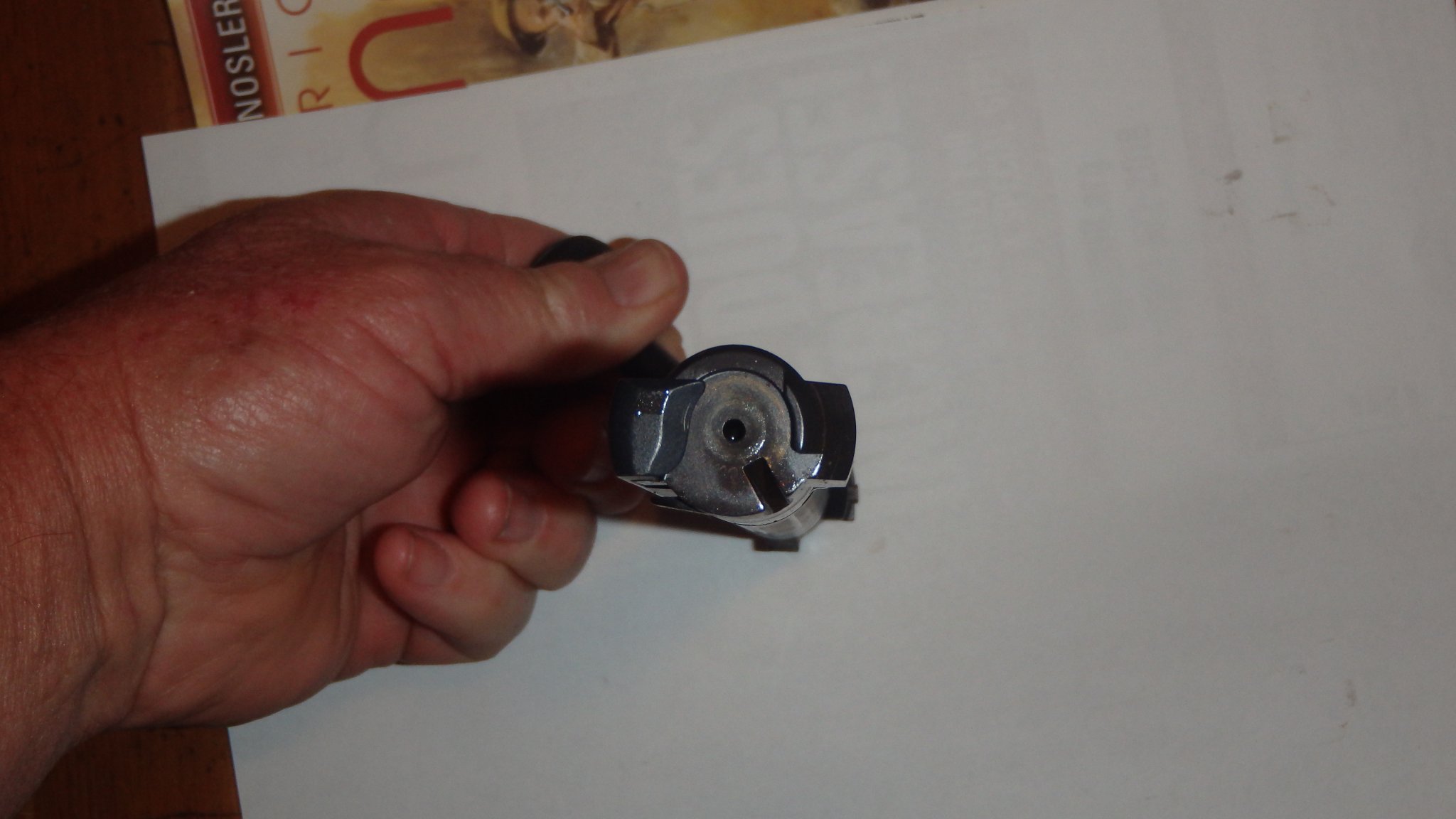

I measured mine to be 2.894"
Thank you very much

FYI... XLR has stopped inletting for the FN SPR action.
It does not show up on their site any longer. I think the Evolution was the only chassis XLR inletting for the SPR action.
These are not common actions, and becoming less so compared to everything else.
IIRC McRee was also inletting a couple of their models for this rifle and may still be doing so.

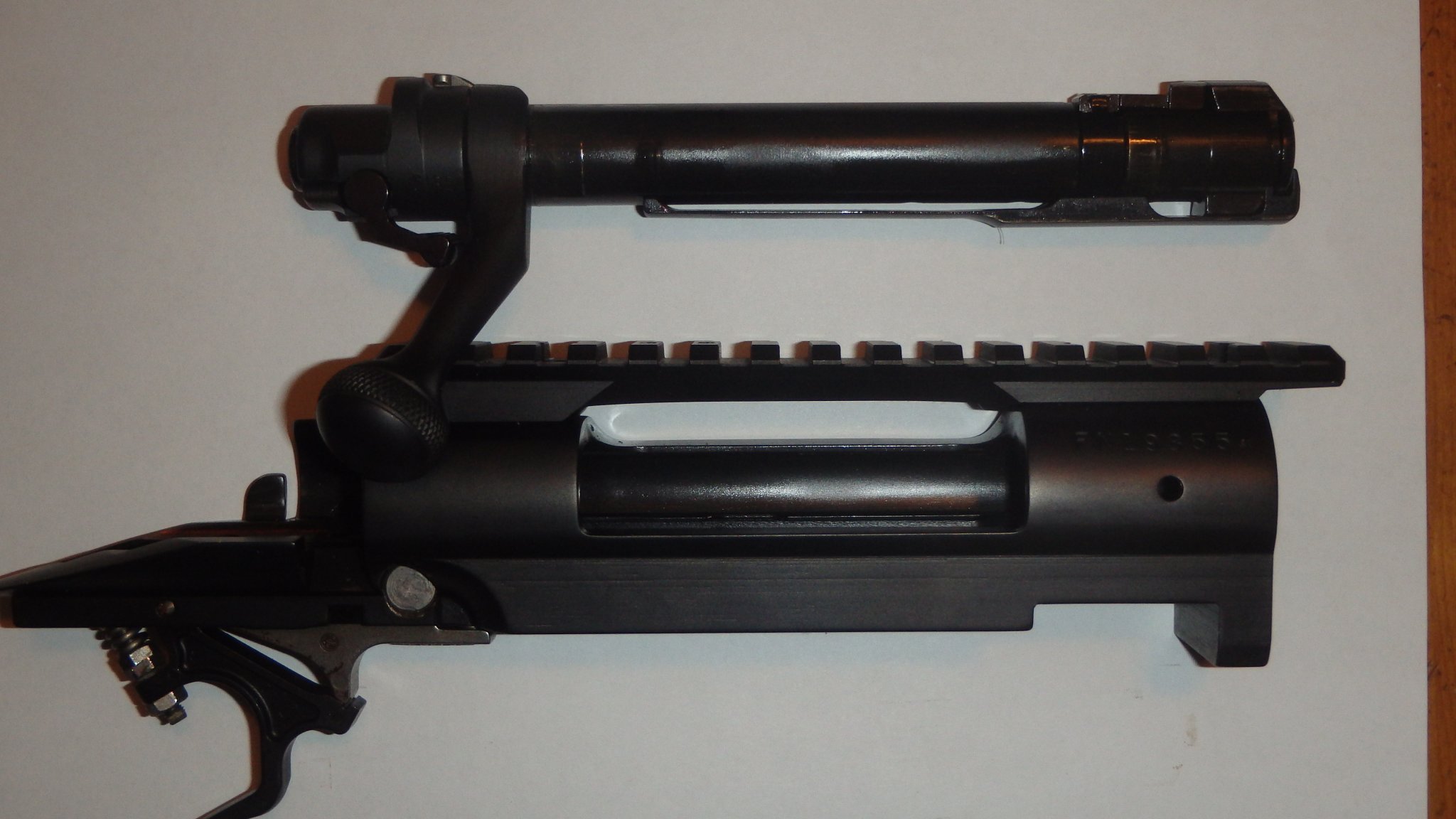

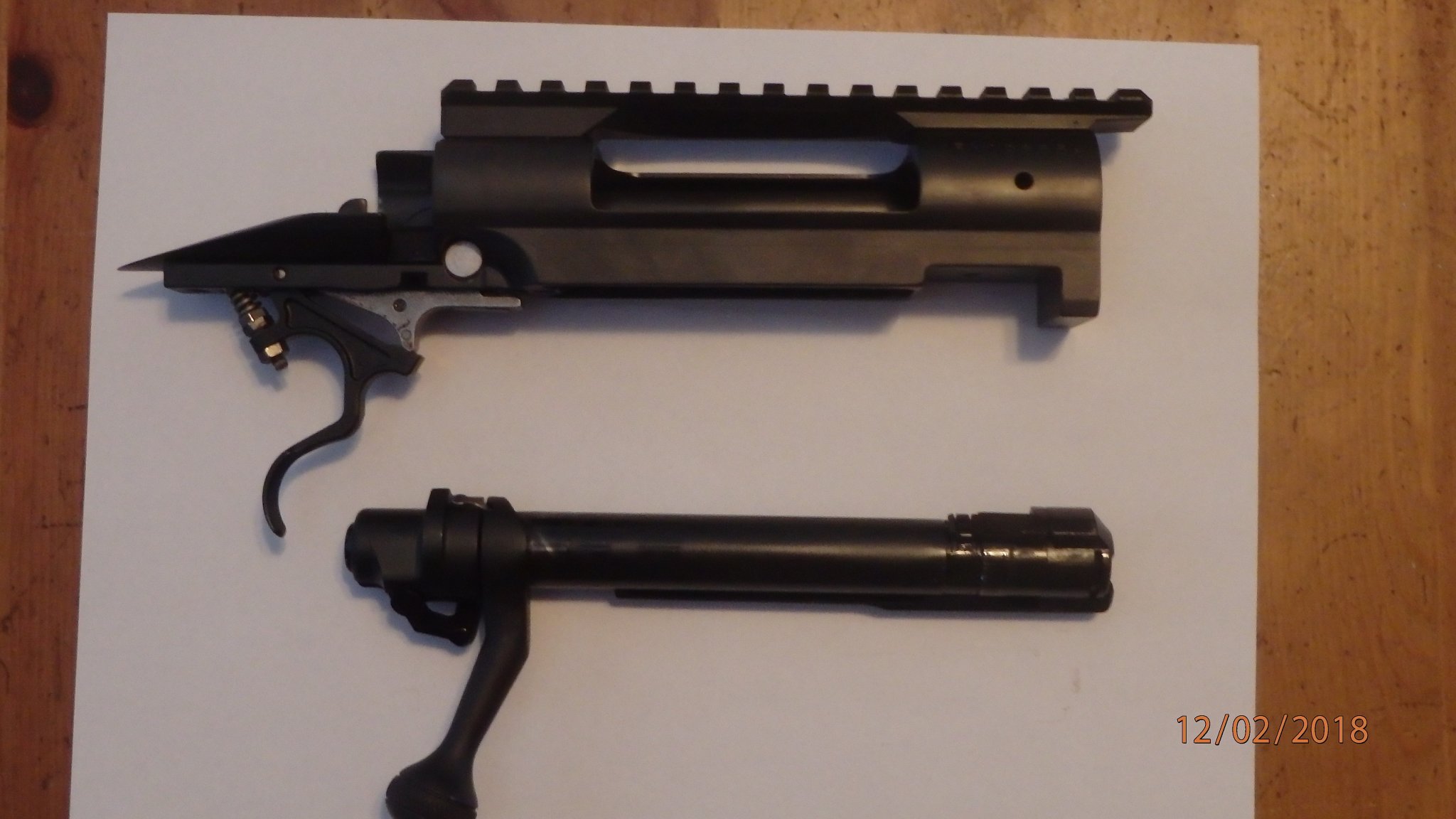

Will looks into it. I bought two. Just picked them up. One says pbr xp on it the othe says spr. Essentially the same. Trigger on spr is a bit better. Will get pics up next. DoeS lee gardner have a bwebsite? How do i ge a hold of him and where is he located

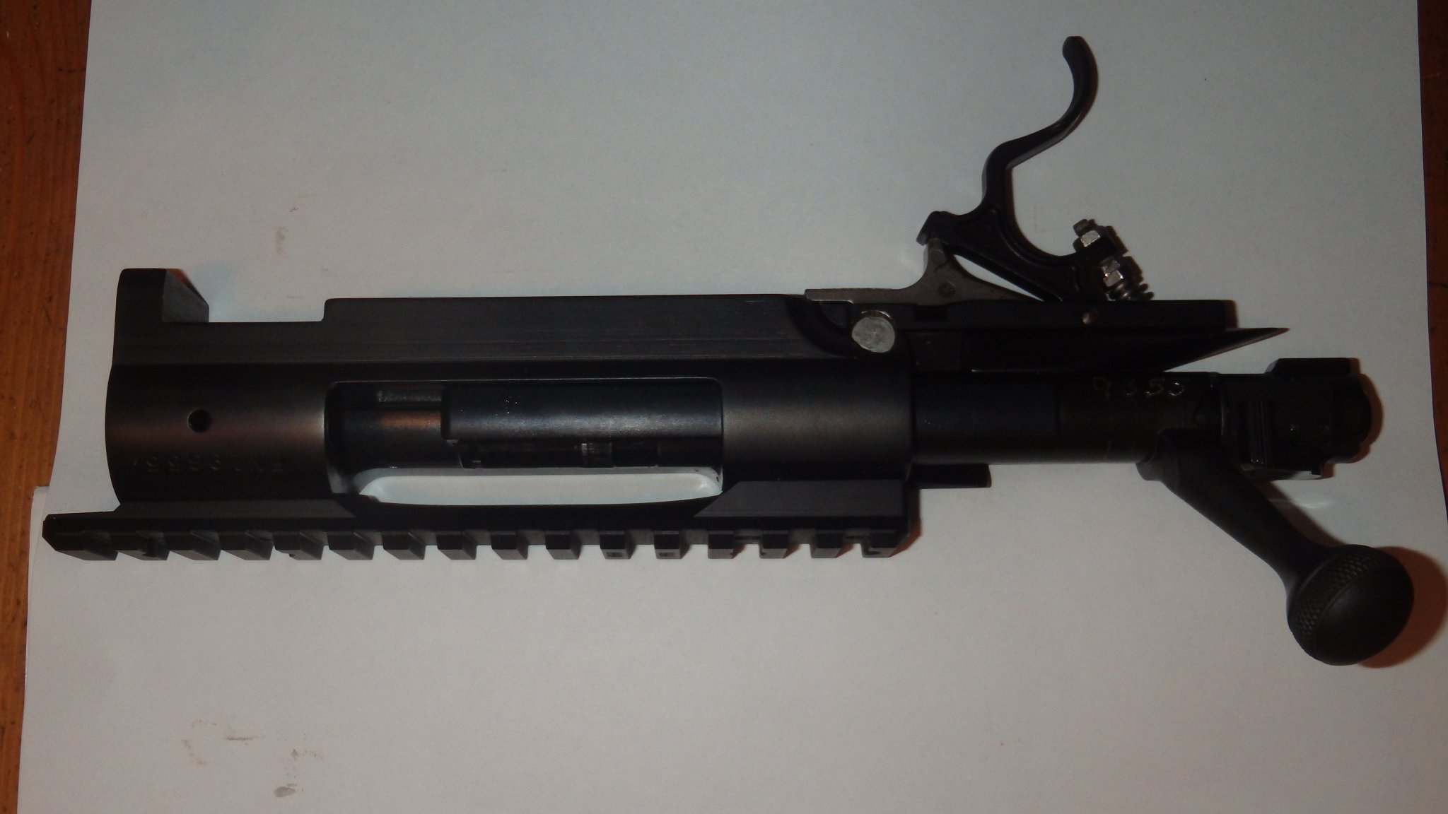

Got mine and finally picked them up. One spr one pbr xp. Spr is a tad smoother with better trigger. Apart from that identical to the eye. I havent taken any measurements

As posted earlier, the MDT ESS is available for the short action Model 70 /SPR/PBR
