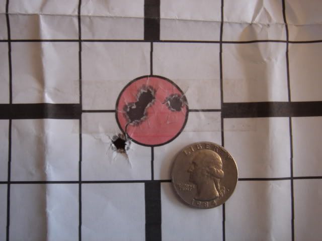

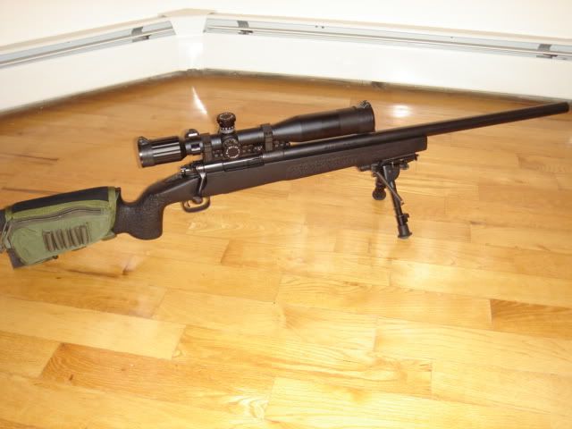

Neo, I found this forum because I recently purchased a FNH-SPR and I must say I absolutely love this rifle!!! I do,however, agree with palmik and would change out the bottom metal so that it may accept the AICS mags.
You wont be sorry purchasing one of these rifles.
I snapped a few quick pics. of mine for you. The photo of the target was at 100yds. using factory ammo. There are 8 rnds. in that group.
