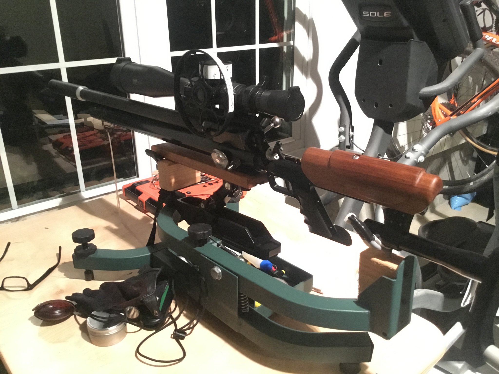

I calibrate the parallax side wheel (6” in diameter) by setting out targets at 2 yard intervals, focusing the scope, and marking the side wheel.
This particular scope was calibrated in overcast weather during the winter.
I assume if I had calibrated it during sunny bright weather the effect would have been the opposite.
As far as I can tell the image remains parallax free since I have adjusted the eyepiece that way and haven’t changed it.
Seems that Occam’s Razor would indicate it’s my eyes that are the issue, not the scope. By narrowing it down to that I don’t have to worry about adjusting the scope, just need to shoot enough in bright conditions to know how many elevation clicks to add to the indicated yardage when the sun comes out. A sliding scale with more or less clicks depending on distance to the target.
Or something like that.

So...adjusting the ocular did not work. Once the sun came out I focused the scope at a known distance and as usual the range shown on the focus wheel was several yards short of the actual distance. I put the focus wheel at the known distance and of course it was blurry...I then adjusted the ocular in both directions and could not attain focus.
So I put it back to where it was before.
BLUF is that this thread has helped me out a lot...I now realize it’s my eyes, not the scope, so I don’t have to go tilting at windmills trying to get the scope to do something that it can’t do. It’s pretty easy to add a few clicks to the elevation and as a result I’m hitting where I’m aiming which was the whole objective.
