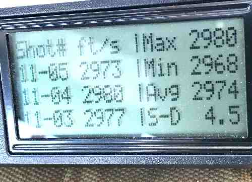

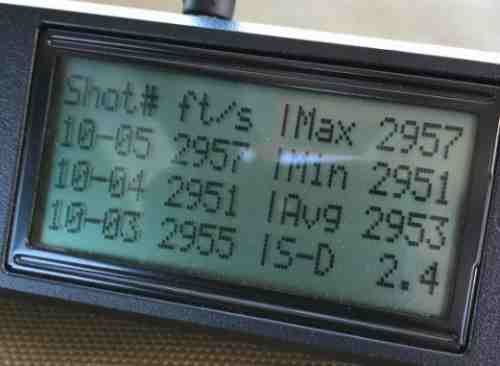

I went home after reading all this advice and some online research to try some of the methods I had read on here. I measured all my bullets and they were all within .0005 of each other so very minimal. I also took my micrometer die and set the stem all the way up and true zeroed my micrometer adjustment wheel, then using the stem I tried to set my bullets to where they make first contact with the lands of my rifle 3.300" from Bullet Base to Ogive. I loaded 10 rounds and was very careful to look for extra tension on the press handle. I had 3 rounds come out .0015 shorter ( handle took very little force to cam over) and I had 3 come out .007 long *(these were really tight when lowering the handle and to the cam over) 2 came out just a little long .0015 or so (Tension was similar to the 2 that came out even) and 2 came out even. I am at a loss, I have a friend that reloads with this press with no issue next time he comes to town I am going to have him look at it and see what he thinks.
I have been struggling with this (not as bad +-.002) for a long while and it showed in my ES/SD numbers as well.
I accidently found a solution last month and the feel on seating pressures and depth seem real consistent now. I wasn't able to shoot until last weekend and I had an SD of 2.4 on five shots. Holy shit batman!!
OK I just thought it was a fluke so I kept shooting all day until my last 5 rounds. Hummm ........ temps were 63 in the morning and 80 in the afternoon. Decided to put the Magnetospeed back on for the last 5 shots and had an SD of 4.5 which is higher but still less than 1/2 of my best ever.
So what did I do to get this magical result? Still need to duplicate this over and over to confirm this claim.
I added Nu-Finish to a fresh batch of tumbling media, that's all.

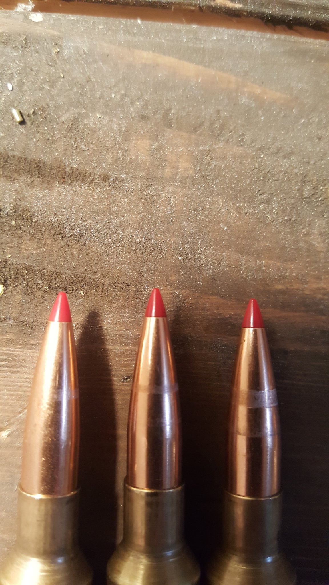

So I got some time to play around with this a little more this weekend and might have figured something out. I checked every possible variable I could think of Neck Tension, Brass Length, Bullet Base to Ogive length, the inside of the necks were all chamfered, ect. Seated 2 bullets back to back and got one that came out .015 longer (far right) than the first vs middle) it looks like the seating stem slipped further down ?
I don't know, but good LORD that stem is rotting your bullets. You need to get that shit checked out, bro. Git some antibiotics or somethin...
I like the suggestions of annealing and switching to an expander mandrel to help provide more consistent neck tension. It sounds like you've got a lot of pressure during seating, which I generally don't like. You could even try a larger expander mandrel that's 0.001 instead of 0.002.
With the marks on your bullets from the seater stem, the other thing I'd do would be to take the seater stem out of the die, chuck up a bullet in a drill and then polish the inside of the stem with metal polish and the bullet so that there were no sharp edges and the contact point was more evenly matched to the bullet shape.

I sent that picture to Forster Customer service and they are going to try to send me a new seating stem and see if that helps my issue, I wonder if it would be worth have the stem custom machined to my Hornady Bullets to make sure they grab at the ogive line
And this is with very light steady pressure I am not jerking it or anything like that or forcing it down. Does the mark seem a little high for the ogive? I thought Ogive was a little lower?
Are you using a VLD stem? The Benchrest Seat die page, indicates it has the VLD stem, the page for the mic dies does not, could be just an omision. It looks like the stem is slipping down the bullet, the stem would be the wrong shape.

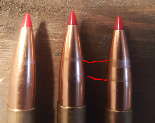

Im curious why you have two different rings?
The ogive is the entire curvature from the bearing surface to the tip. When we say measured on the ogive that typically means just a bit in front of the bearing surface.
A bullet is .308" but the lands are .300" so even the barrel isnt actually first touching at full diameter.
Do like sheldon said: unscrew the top off your current die and see how the bullet fits in it the seating stem.
Reactions: FishDr
So the top line is from the seating die and the bottom line if from my Hornady 5-26 comparator. Which one is more correct ?
Both and yet neither.
Looks like youre really pushing on the caliper wheel though if youre scribing your bullets like that with the comparator.
I agree with you there I need to ease up a little I think. I think that I will see how the new stem works and give Forster a chance to see if they think its my brass or something else then look into getting the stem custom machined to fit the bulelts
You can custom "machine" a stem yourself like sheldon said. The forster should have a "vld" stem already though

And incase youre apprehensive about unscrewing it and losing your settings just to check, the forster seater can be unscrewed at the point in red below, you can access the internal sliding sleeve and end of the seating stem without losing your place.
I just dont see how you can be having enough resistance to mar the bullet like that if you are really at .288 sized and .290 seated using a boat tail bullet.
I have heard of the forster stems splitting and so as you force the bullet in it spreads wider and maybe thats whats causing it: it has a fracture and as you get spread it also gets forced tighter as its wedged in the die which would also help explain how its such a wide mark as well.
When using any precision measuring instruments, you need to calibrate your hand to stop advancing the instrument when it JUST STOPS.
Bare CONTACT is all you are looking for: ie: there is no longer any air between the copper and the stainless. But don't go any further than that.
1) It results in varied and erroneous measurements, and
2) It damages tools.
Some of these measuring tools, as you progress in this hobby, get downright expensive. Tearing them up with brute force is a bad idea.

The first thing forster had me do was to take this apart and send them pictures of the bullets dropped through the sleeve he thought they might be binding but the dropped in free. while I had it apart I took a picture of the stem doesn't look cracked or like it has any sharp edges to me

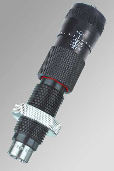

http://bulletin.accurateshooter.com/tag/seating-stem/
For anyone still following this I follow the method of tuning my seating stem to my bullet using a drill and some polishing stuff and now it is seating so much better about 90% are coming within .0005 of each other still got a few that are a little tight that need an extra push but this was a major step in the right direction. Thanks for the tips!
Also my stem no longer leaves any marks than cant be wiped away with a cloth
