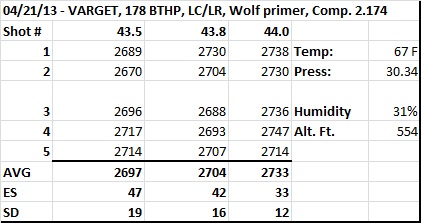

Good timing, I made the switch to 4064 also and had a chance to test some loads this weekend. My rifle is a GAP Rock, 22" Rock barrel 95 Palma chamber. I was using LC LR brass.
Pictures are worth a thousand words.

What are you plugin in to get 2600? When I see what JBM gives me its approximately 2470 ft/s which would seem about right with a 20 incher. It would be cool though if it was 2600
