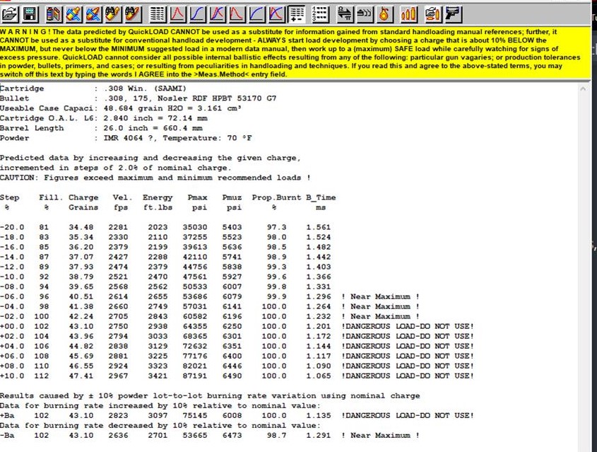

You didn't say what to what COAL you're seating them Nosler RDF's too, but I used a COAL of 2.840 just to see where the number fell and your Winchester brass affords you more case volume to help keep the pressure down. It looks to me like your powder might have a higher and normal burn rate, which produces higher pressure and velocity for a given weight. That could be due to the powder having dried out (less moisture than when new). QuickLoad uses a default burn rate much lower than what I'm seeing in your numbers. Here's what your numbers looks like with that particular COAL:

Bolt lift and extraction were normal as if it we an empty chamber. Thanks for the Nosler data! I don't have that manual an only referenced Hodgdon's Reloading Data Center. Perhaps a lesson learned there. I'll definitely have to consider the hotter days to come here in New Mexico!
I don't have the measurements in front of me for COAL but believe I am 0.005 off the lands....although that's no help for COAL since every chamber is different. I can tell you this is not a compressed load for whatever COAL I'm running, but it's close! These cartridges were loaded from a fresh 8lb jug of 4064 about a year or so ago and I always store my powders tightly sealed in their original container at room temp, but do not have humidity controls. That could definitely be a factor, but would have had to dry out pretty quickly just opening a fresh jug. I suppose it is a good thing I was using a chrono to question things before I loaded up more/hotter loads. The data I provided is the highest I went and I will definitely stay under 43 gr and/or around the 2700-2740fps area as the absolute max.
