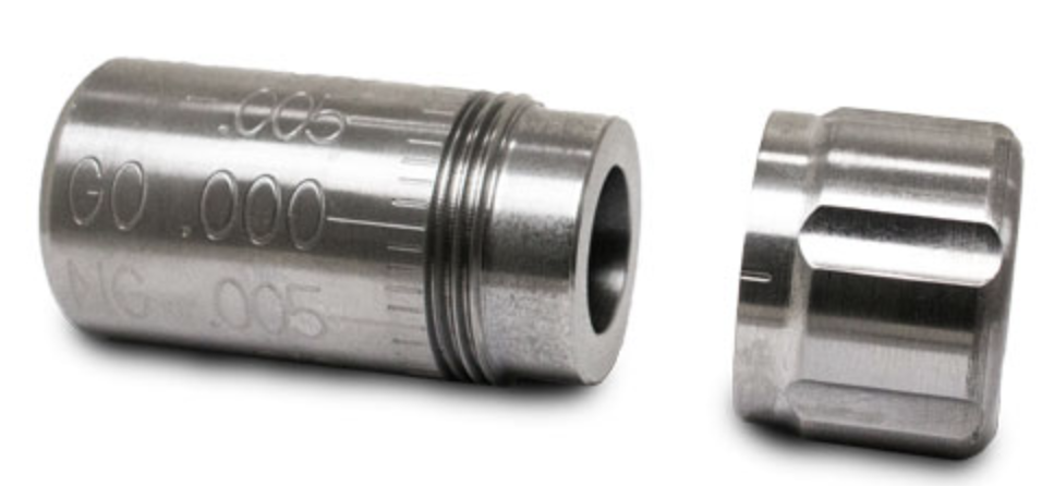

    FWIW, I use the Hornady comparator and comparator headspace bushing (.375 for 6/6.5 creed):

    How are you measuring the shoulder?
    That whidden case guage is tits, i have one. They also makes a comparator like the hornady one.

    Measuring with the Hornady comparator. I got a real pair of calipers and my measurements seem a lot more accurate now. I still bumped way more than the rule of thumb this first time, but I'm going to go ahead and load these and correct the mistake next load. Thanks all!
