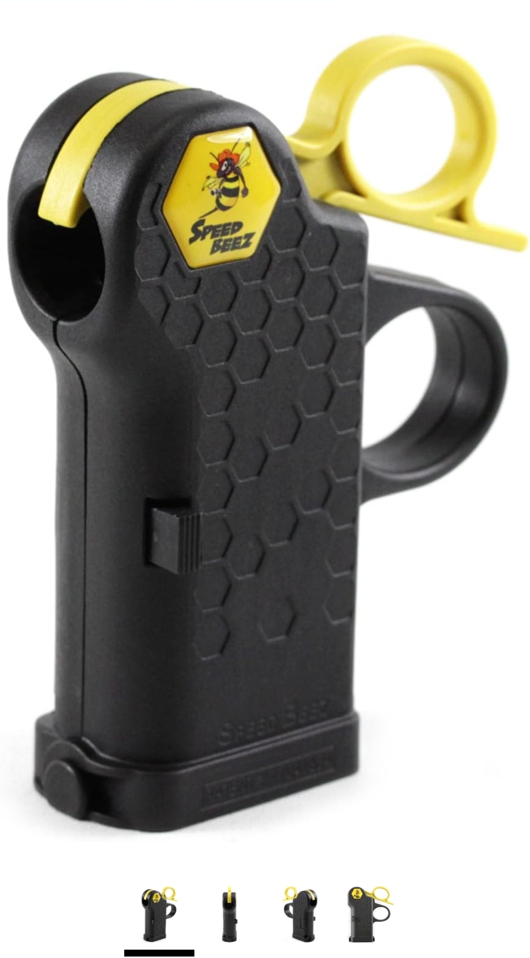

I just thought my Lula loader was good. I doubt you can beat the Lula for pistol mags though.
I've got one of these. More mag specific than Lula but it does lock the mag in.
