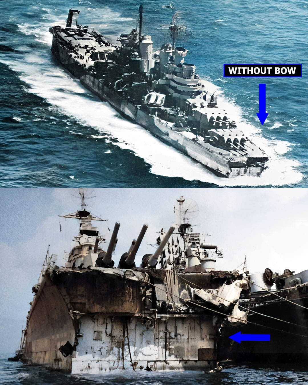

Holy shit. (There's a pun in there if you know the story...all the toilet paper was stored in the bow.)
USS Pittsburgh (CA-72) shown missing bow in Guam, The remaining hull limped back to Guam under her own power for temporary repairs, despite the missing bow
On 5 June 1945, Typhoon Viper unleashed massive seas—waves over 100 ft and winds up to 70 knots—on Admiral Halsey’s 3rd Fleet. Pittsburgh was among 33 ships heavily damaged in the storm.
The ferocious wave ripped off around 104 feet of her bow, tearing at frame 26 and detaching the forward section completely.
Remarkably, engineered bulkheads held, and the rest of the ship remained watertight enough for survival.
USS Pittsburgh (CA-72) shown missing bow in Guam, next to USS Duluth (CL-87).
The front fell off. That’s not supposed to happen…..like ever.
