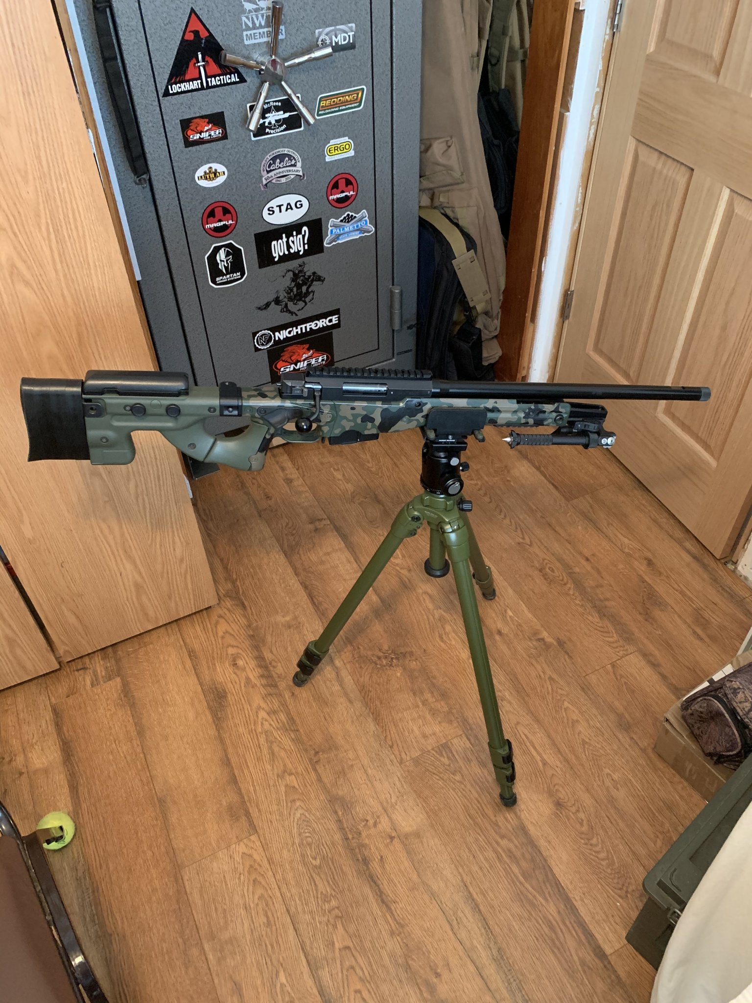

Here is the configuration I purchased the rifle in off the px here. (Without the atlas and tripod) came with the original stock which matches the camo on the rest of the gun
I’ve always loved the look of the AIAW rifles. This was my dream rifle for a long time. So when I came across the AT in a similar configuration I had to try it
Haven’t regretted this purchase even a little bit

That's a sweet, sweet rifle, man. I'm with you there. I grew up wanting an AI AW badly...and I suppose I still do. I don't know why exactly the newer AI don't hit me the same way...
I'm constantly talking myself out of buying rifles (like the PPR) because I already have more than I can shoot at one time (and, of course, wasn't smart enough to buy ALL the components I needed to load for 'em at the outset).
I grabbed a KRG SOTIC because, much like the AI AW, I've always had a soft spot in my heart for the Sako TRG. Maybe I'm just a rube trying to buy my childhood back one precision rifles one at a time, heh.
