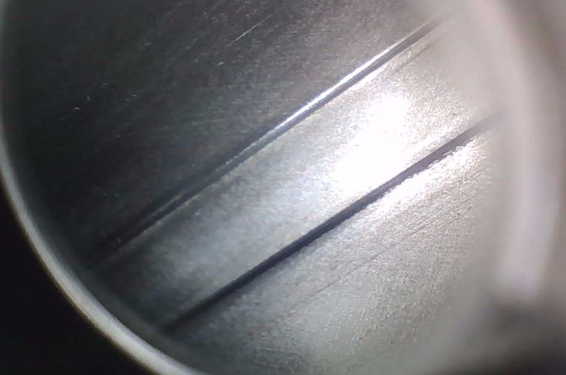

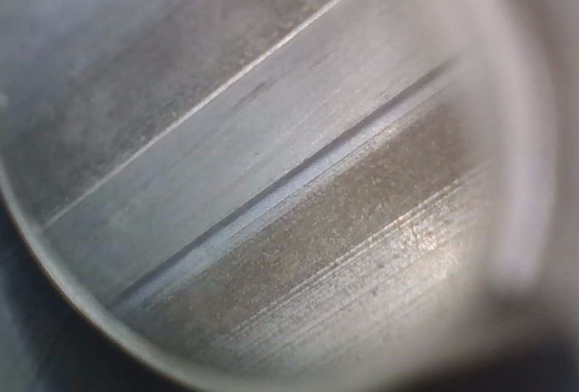

since this is revived, i will go ahead and show my ocd.
was trying to wait until >500 rounds before cleaning, but it was so windy the range was closed on my day off and i couldn't help myself.
basically i wanted to see if accuracy dropped off at some point (not that you could tell from my shooting).
@300 rounds.
after
Reactions: Skunkworx
