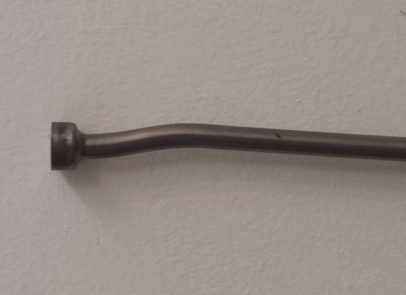

Hoax if that Gap 10 doesn't run like a sewing machine after a couple hundred rounds send it back to Gap and have them fix it, send all your ammo receipts and ask them to reimburse you, if its their fault they should.
Did Gap install your Gas block, or did you or someone else do it?
OP you paid a lot of money for that rifle, probably waited a long time too, call GAP and see what they think before you spend any more money on ammo or range trips.
As I mentioned, I have the Precision Reflex low profile adjustable gas block. The gun smith (who is a competition shooter) is convinced this is a gas issue.
WTF? How did that get on there? If it came from GAP with a different gas block I would put the old one back on. Otherwise you need to dial it up as it sounds like obvious short stroking.

I gave my Gap 10 a good cleaning and lube when I first got it before shooting the rifle. Initially I had no issues, till after 20 rounds. I had problems with FTE and FTF, suppressed and unsuppressed. I am running the Noveske gas block. Call GA Precision, my problem was bad gas rings, that I corrected myself without sending the rifle back; it was an easy fix for me. You can spend a lot of time and money training to fix this issue when it could be something simple like gas rings; I zero issues after I changed my gas rings.
Please explain why you had bad gas rings, on a weapon that only had 20 rds thru it.
I had one that was overgassed. We put a SLR adjustable gas block on and it fixed the problem.
Gunfighter14e2 - With my rifle the trouble started after 20 rounds, I tried different ammunition, running the rifle wet, running it dry, then I ran a different BCG and the problem stop. After a more detail inspection of my original bolt I isolated the problem to the gas rings. If I stood the BCG on end the bolt would not support it's own weight, once I changed the rings the bolt would stay full extended with the full weight of the BCG. It could have been a manufacturing defect with the gas rings; that is the only explanation I can think of, and then to fail after so few rounds. I have several thousand rounds through the rifle now with no issues at all. I have 4 AR 10's and my go to AR 10 is the GAP 10. Yes, I will buy another GAP 10. Best advise, if you are still having problems is to call GAP.
