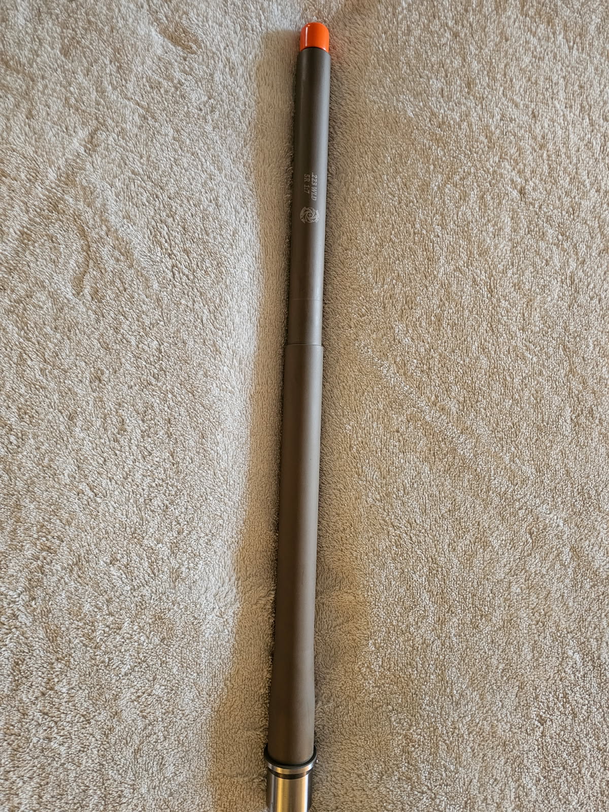

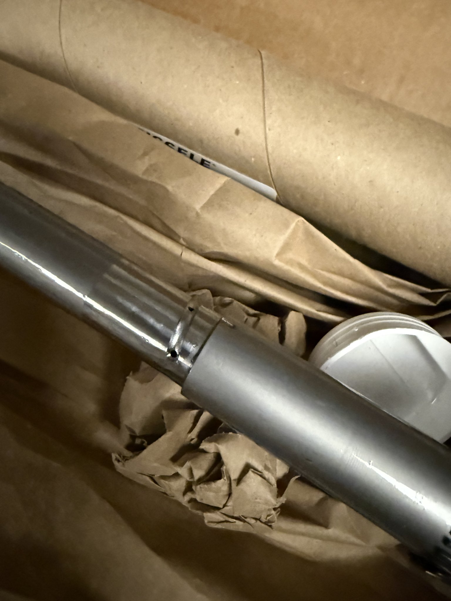

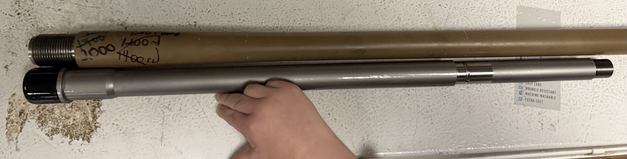

My tracking information has the barrels arriving on the 6th, I'll post pics with full details when they arrive.
I have everything needed to assemble them into complete Uppers.

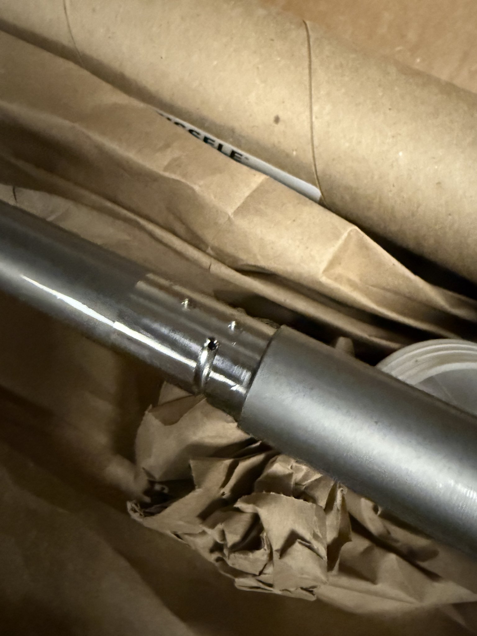

Standard low profile Plain Jane Gas blocks, I would normally go with SA Set screw AGB but I'm sure as their standard Barrels are gassesd perfectly it won't be needed.
I'll try the Geissele Gas Blocks but the pre drilled pinning hole gives me pause for potential gas leaks, I won't know my options until I have the barrels but I'll demonstrate on here what will be best suited for this application in full detail.

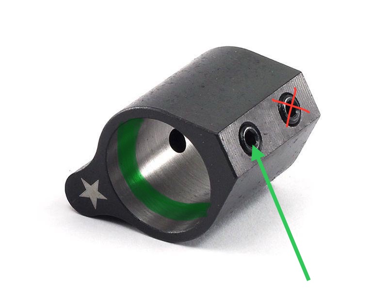

This might be a decent option for a tight fitting gas block.
Finding a tight fitting gas block can be a crap shoot in my experience. I don’t even worry about it anymore. If you do have a loose fit where the block slides around with little resistance, you can easily fix it by sealing it with Loctite 620.

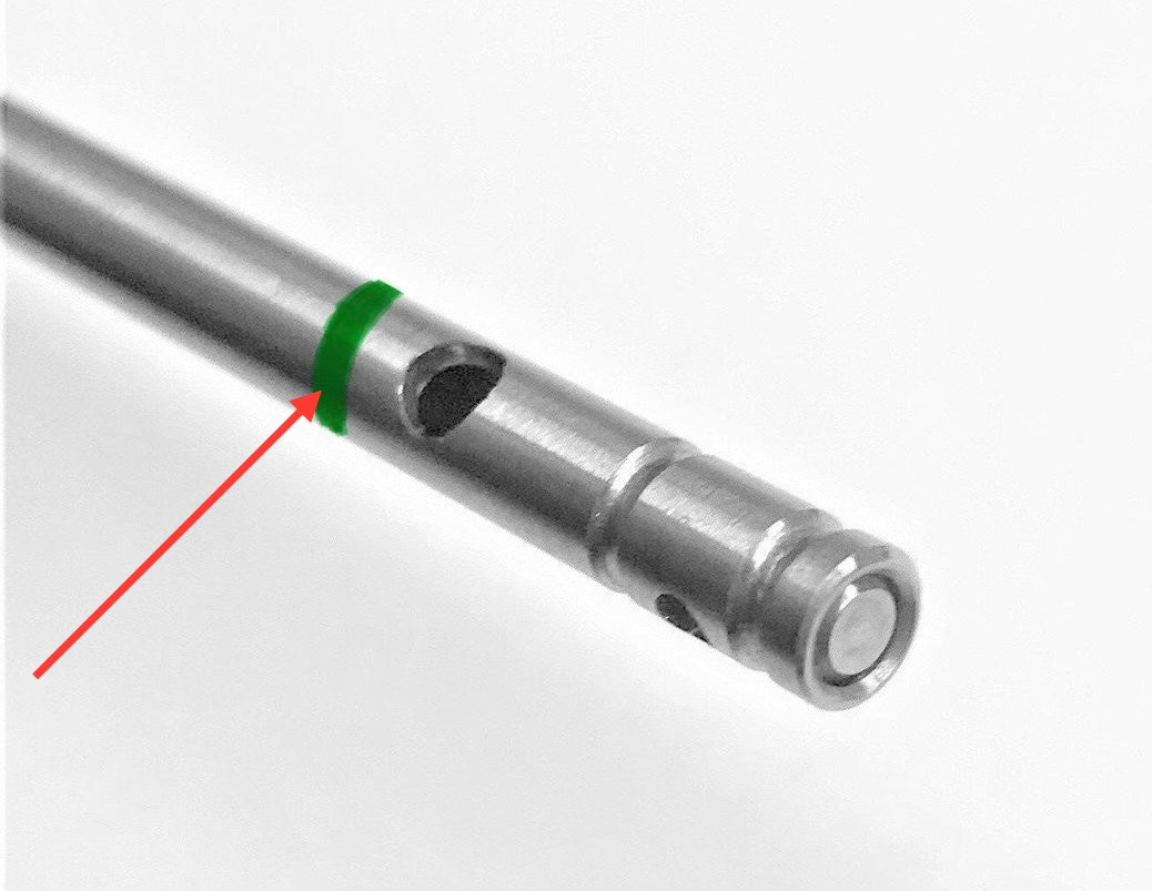

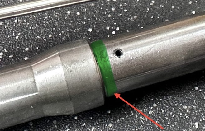

Here is the method that I use that works well for me. I haven’t seen any carbon leaking from my gas blocks after applying the Loctite this way.
First, apply a thin bead of Loctite 620 around the barrel, directly in front of the gas block shoulder but behind the gas port. When you slide on the gas block, the rear of the gas block will be sealed. Don’t pull the gas block forward because you don’t want to smear the Loctite over the gas port.
Next, use the gas block set screw hole that doesn’t line up with the gas port hole. You are basically using this set screw hole as an access port to apply Loctite around the circumference of the barrel. Spin the gas block around the barrel, dabbing a small amount of Loctite 620 through the set screw hole, at a few different positions around the barrel. Then, spin the gas block around a few more times to spread out the Loctite. You’ll want to clean out the excess Loctite from the set screw threads before installing the set screws.
If you do it right, you’ll get a thin layer of Loctite behind and in front of the gas port that will seal everything up once cured.
EDIT: I also apply some Loctite 620 to the gas tube, behind the gas port hole, before sliding the tube into the gas block for pinning.

I think @Bigjake83 has also posted pictures or explanations of how he seals his gas blocks. This is just a simple method that has worked for me. If it doesn’t 100% seal everything up, it will get you 90% of the way there and carbon will quickly seal up any remaining leaks.
It was tongue in cheek. 620 is wicking grade though and you should be able to apply it through the front of the gas block and gas tube (if block has open front).
I believe that Loctite 290 is the whicking grade thread locker while Loctite 620 is a high temp sleeve retaining compound. They are both green so it gets confusing but they are designed for different applications. I think 620 has a much higher temperature rating as well.

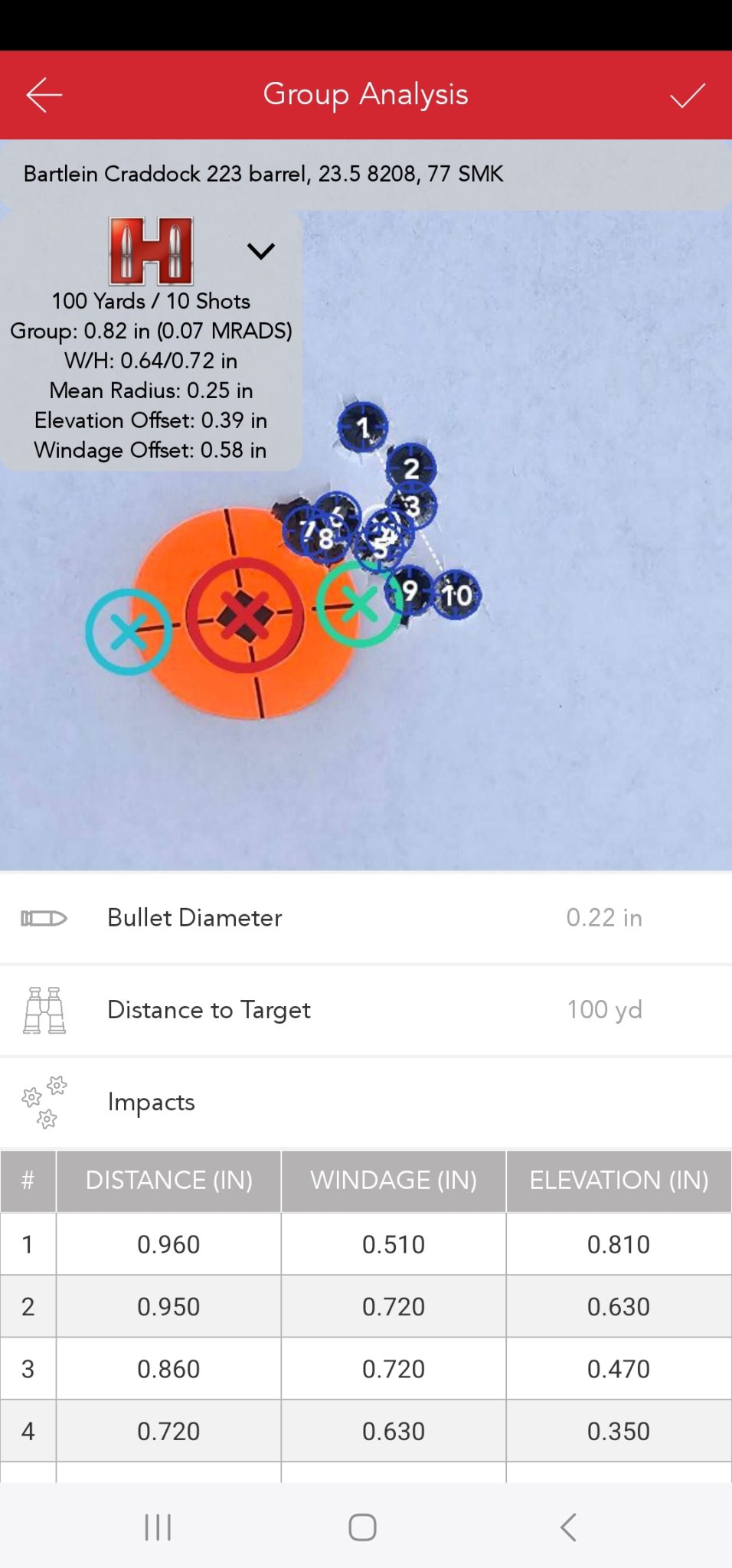

Yeah I know that, I just wanted you to see what the current 16" and 14.5 heavy Contour barrels are producing pretty hard to beat that accuracy in fact I'm almost kind of skeptive that accuracy game will be marginal.
I took both of my 16" and 14.5" Geissele heavy Contour barrels out yesterday and I will post pictures of the groups here in a second, thay all look to be Sub Half MOA.
It's kind of damn hard to beat that.
Yeah, those are pretty fantastic results that are hard to argue against...
Reactions: BurtG

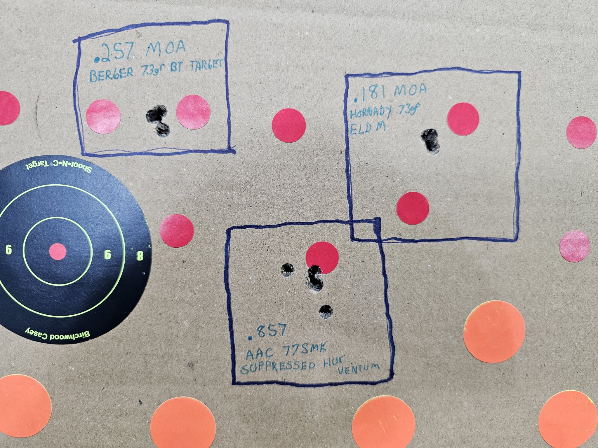

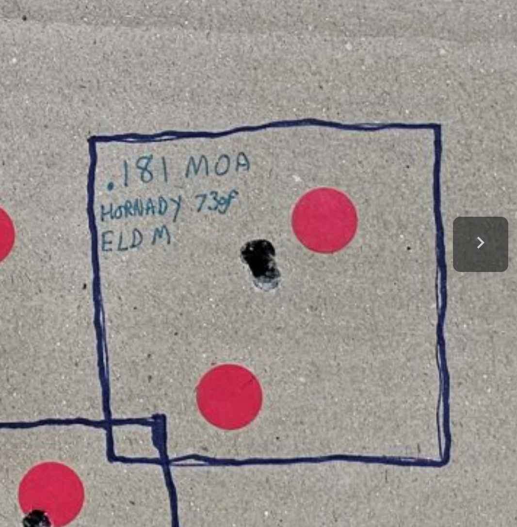

All 5 shot groups of various types of factory ammo with the exception of some cheap 55 grain stuff I use to season the clean barrels before I shot the groups and a couple random 77 Grand tmks I had hanging around. The Geissele heavy Contour barrels truly love the 73 grain projectiles.
As far as I'm aware of this is groundbreaking accuracy out of chrome line barrels.

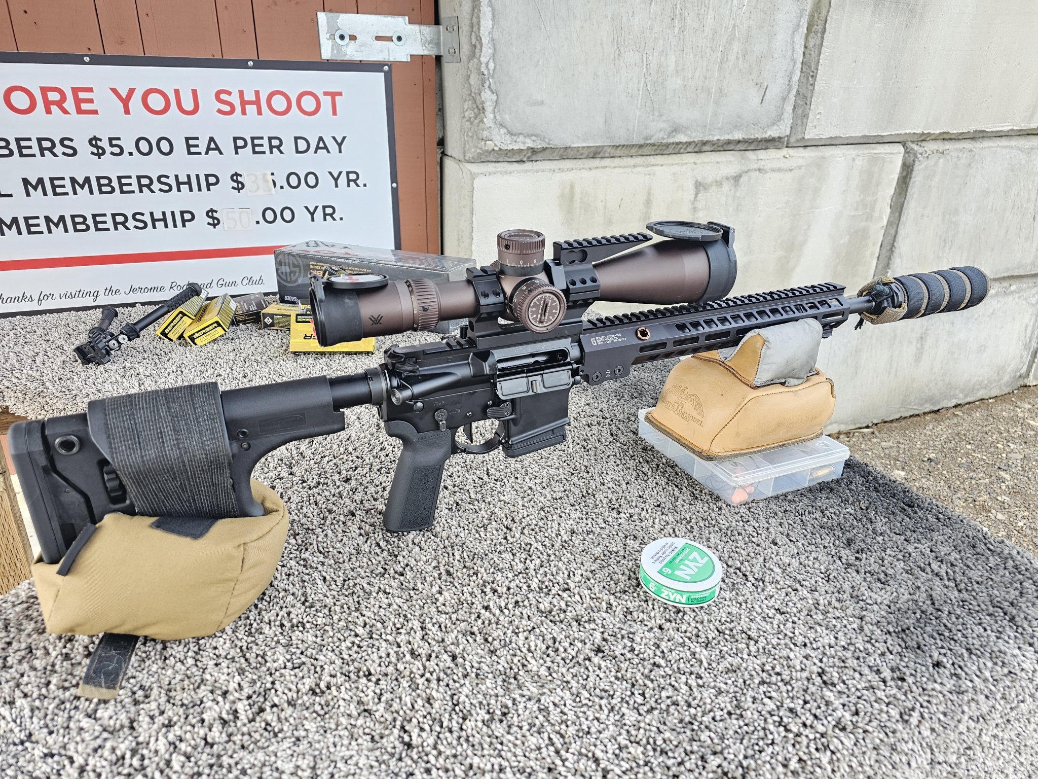

Ok here it is, with this bullshit Mickey Mouse front and rear bag setup the point of impact shifted half inch right, having no front end stability I was having a hell of a time controlling the rifles CANT which ultimately caused a few Flyers.
Hope this helps.
