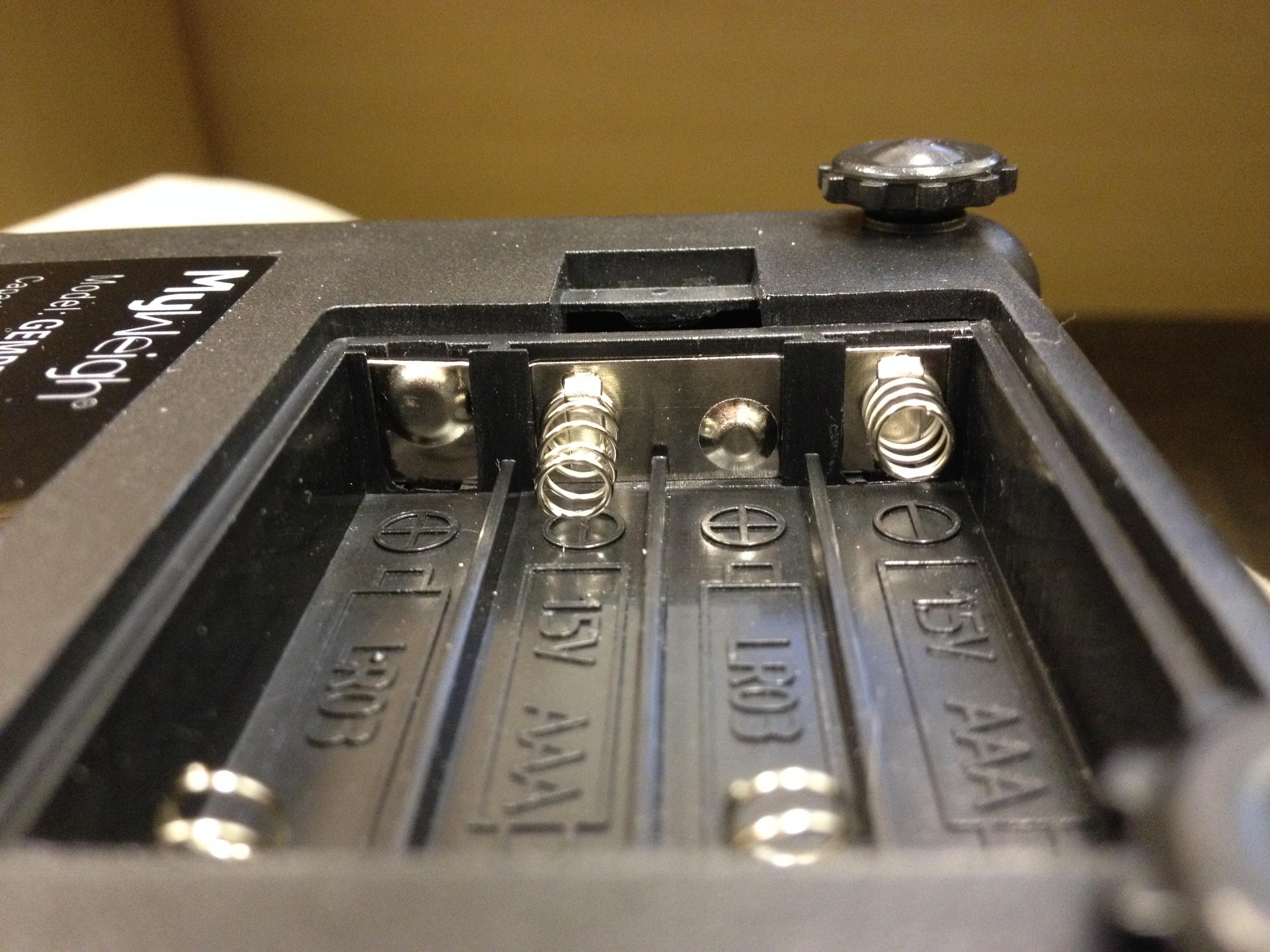

More issues with battery panels I've seen on last two GP 250's I've wound up returning.
You're best to send it back to jobber you bought it from. Believe there are instructions to that effect in box it came from. I'd picked mine up from Old Will Knott, and they handled first exchange and ultimate return of second promptly, and without issue.
