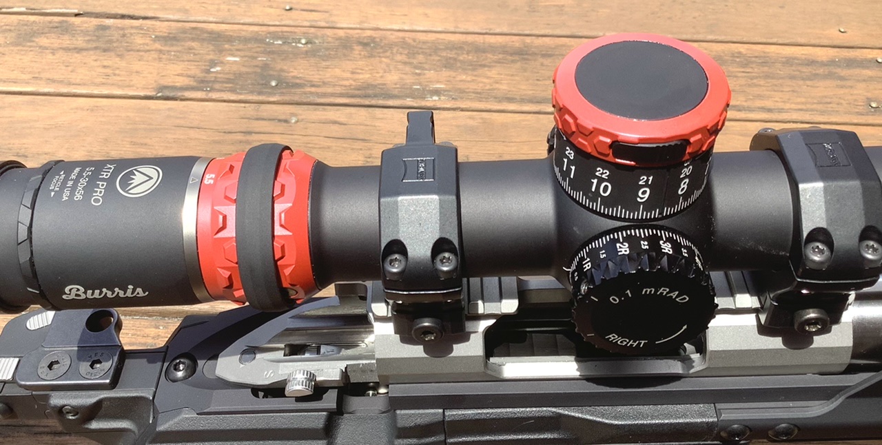

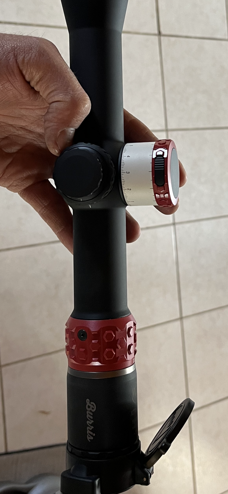

Well that’s a little discouraging. Any pics of the new cerakote knobs?
Here is a close up of mine. It’s just a blah dull red
I think I like that better than the anodized color - not a fan of anodized colors, they always look a little funky. I think I’d paint the rest of the scope white and blue, I think Dorgan has a rifle that would match that pretty well 😉

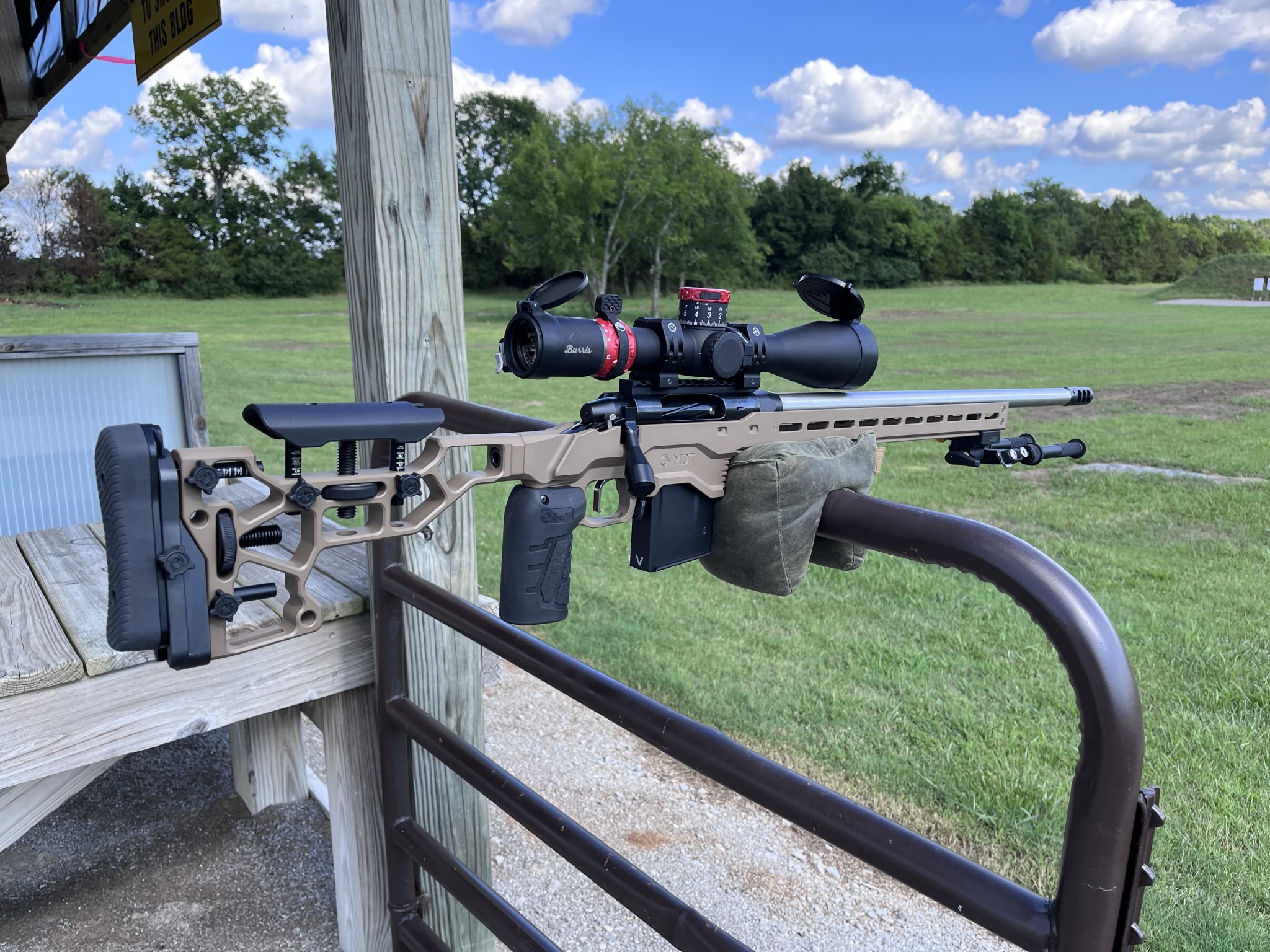

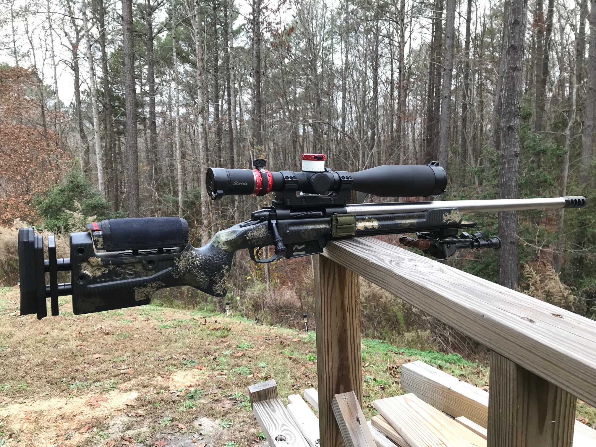

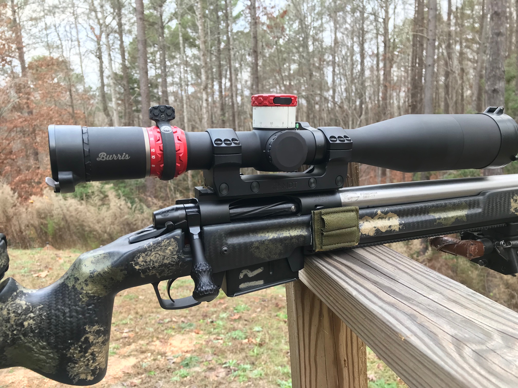

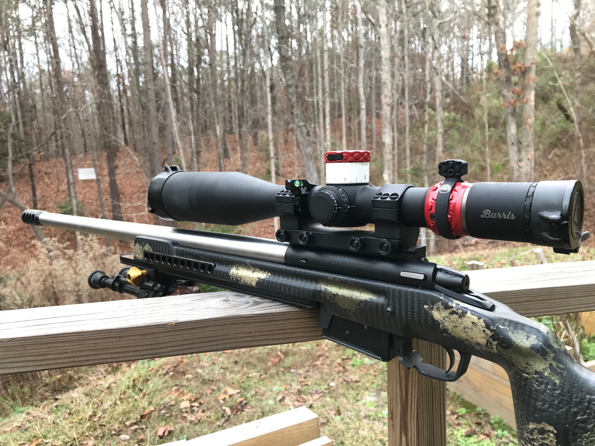

UPS made a Christmas miracle and dropped my Burris Pro off today. I was shocked but popped it on my rifle and took a few pics. Overall it's a nice scope. Glass looks really good in my peering 100 yards into the woods looking at leaves but will give it a better test this week at the range. I like the reticle. The little + in the center is nice and not overly heavy. Put the switchview on and the power ring moved smooth enough. Parallax was a little rough and the finish is kind of a rougher feel so when you run your hand over it you can leave a little skin smear but it's not a big deal for a match optic. You can see a little in the third pic below near the sunshade.
I didn't play with zeroing yet but popped off the race top and it comes off easily and goes on easily. The book says it is zeroed on a 20 moa base from the factory but I spun the knob up and I got two full rotations and a mil so 25 mils as each revolution is 12 mils. With a scope that is said to have 26 mils it will be interesting to see where it ends up after zeroed. Clicks are tactile and audible.
Well here's a couple quick pics to show overall size on a rifle. Will play more with it when I hit the range and compare it to other scopes. Hopefully ups drops my Tract off Monday instead of Tuesday. LOL
