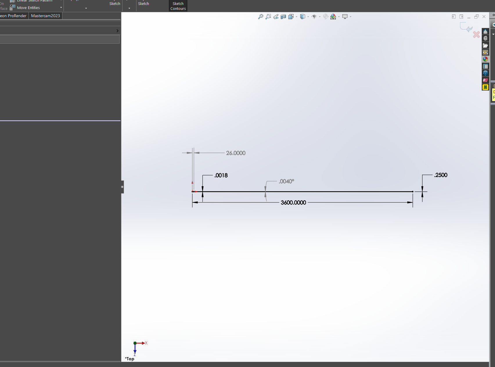

Here's my attempt to answer your question. I made the drawing using a 26" barrel. It does not factor in a receiver length, nor a specific location of the sight(s) or optic. I used the muzzle as the datum to calculate the movement required to create a 1/4" POI deviation.
.0018" is what I came up with. Just to be clear, .0018" is a linear value, not angular.
The angular dimension is .004 degrees.
Research from a long time ago revealed that a healthy human eye has a resolution of about .002" (2 thousandths). A 20x power optic should increase this to .0001" (1/10th of a thousandth) resolution. It starts to paint a picture of how bad things actually look when a shot goes "off the grid."
In 2003, I ran around a bit with the US Palma Team. It was impressive to me to watch folks pound a 3-4 inch shot plot from the 1,000 with iron sights. (When conditions were nice) While still impressive, dissecting the math, and a better understanding of how the eye works, helps to explain some of this.
