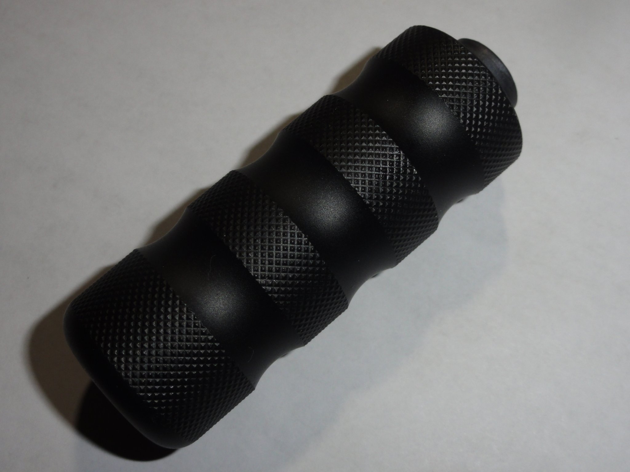

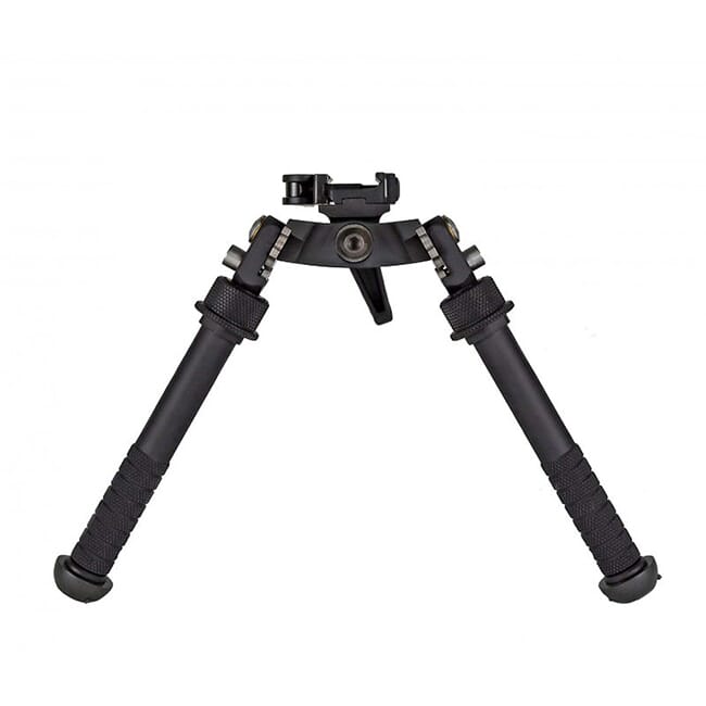

    Hello Sam,
    I got sick of my bipod coming loose as well. Atlas could fix the issue with some sort of spring design that would use an adjustable spring tension pre-load. From the look of it, it may be just a modification of the existing design.
    Personally, I would start by looking into Belleville spring washers but that is a different post altogether.
    I bought the handle shown in the photo from evil-bay for about 15.00 bucks. It is cheap, adds weight easy to grab etc. I had never looked into the wrench that has been mentioned here.

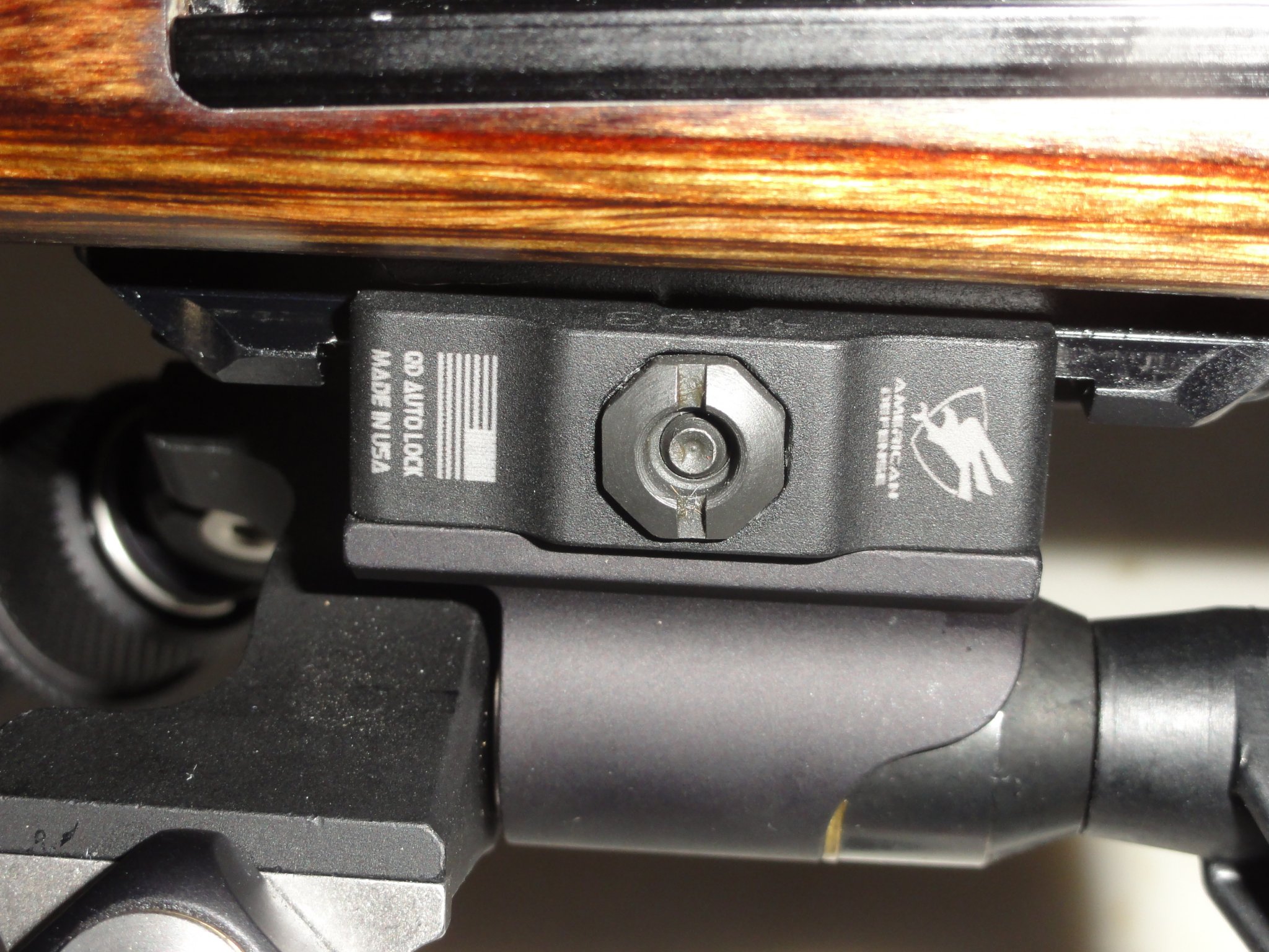

    I just discovered the QD Auto lock feature on the Atlas. It is a tool-less method to
    adjust the pic rail clamp force. It looks like you need a coin or screw driver but that is not the case.
    You simply compress the clamp with your finger and thumb to get the octagonal nut to pop out of it's recess and rotate the nut with your fingers. The pic rail clamp has a built in spring that will pull the nut back into it's recess to prevent rotation.

    Hello Sam,

    This might have been done by you by design just to illustrate how far the tension knob will protrude once you compress the ADM clamp but once you have the tension adjusted the tension nut should correspond with the flats and be back flush in the recess, otherwise you can actually damage the ADM clamp spring. I'm using the ADM leveraged rails on all my Atlas bipods in the form of the LW17 version, and on the Accu-Shot momopods as the BT43 leveraged rail. It just makes things so much easier to switch back and forth, or to take off for maintenance, or to exchange feet.

    I realize what you meant, I removed the last photo. You are correct, the nut should alwas end up flush
    and in it's pocket. The deleted photo was from another post indicating what the nut looks like when
    it is not in it's recess and free to rotate.
