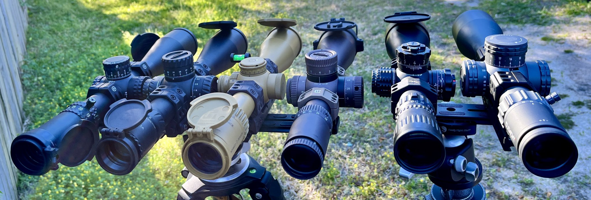

I just received a Schmidt 6-36x56 and a friend is sending me his TT 7-35x56 for review, I plan to also throw in my RG3 6-36x56 as well as a mystery scope that I cannot yet reveal, but I'd love to round this out with a NF ATACR 7-35 just for posterity, if you all know someone who might be willing to offer one up to the reviewing consortium please let me know ;)

Latest update, I am almost ready for my high magnification (35x and higher max magnification) alpha class review. Last call for anyone with a ZCO 8-40x56, I would love to get this in here, I have spoken with ZCO but they are unable to get me a scope in time for the review and I only have limited time as some of the other scopes are on loan. On the bright side, I've been able to source a Zeiss LRP S3 6-36x56 so will be curious to see how this "budget" scope (compared to the others) will stack up.

Very much looking forward to this. I suspect the Razor Gen 3 and Theos will perform surprisingly well
Surprisingly well, yes. If I can get over my procrastination with youtube I’d like to post a video with a brief summary of all the scopes. It will take me a while to fo my detailed writeup.
Looking forward to your take on the 7-35 ATACR. With how strong the fan base is it seems hard to find objective opinions. But I suspect they wouldn't be as popular as they are if they weren't at least competitive.
I was pleasantly surprised with the ATACR 7-35, it is the oldest scope in the bunch and did very well.

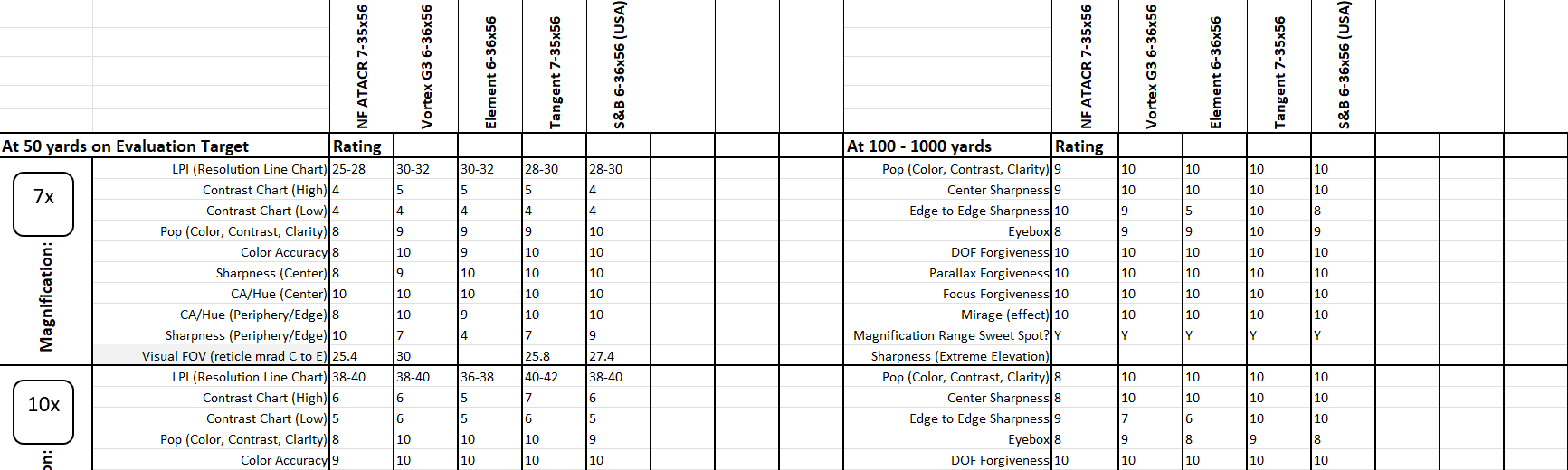

I finally published my Alpha Class High Magnification 6-36/7-35 FFP Scope Review over on ILya's site:
I would like to provide a Snipers Hide summary but want to include some fancy charts based on my data points but am having some issues with figuring out how to get the chart to map out correctly, are there any Excel experts here who can take a look at my Excel file and let me know what I'm doing wrong, please PM me if you think you can help.
I'm trying to get a proper line chart that shows the data points and scope names correctly in the X and Y axis from a sheet that looks like this
