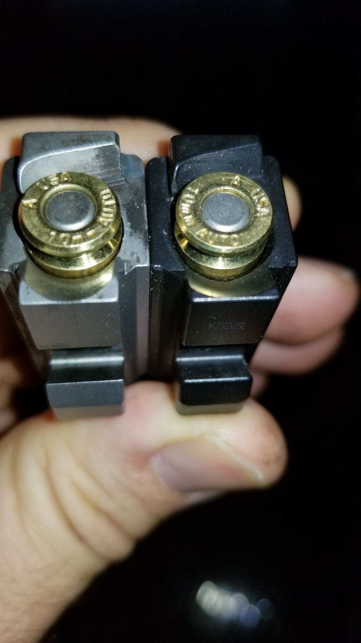

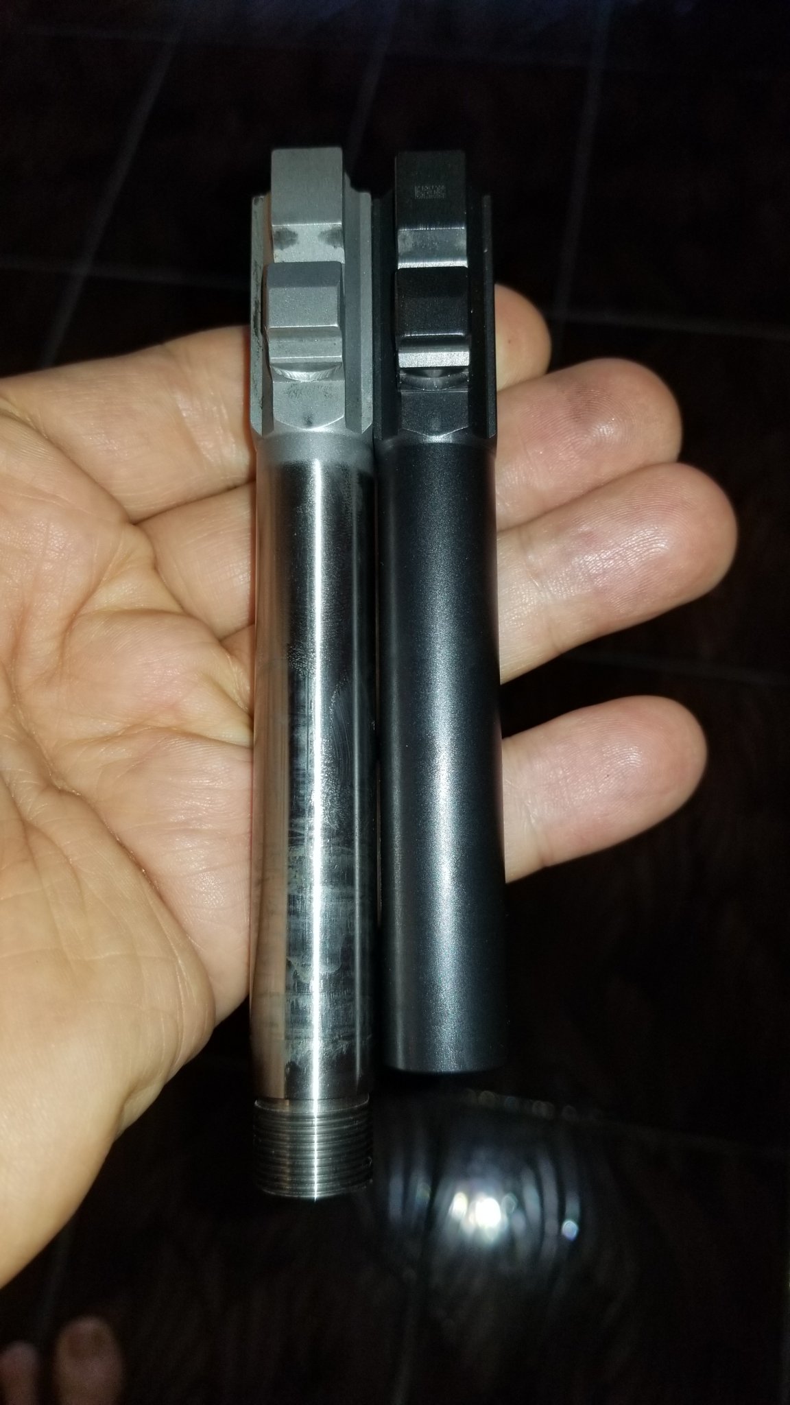

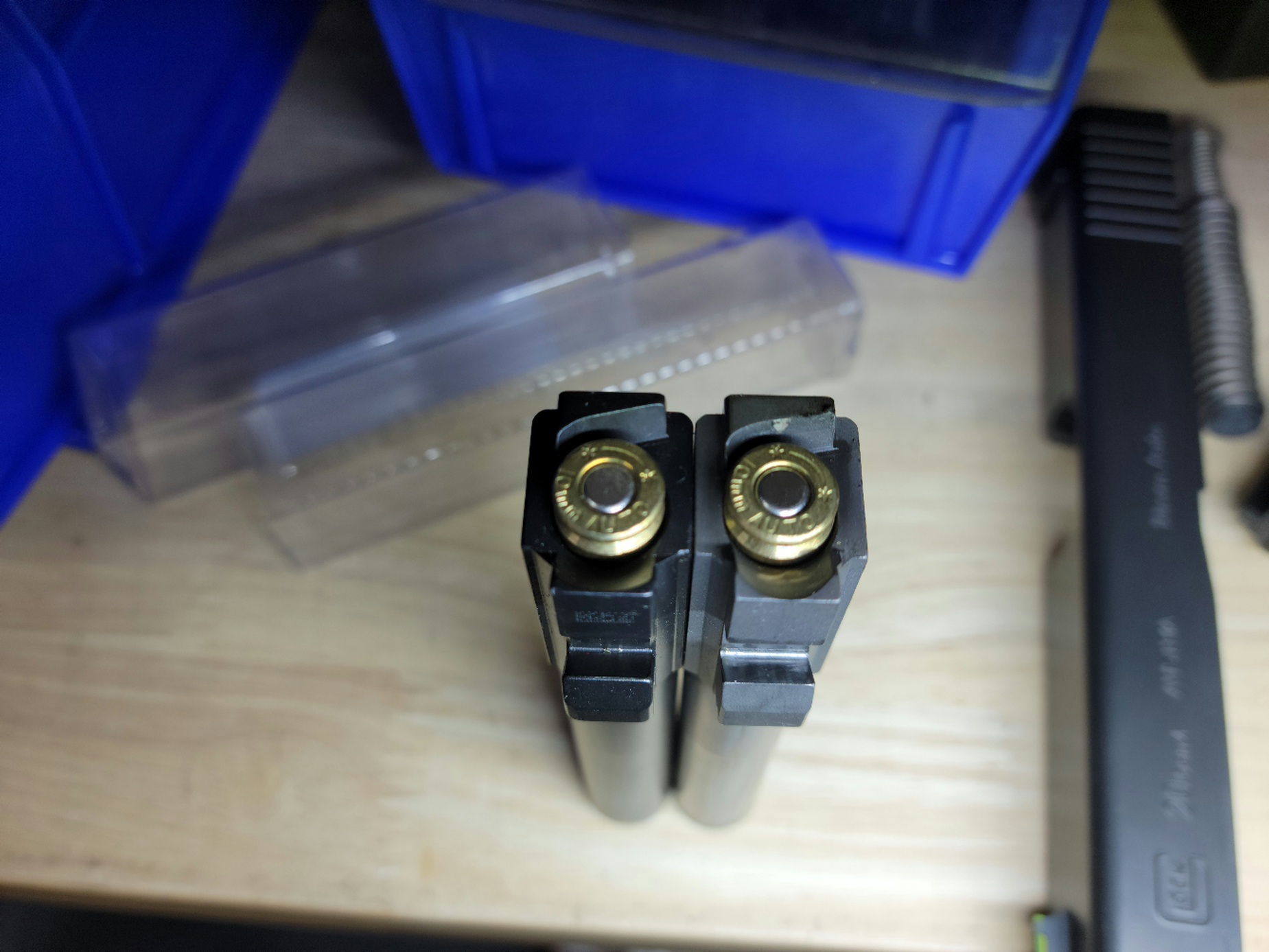

The KKM is fine with them. Here is the factory and KKM side by side. The KKM supports the cartridge wall a little further back and has a tighter chamber.
From pictures I've found on Google it does look like Glock has moved to more support over the years.

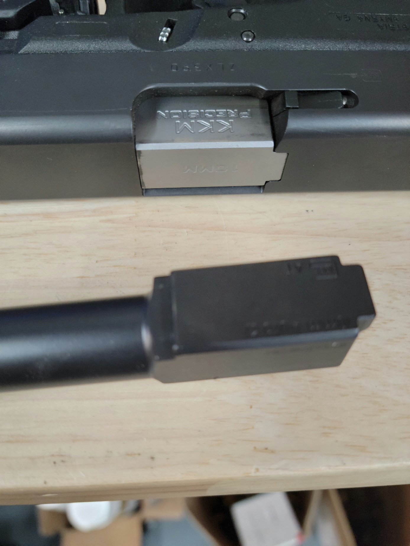

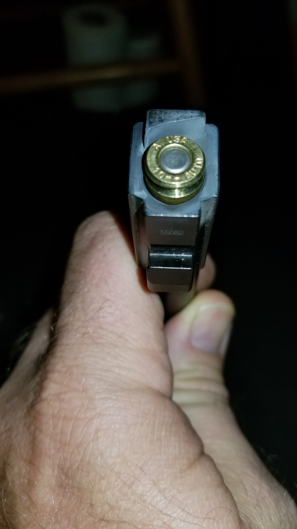

The very first response in this thread was from someone with a Gen 4 G20 with OEM and KKM barrel. The KKM barrel is a waste of money unless you specifically want a land and groove barrel. It doesn't offer any better accuracy and the added chamber support doesn't allow you to load any higher pressure since the factory barrel can already handle loads well beyond what is considered safe.

I'm pretty sure my KKM chamber is tighter than the G20 OEM chamber. The case support is close to the same when compared to the GEN 4 barrels. Also the KKM barrel with it's traditional land and groove rifling allows the shooting of cast lead bullets. Not sure if it's still the case but at one point Glock was discouraging shooting non jacketed bullets through their hexagonal barrels.
