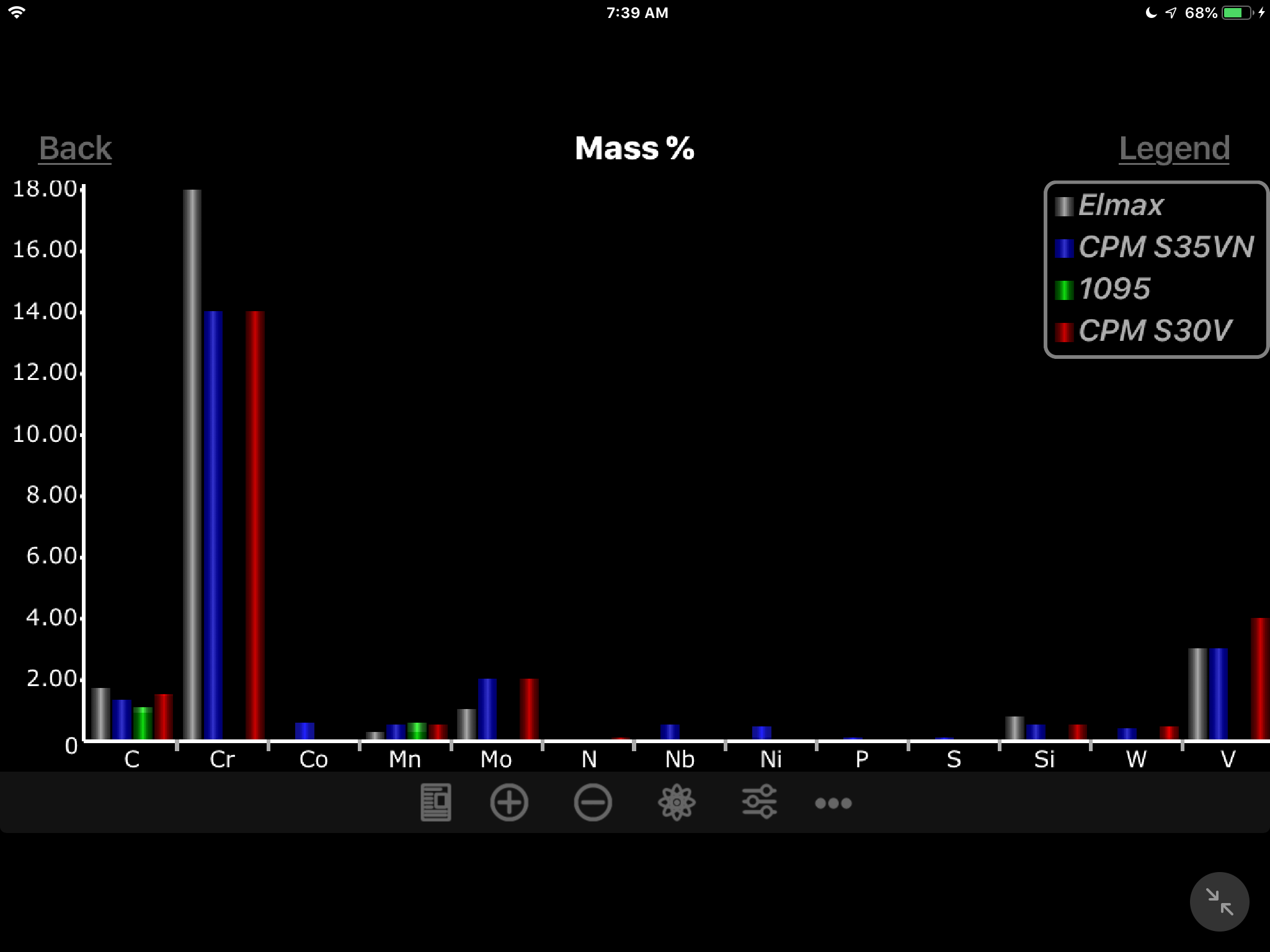

    I prefer S30V for a good outdoors blade that I want to remain sharp and be rust resistant. S30V would be my baseline for toughness, stain resistance, and edge retention. I love carbon and tool steel blades for toughness but they're less rust resistant.
    I use 3V, Carbon, and 154 CM blades a fair bit outdoors. Each can get the job done. I've used M4, 1095, D2, BD1, H1, S35VN and a ton more with good results.
    If you want nearly rustproof you're going to have to settle for H1 (I know there are others, but that's the one I know) and not many people do H1 in their blades because it's difficult to machine properly.
    What you're probably wanting is a high quality stainless fixed blade with a coating of some sort to further inhibit oxidation. Benchmade (which I won't buy) make several hunting options in S30V that fit the bill of what you're looking for.
    There are many many good options out there.
    I am not a fan of 1095 for various reasons. That and D2 are both steels I feel are grossly overrated. That is just my personal opinion having nothing to do with rust. I know the 1095- jesus will have a bird.
    As mentioned S30V and also S35VN are fantastic stainless steels that perform well. A steel I really like that is controversial Elmax which if memory serves is a powdered steel. It’s reputation seems to have unfairly taken a hit because of some knife-maker heat-treat problems in the beginning that were corrected.

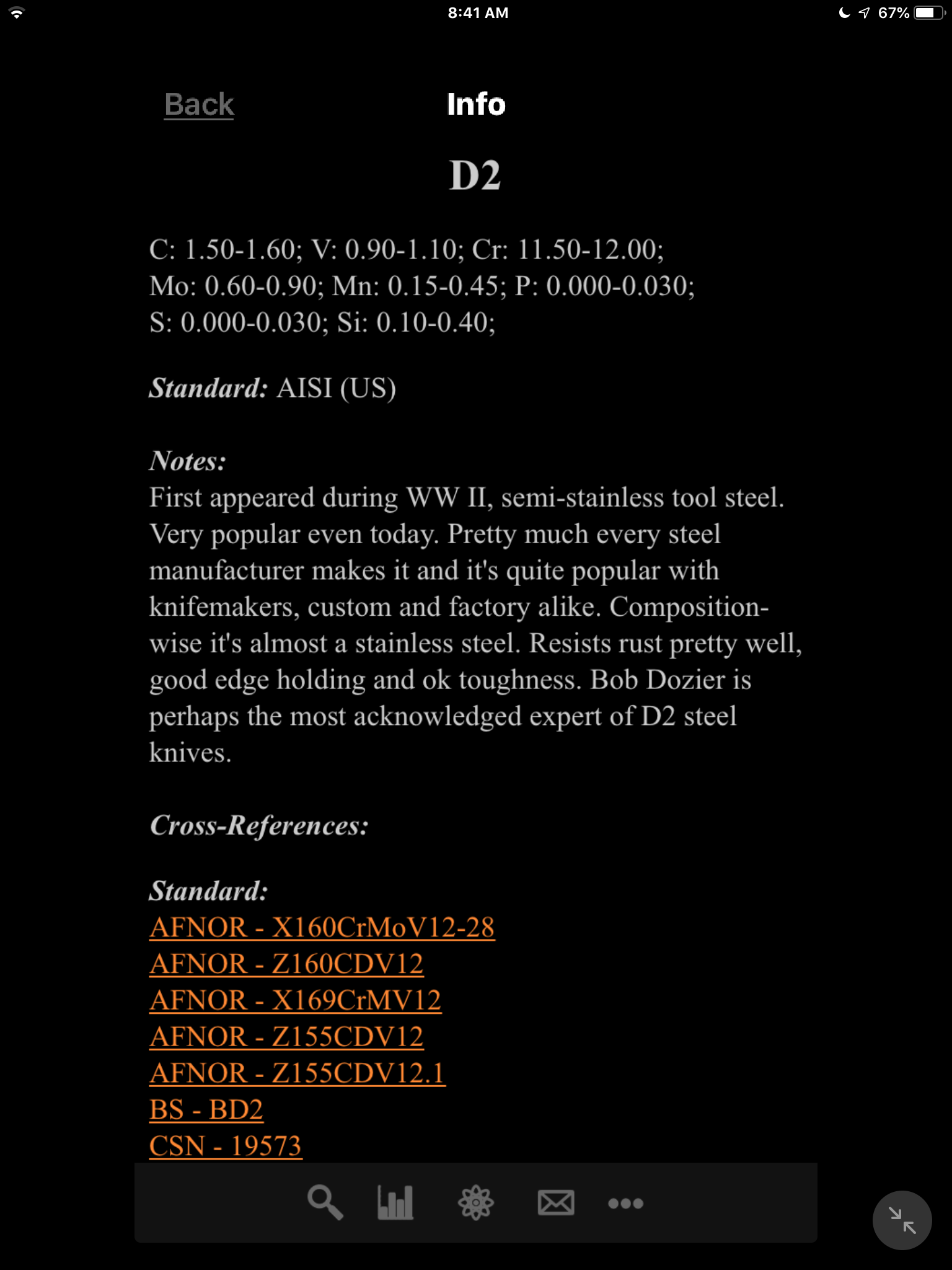

    I don’t buy Chinese blades. (Now I pissed off the Chinese midtech Reate- jesus folks.....) I’m talking benchmade etc. I know a lot of folks love D2 and there is the D2-jesus crowd but I am talking about the specific qualities of the metal. I have a wicked edge pro and not only deal with my own blades but those blades friends want sharpened, beyond anything they have ever experienced before. I just think with modern metals and powder/ spray forming, when it comes to grain size, corrosion resistance, edge retention and carbide distribution, there are much better blade steels.

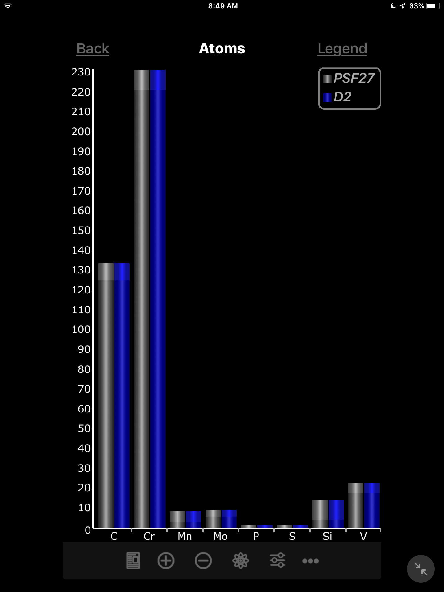

    BUT having said that, I LOVE PSF27. Same steel as D2 but using spray form technology. Holds an edge better and is reportedly much tougher. This is due to smaller grain structure and more evenly distributed carbides from the Carpenter Steel’s spray forming process.
    D2 has been around since WWII and if you like it, no one can tell you that you are wrong. Steel choice can be very subjective.....

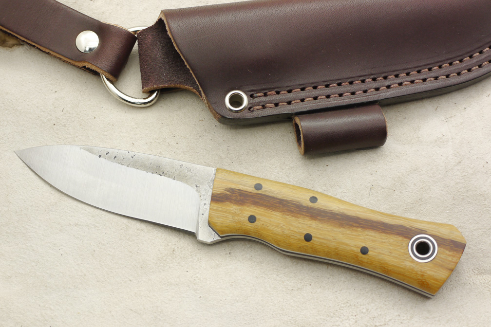

    I'm a little biased because I make knives, but I carry this most days. Still not sold on the handle color, but I don't feel like making a new one. It does need black oxide screws, though.
