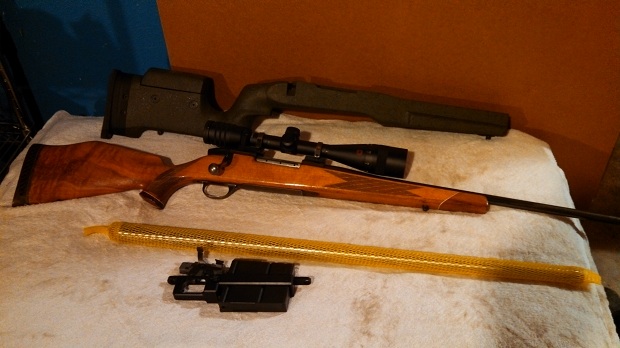

The parts so far
B&C stock
Donor Mark V
Bartlein Barrel
Specifications:
Caliber: .338 5R
Twist: 1-9.5
Length: 28" Finished
Contour: #9 1.25" x 5" Taper to 0.900" (7.45 lbs)
Bore/Groove: .330/.338
LRP Bottom metal
Wyatt mag
Some testing last night, that's why the trigger is removed, the mag allows 3.772 length

I changed the barrel profile and brand to a Benchmark Heavy Palma. It's longer and fits the barrel channel of the stock better.
If I like it, there is a Wby Mark V in 338WM that will get 'upgraded' to be a 338 Edge hunter. I'll use the Bartlien barrel for that.
