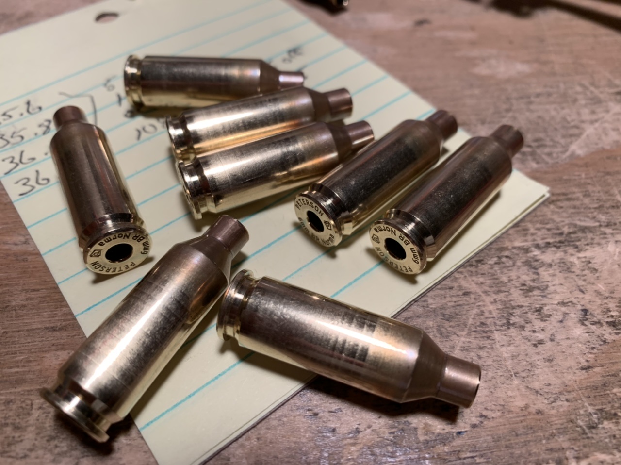

    6BRX brass been fired 4 time tumbled a week ago for 1hr after sizing
