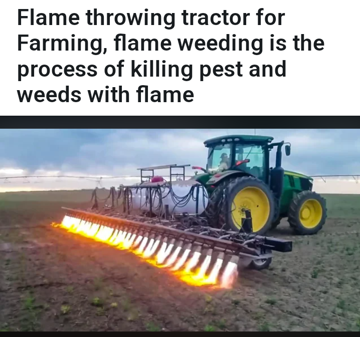

Ag Flamer...
There's also a smaller version that could be mounted to an ATV..
Plumbing+location=Tank mounted+valve&Size=30in
