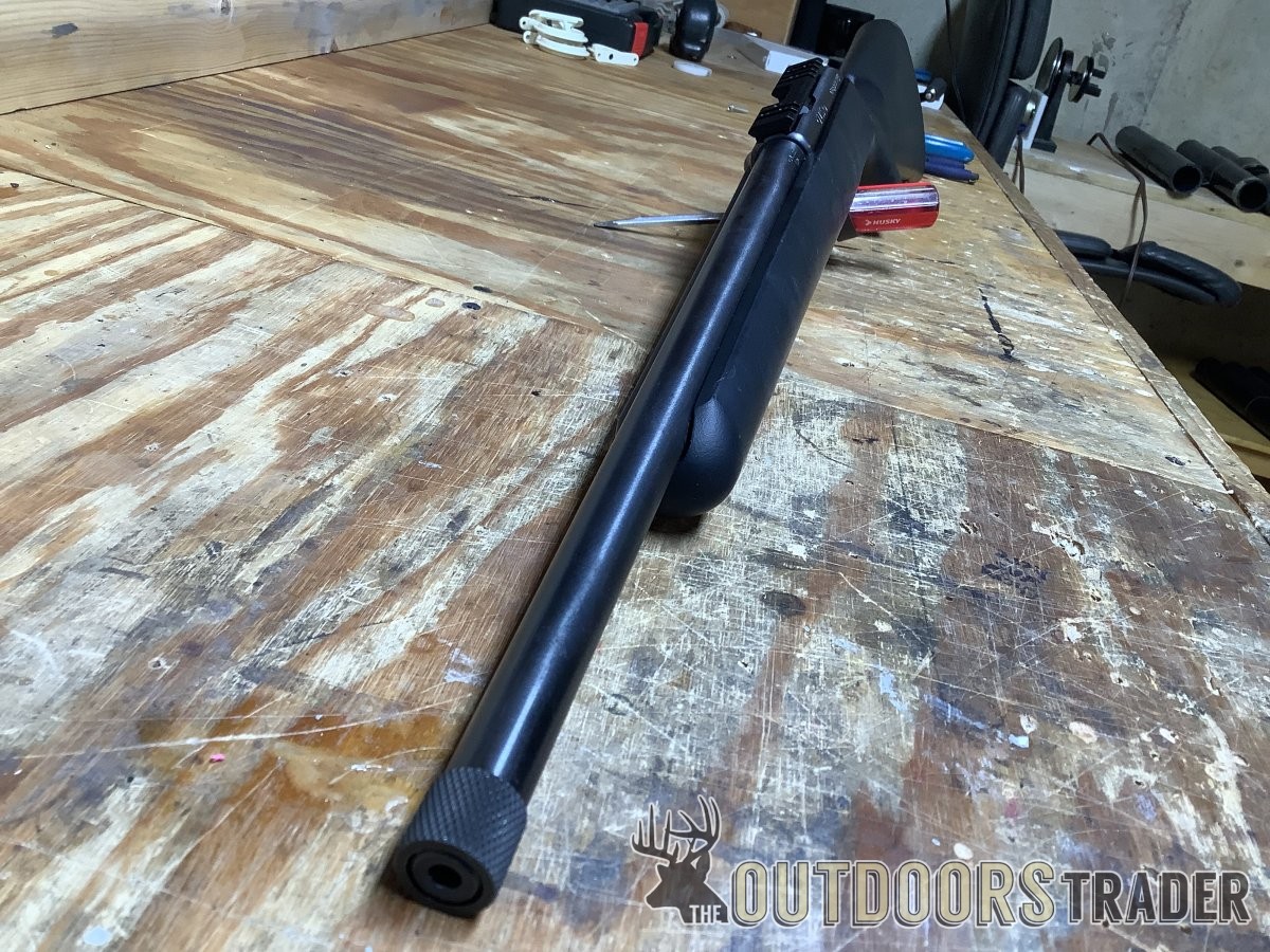

Took it apart today. Perfectly clean except for the oil in it.
Brake cleaner and set in the sun. In the top of the receiver are some white streaks from where the bolt and charging handle ride. I used a green scotchbrite pad and a screwdriver to clean up the streaks and just smooth them out a little.

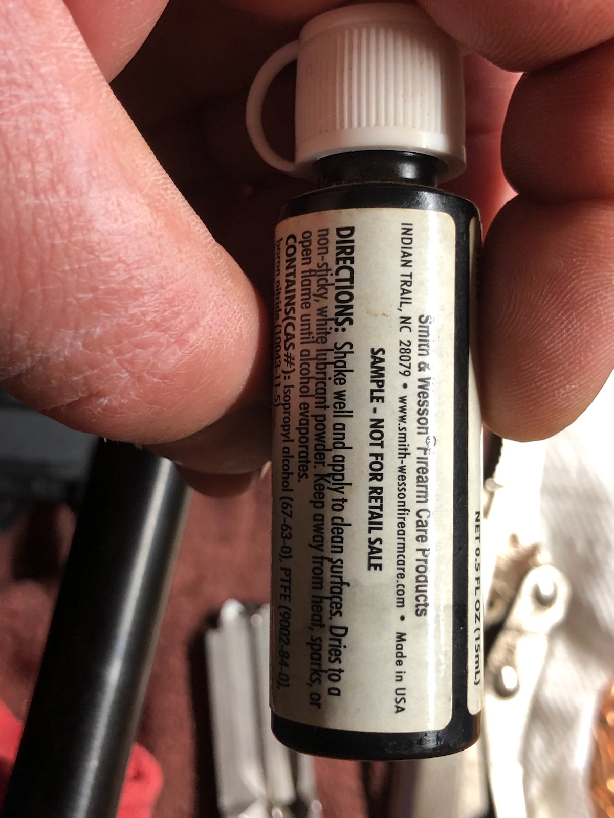

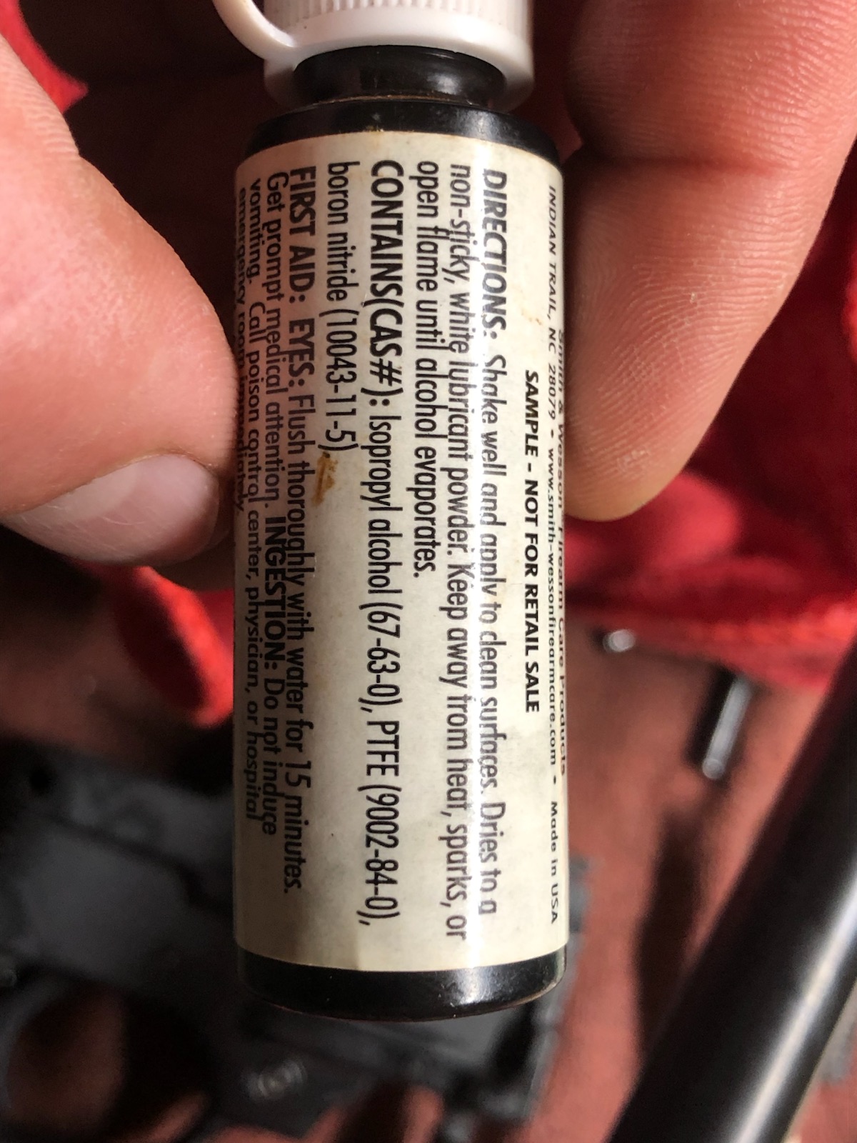

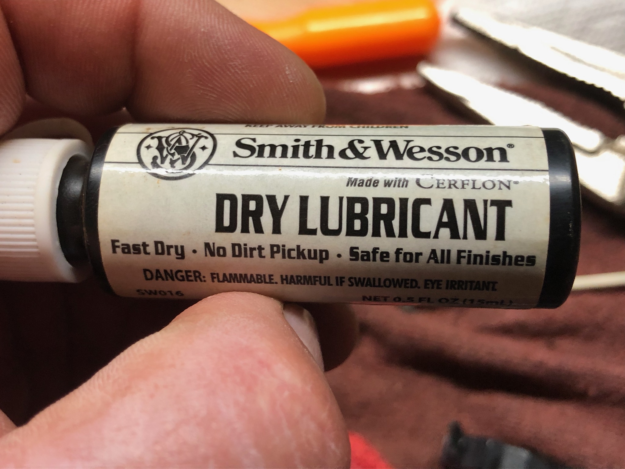

I dug through my stash and came up with 2 bottles of Smith and Wesson dry lube that I got at a NRA dinner years ago. A few drops on the guide rod and where the charging handle and bolt ride. cycled it a few times. Cleaned out the trigger and put dry lube in it too and cycled it a few times. Put it back together but have not shot it yet. I'll take it out and run all 4 mags full through it tonight. Two 10 rounders and two BX 25 round mags.

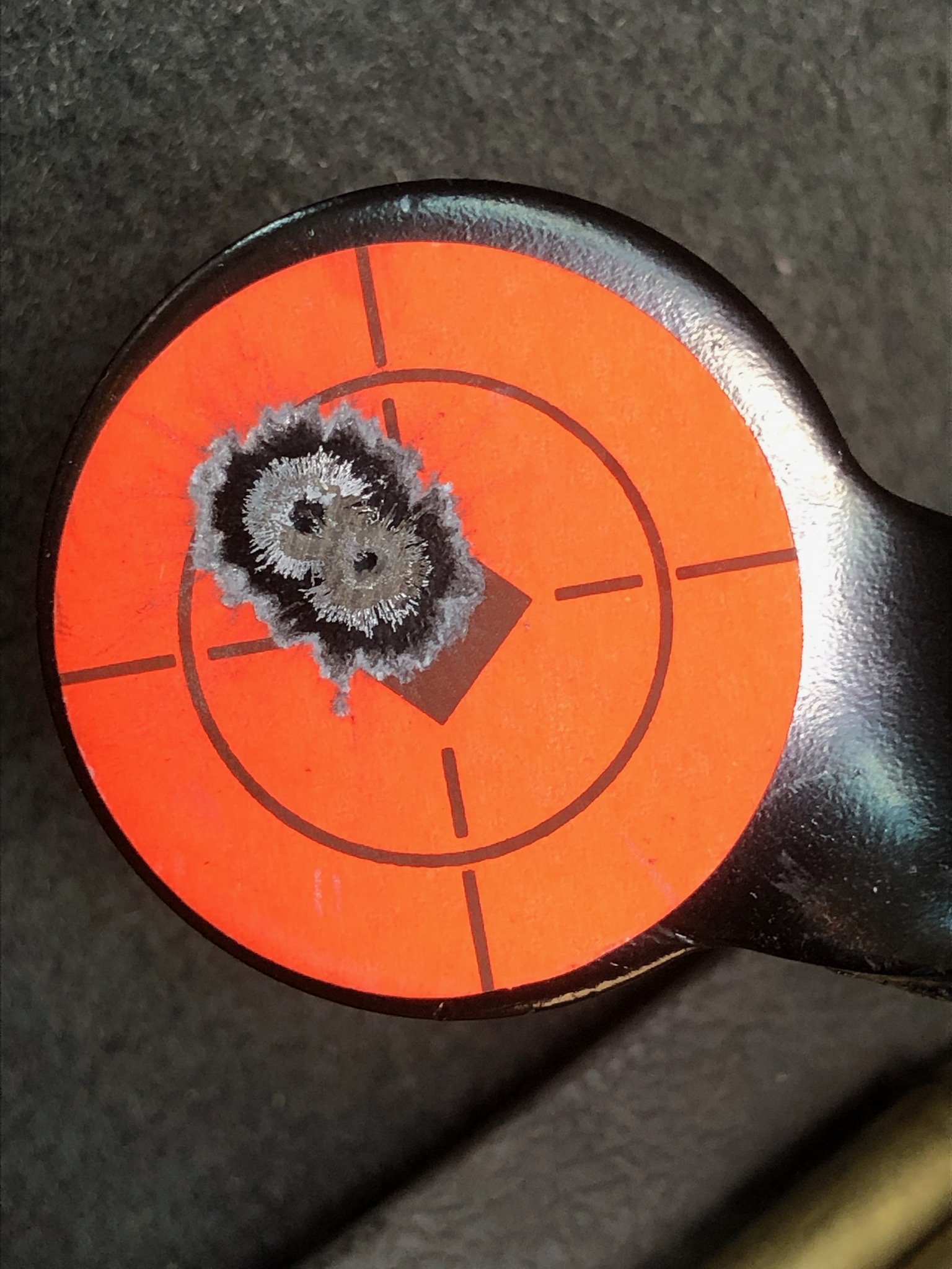

So Saturday night we went out and shot to confirm zero and dope from 50-110 with the 22 bolt guns for a match next weekend.

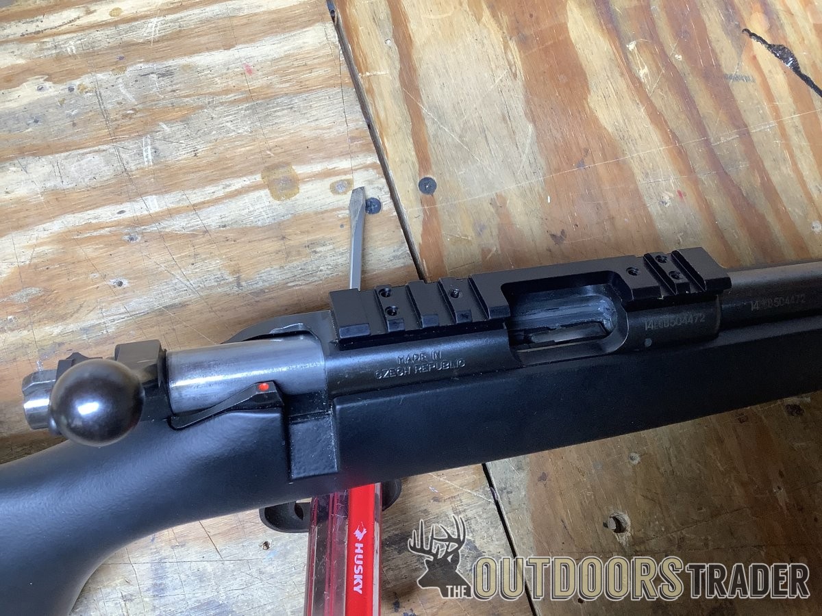

So a friend of mine has loaned me a rifle to shoot for a while. Its a CZ 452 Varmint.
Shot it a few times and found this gun won't eject correctly either. I really thought he was messing with me bad.....
Ended up pulling the extractors out and cleaning them and its fixed.

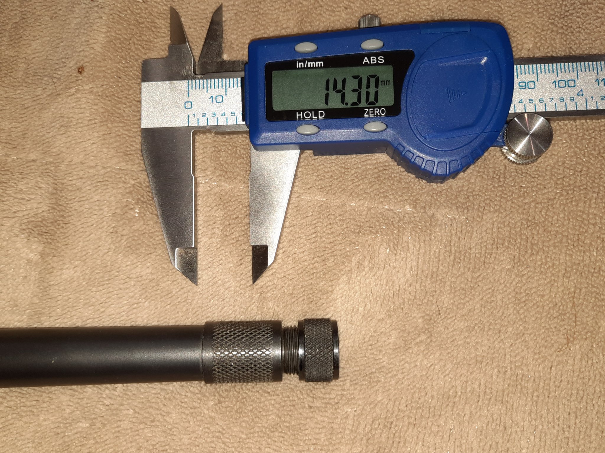

I would verify that it has 1/2x28 threads... Most CZ rifles come with weird Euro threads like 1/2x20... So I would confirm thread pitch before trying to screw on a suppressor. 👍🏼

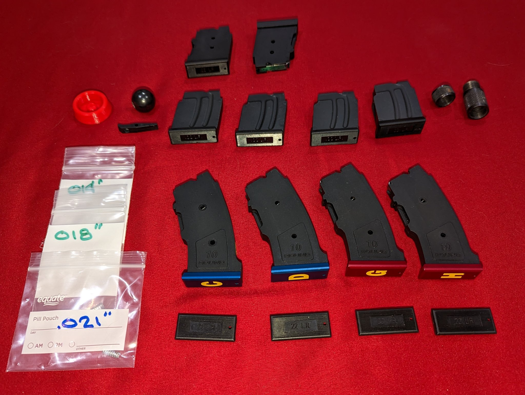

new spring. McMaster Carr #9657K611 for the .014" wire spring or the Yo-Dave size, .018" wire #9657K612.

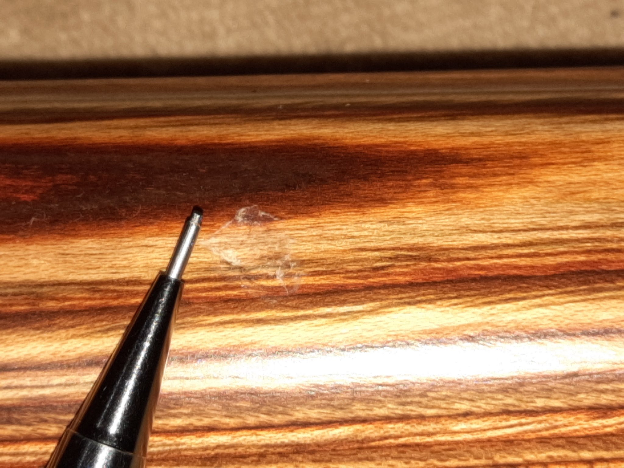

need do is enlarge it and tap it for a #6-32 long nose spring plunger. The plunger number is McMaster Carr #8495A11 (get the one with
the nylon thread locker) It takes about 20 minutes to do start to finish. Drill, tap, install, adjust....
It's compressed nose force is 4.5 pounds. It is shown next to the dime in photo #5. It also allows you to have an adjustable sear
in your trigger. The factory trigger is long, heavy and gritty. ( crap! ) I also replaced the bolt knob with a Vudoo knob. The rail is

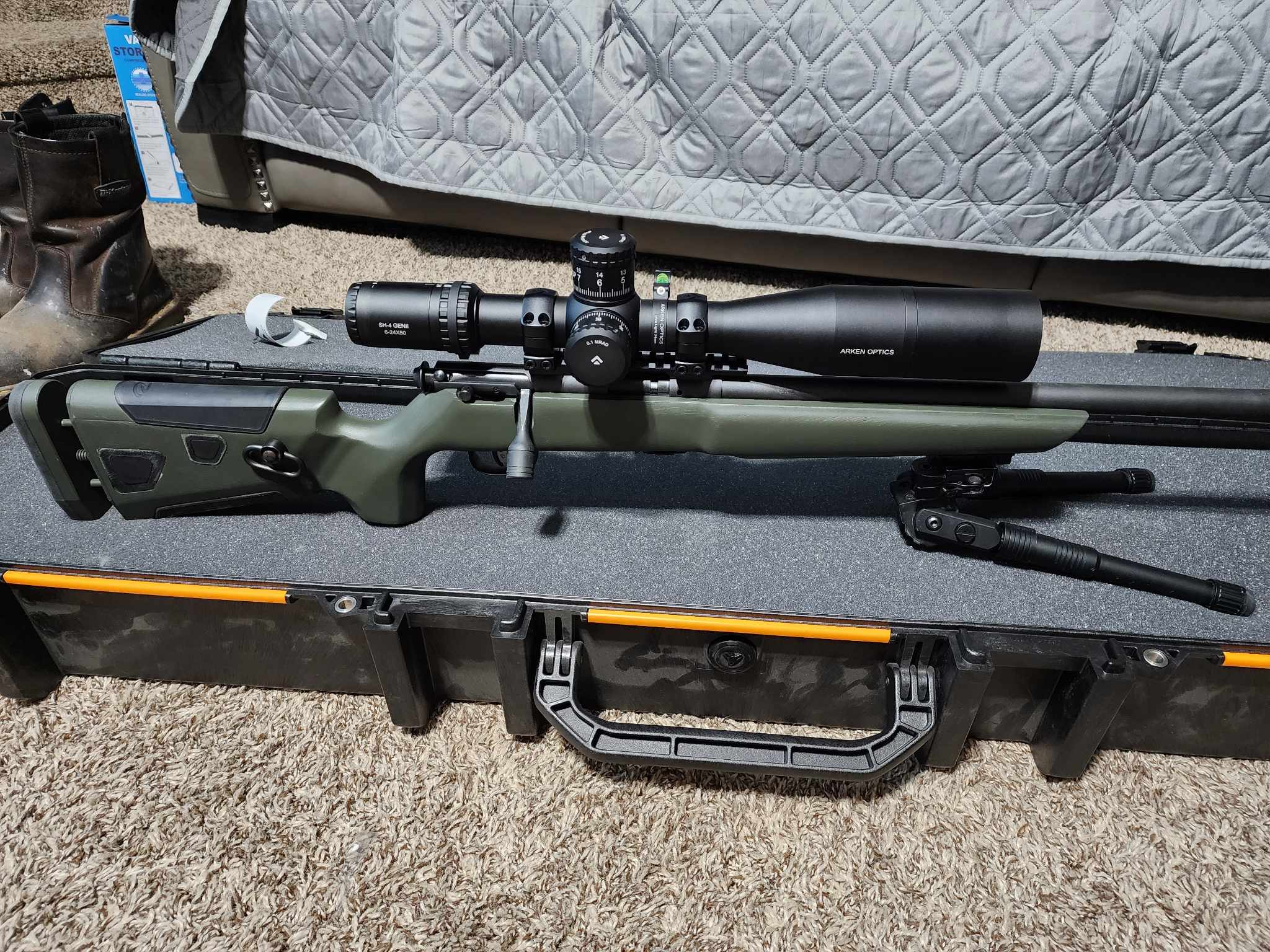

an EGW and about $40.00 from evil-bay. Cheap rings, about $40.00. Junky bi-pod Pic rail adapter. $300.00 Atlas bi-pod. Nice
but pricey.
$2000.00 Trijicon 5-50x56 MOA scope.... Custom parallax wheel to use scope as a range estimator. I'm not allowed a stand alone

FuhQ, Has given everyone prudent advice. Check the thread dia and pitch.

All 3 of my 457s have 1/2-28 threads for any device that I may want to add to your muzzle here in the USA. .
The exception being my 457 Royal. It has 1/2-20 threads and will need an adapter. My Royal was one of the first one's brought
into the USA so CZ America may have changed the thread pitch to match by now. I bought an adapter from Evil-bay for
about $20.00 but it looks like an afterthought and it took time to find it and get it into my hands. ( see image #1 )

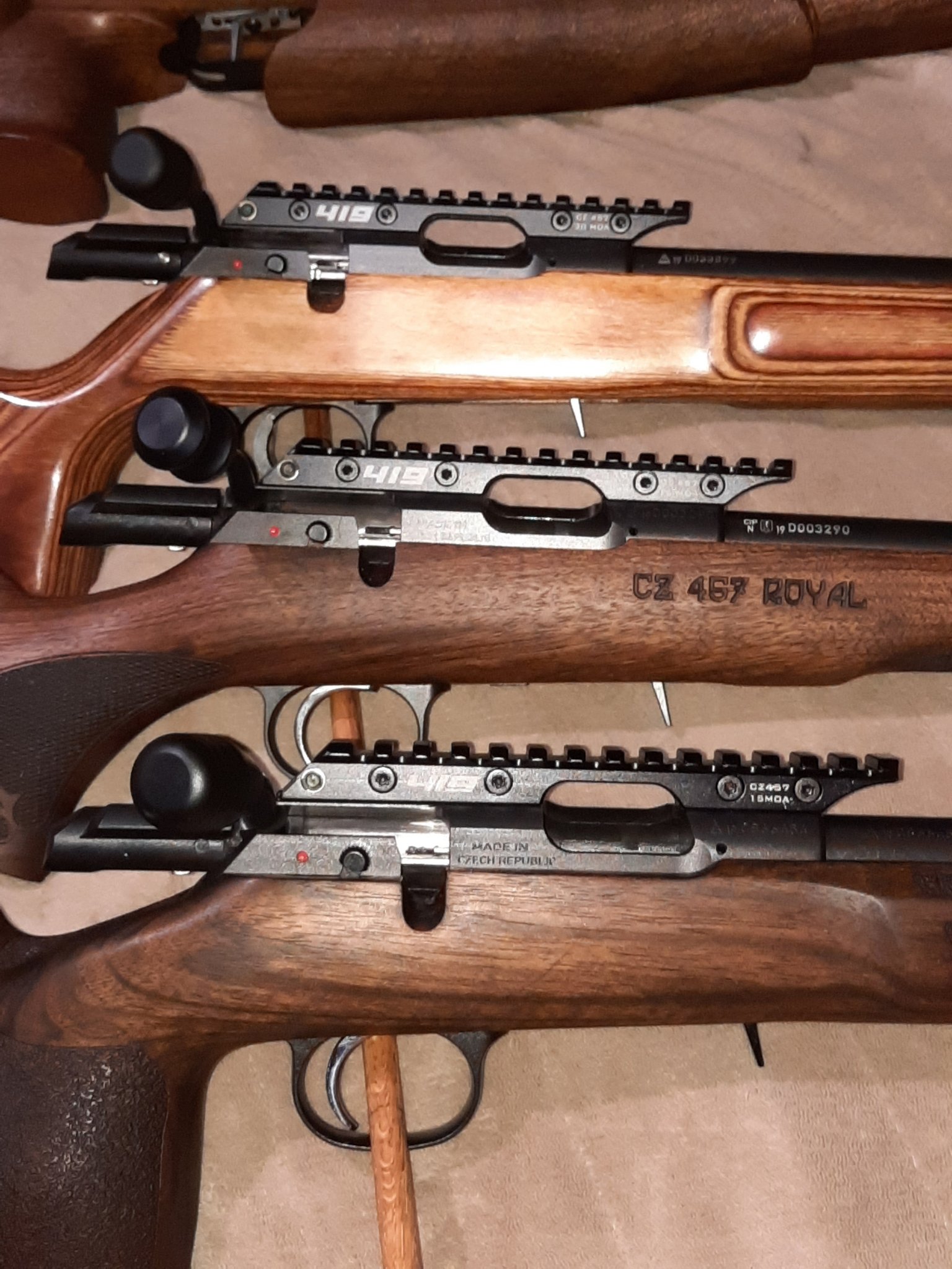

My three CZ 457s have AREA 419 rails because they clamp onto the dove tail securely. Other rails require set screws being driven
down onto the receiver. I spoke with Bob at DIP and he suggested putting #7 lead shot under the set screws to prevent damage.
If you were to use brass tipped set screws you will find out that they will leave yellow-ish skid marks on the bluing. Even if it
doesn't shift the screws rotate as they are torqued.

Lap your 457 trigger blade sear and replace the spring and that will yield substantial benefits and be a great interim solution.
The 457 trigger can go as low as 7 ounces. It will also remove any gritty feel and it will break crisp and clean. McMaster # 9657K611
( .375" long x .148" dia. x .014" wire dia. )
