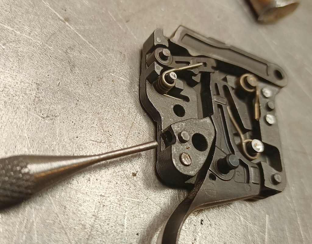

new spring. McMaster Carr #9657K611 for the .014" wire spring or the Yo-Dave size, .018" wire #9657K612.

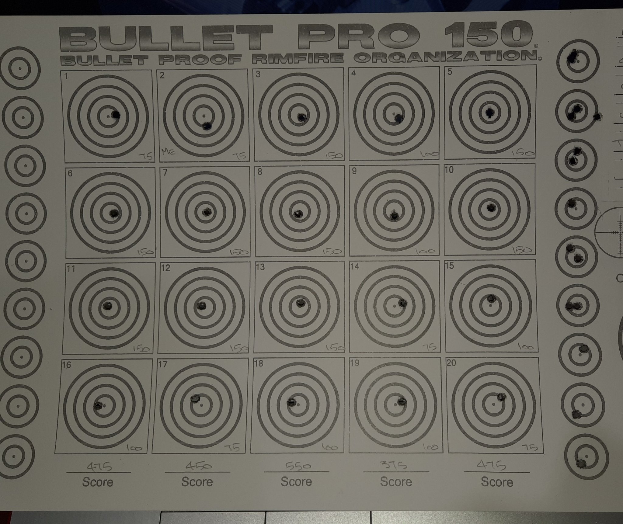

a $5.00 trigger mod my B14R is all I need. It's about the only rapid fire bolt that I shoot. The trigger already has the hole so all you
need do is enlarge it and tap it for a #6-32 long nose spring plunger. The plunger number is McMaster Carr #8495A11 (get the one with
the nylon thread locker) It takes about 20 minutes to do start to finish. Drill, tap, install, adjust....
It's compressed nose force is 4.5 pounds. It is shown next to the dime in photo #5. It also allows you to have an adjustable sear
in your trigger. The factory trigger is long, heavy and gritty. ( crap! ) I also replaced the bolt knob with a Vudoo knob. The rail is

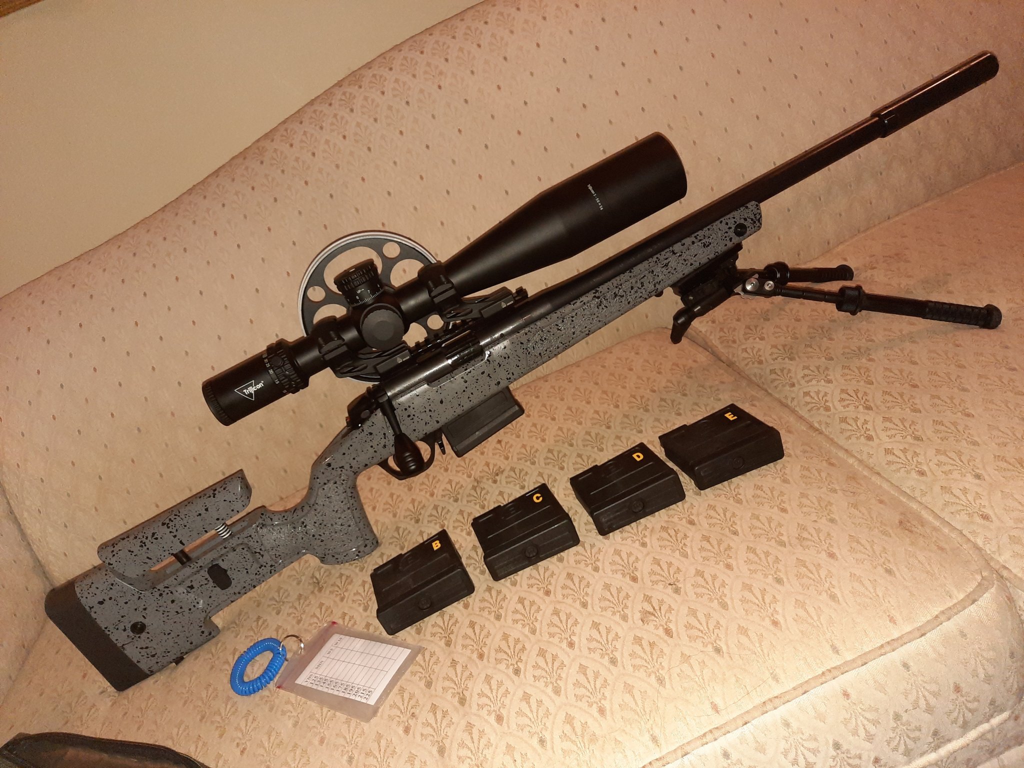

an EGW and about $40.00 from evil-bay. Cheap rings, about $40.00. Junky bi-pod Pic rail adapter. $300.00 Atlas bi-pod. Nice
but pricey.
$2000.00 Trijicon 5-50x56 MOA scope.... Custom parallax wheel to use scope as a range estimator. I'm not allowed a stand alone
range estimator in FT comps and all of the distances are unknown. FT is basically simulated hunting.

Have you cleaned your magazine?
You are still using the 10 round, not those POS aftermarket 25s, right?
The factory mags can be disassembled, cleaned and put back together. They also have a feature that allows adjustment of feed pressure of the cartridge.
Also, I'd recommend a complete disassembly of the rifle so you can get the trigger and bolt properly cleaned.
I agree clean the magazines and trigger.When I run into a mag problem i will fill it up with lighter fluid and let it soak for 10 minutes and run a small rag inside of it to get the junk out.I use factory 10rd mags.

I've got 2 factory 10 round mags and 2 BX25 mags. I'll clean the 10s, the 25s are new.
I will take it apart again and clean it out. There is ZERO dirt in it. I've cleaned it really deep. But I will get all the oil out and re lube it with CLP or Hoppes oil. Both here, I'll try one and then the other if needed.

Thank you all. I'll clean up, retest and report back.

I agree clean the magazines and trigger.When I run into a mag problem i will fill it up with litter fluid and let it soak for 10 minutes and run a small rag inside of it to get the junk out.I use factory 10rd mags.
Lighter fluid is really just Naptha. You can get a gallon of the stuff at your local big box building supply or Ace Hardware for not much more than that little bitty can of Zippo Lighter Fluid costs.
I use Naptha every time I clean any of my firearms but won't bore you with the process or the reasoning.

and try one fix at a time, starting with the free stuff. There's a number of reasons your 10/22 won't run, but luckily, none of them are hard or expensive to fix.
One of the first things you learn on Rimfire Central is DRY lubricant such as Hornady One Shot is your friend. 10/22's usually don't like to run wet. Another is scrubbing out the inside of a factory receiver with a scotchbrite pad makes for a smooth action.

I'll reiterate, it's not an AR.
Skip the wet lubricants.
Again, skip the wet lubricants.
They will just gum up the works and collect dirt, carbon and debris.
Dry lube, or no lube.
If you absolutely insist on lube, just get some dry graphite for it.

Many years ago I had a Ruger 10-22. That's about 40-45 years ago. Those little Rugers have really been around for a long time.
Firstly I found that the trigger sucked (heated the end of the spring and collapsed it a couple of coils! Yeah, rough as guts...but no worse than chopping off a couple of coils). These days you buy a nice new spring to lower the pull weight or buy a new trigger system.
Then the 'barrel band' didn't help accuracy (tossed that away and glass bedded the action/first 1" or so of barrel). Cut the forend wood back to a more sporter shape as barrel band was never going back on the rifle. My barrel band was metal, the newer ones are plastic...throw it away. They suck more than gravity too.
Then I found a US shooting magazine with full description of polishing all the action parts.
I used 1200 grit 'wet and dry' paper, plus a fine oil-stone and slicked up all the action parts. No other mods done as back then there were no add-on parts available in NZ (fancy new extractors, firing pins, etc).
Now, that polishing did a great job.
I now had a very accurate 10-22 that functioned smoothly and all it needed was a bit of fettling.
Check out You-tube for lots of videos on stripping/polishing the action.
As for using motor oil! No way.
Others have already pointed the way to go there. You mentioned Hoppes oil? Is that just the Hoppes No.9 you are meaning?
Well it's the right oil for the wrong job. Yeah, get the dry lube. Some spray on silicon lubes work well with metal. Spray on, let it dry and a tiny layer of silicon sits in/on the metal bits.
What ammo are you using? Some bulk stuff from Joe's Garage would probably not be helping either.
I used the scotch brite on my factory 10/22 rifles also.
One other thing you might look at is the barrel retainer screws and make sure they are tight.Many years ago i had them come loose on a 10/22 carbine.
