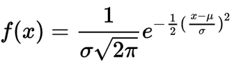

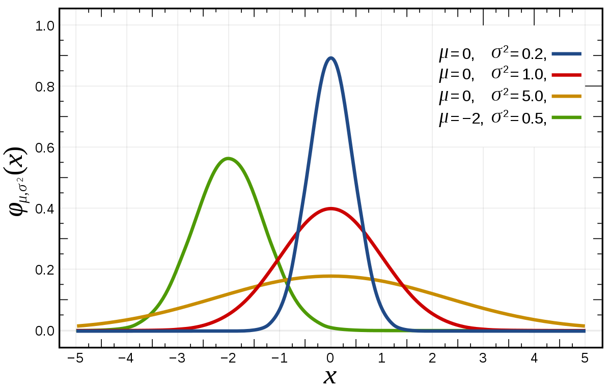

Standard Deviation is the width on a Normal or Gaussian Distribution. The formula is:
sigma is the Std Dev. mu (the u thingy) is the mean).
Its a complicated formula, but just know that sigma controls the width, and mu controls the location:
