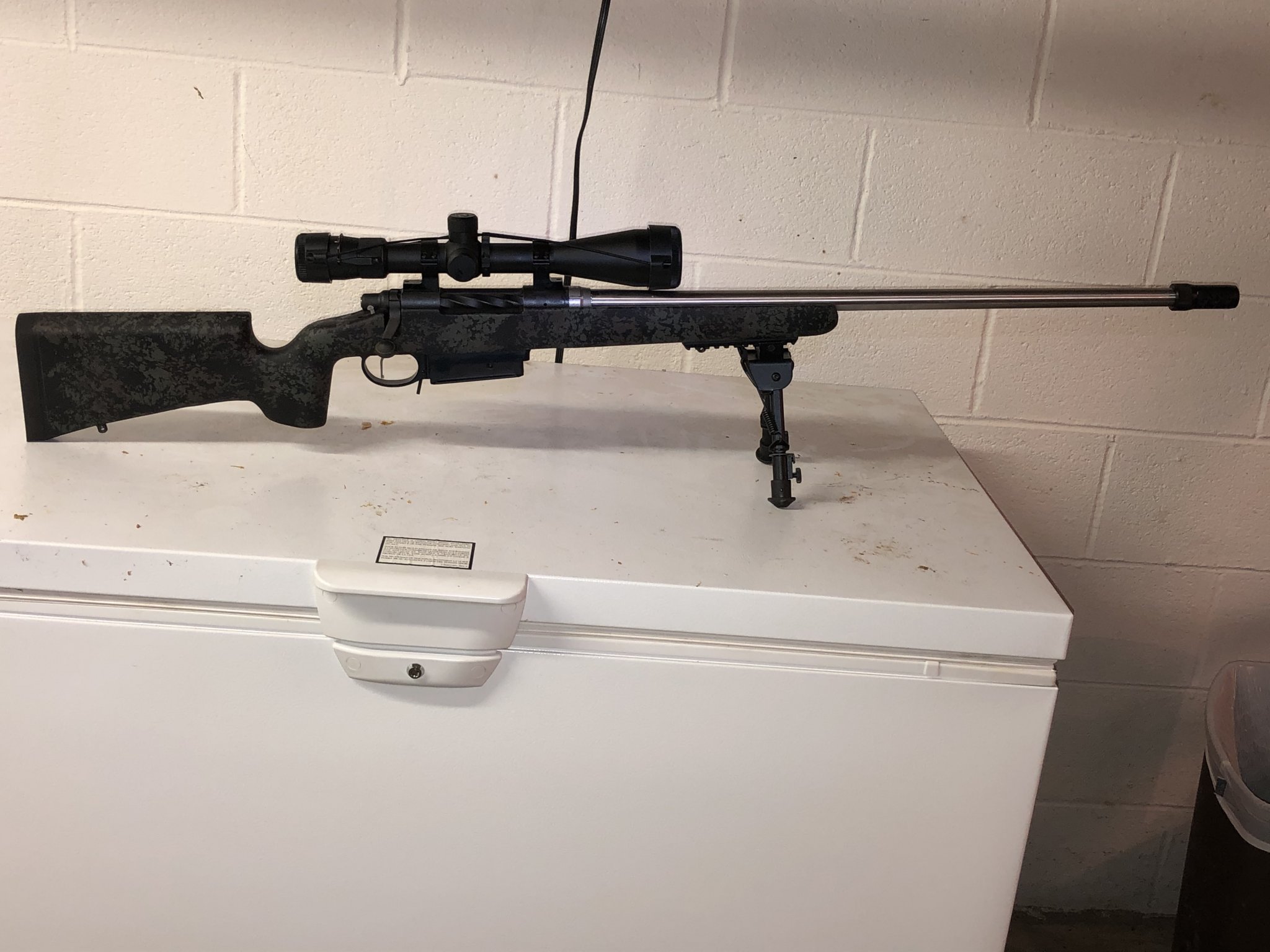

This was a renegade I shaped by hand. It still isn’t 100% finished but is turning out nice with the extra time. Be aware that you will have to use some sort of body filler to fill air pocket voids once you start removing material from the stock.
