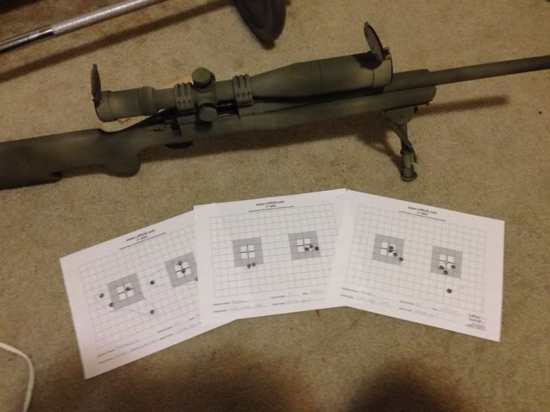

Took my new remington 700 AAC-ad out today. My first bolt gun and first time shooting one. I sold an ar15 to buy it. Also put a b&c stock on before I shot it and painted it. Vortex viper hs-t scope. I sighted it in with ten rounds or so and these are the groups after that. Also a question.. When I installed my scope the eye relief was good.. But when I got out in the field I had to push the rifle out so I was barely shouldering it to get good eye relief. Any ideas? I was prone shooting today and prone when I checked eye relief.. Another thing I learned is I need a sand bag when prone hah. I used my fist. Pretty happy with this setup though. Going to get a karsten cheek rest, better rings, a swivel bipod ( I have a Harris that first swivel and it was a pia today). Any other tips you may have for a noob are greatly appreciated!

Congratulations on the new setup and your shooting ain't too shabby either considering the situation. It's hard to tell from the pic ,but it looks like your rings could each stand to move back one notch on your rail. Most try to center them on the tube.
