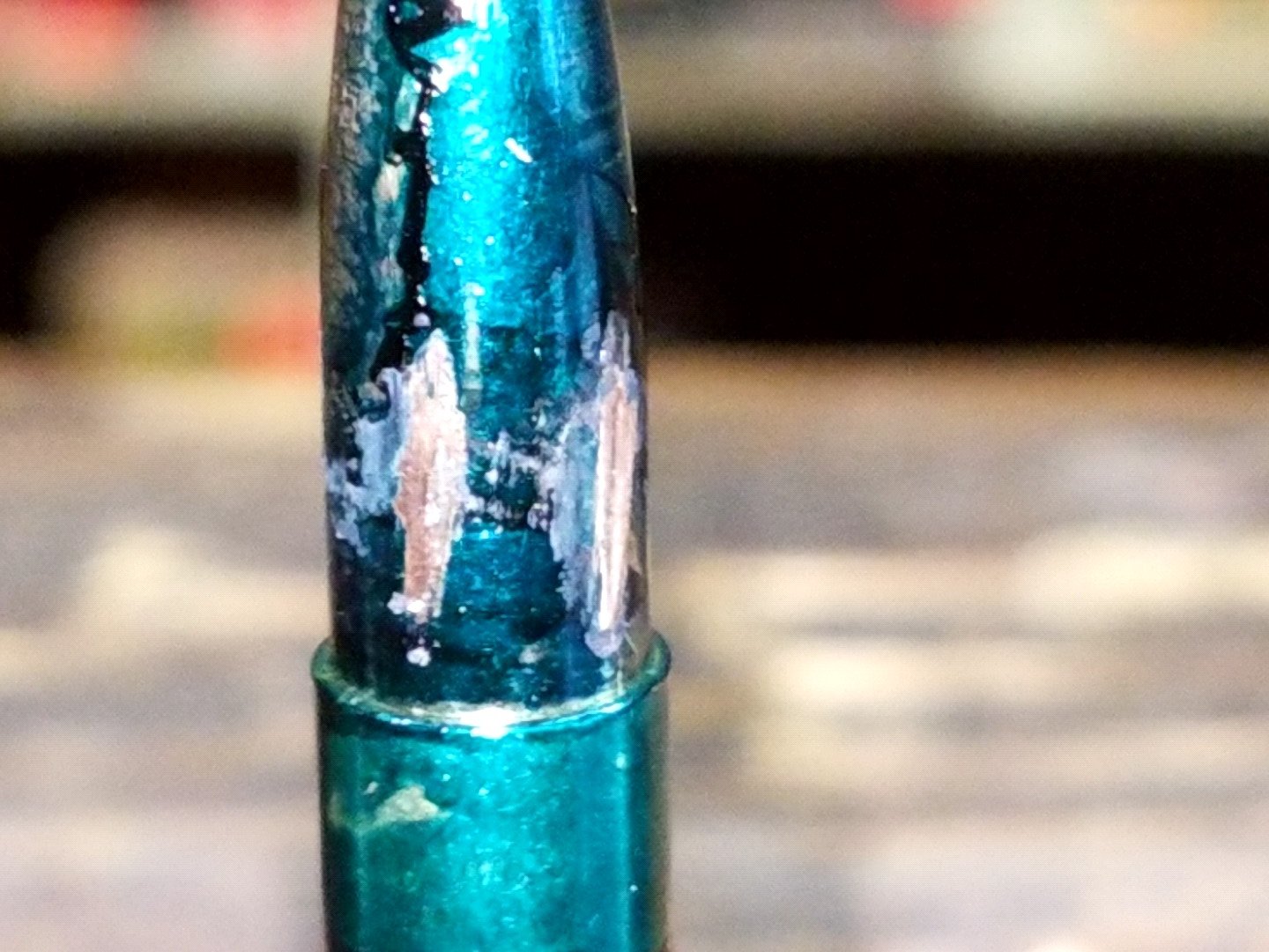

Did you have any issues with chamber throat? I just sent mine back last week as I think theres a good chance I have no throat at all. I've only run Hornady 108ELD's through it and started to figure out why my bolt was so hard to close.
Looks like they've been jamming DEEP into the lands. I've been into another post on another forum and it appears I'm not alone with this issue. Also starting to see reports of some of this same issue with others in 6.5 Creed. Just curious. Thanks in advance.
