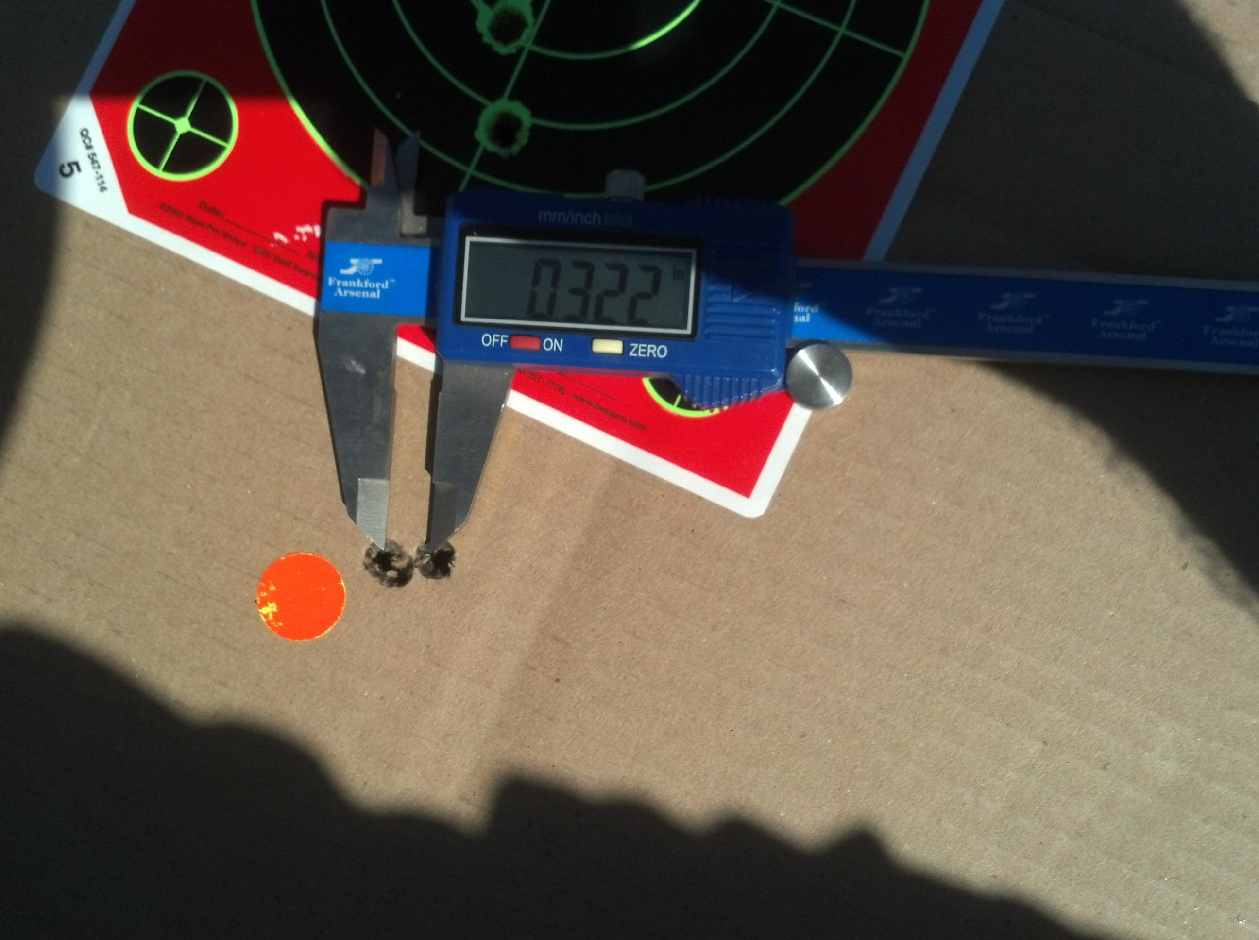

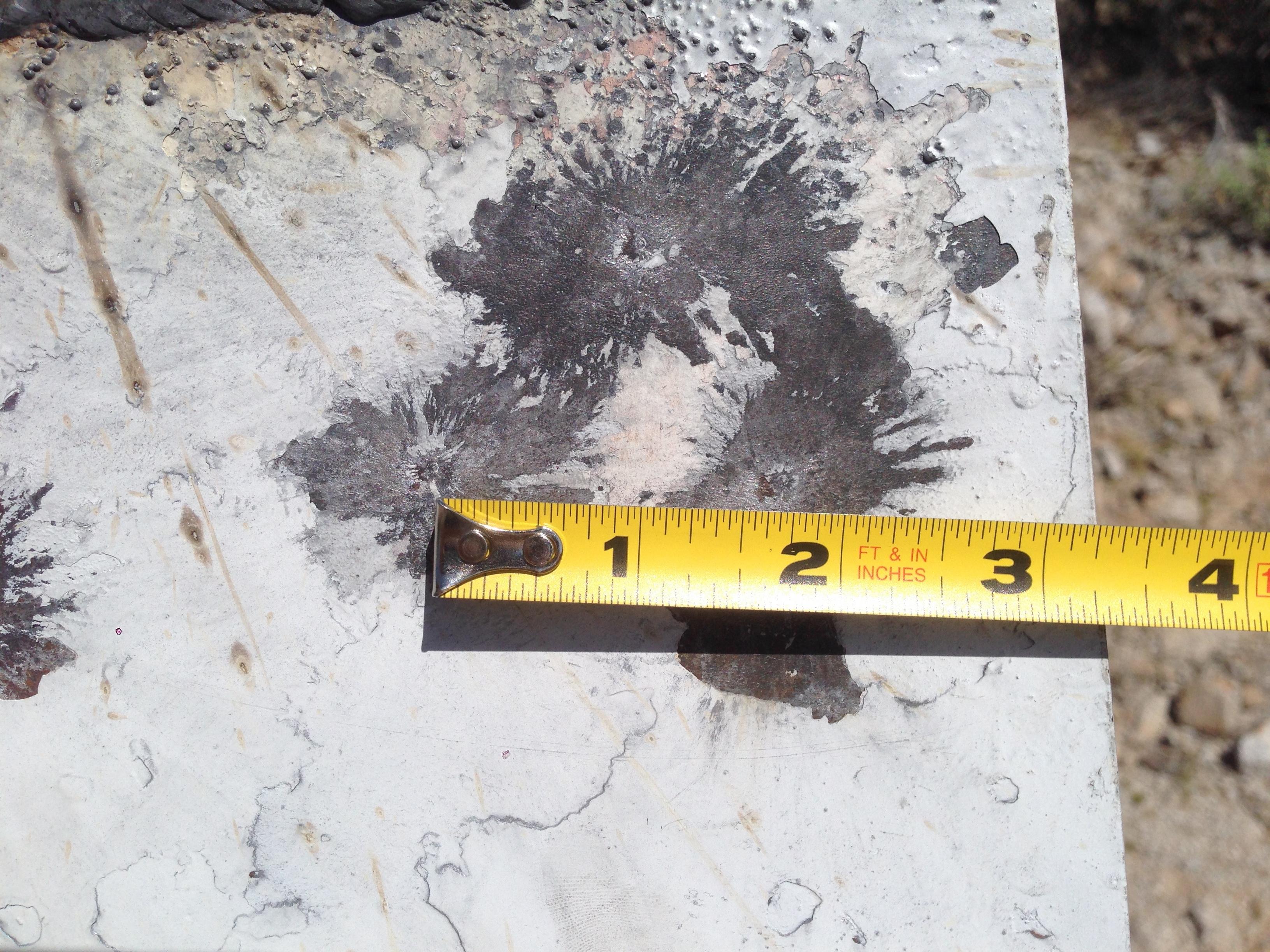

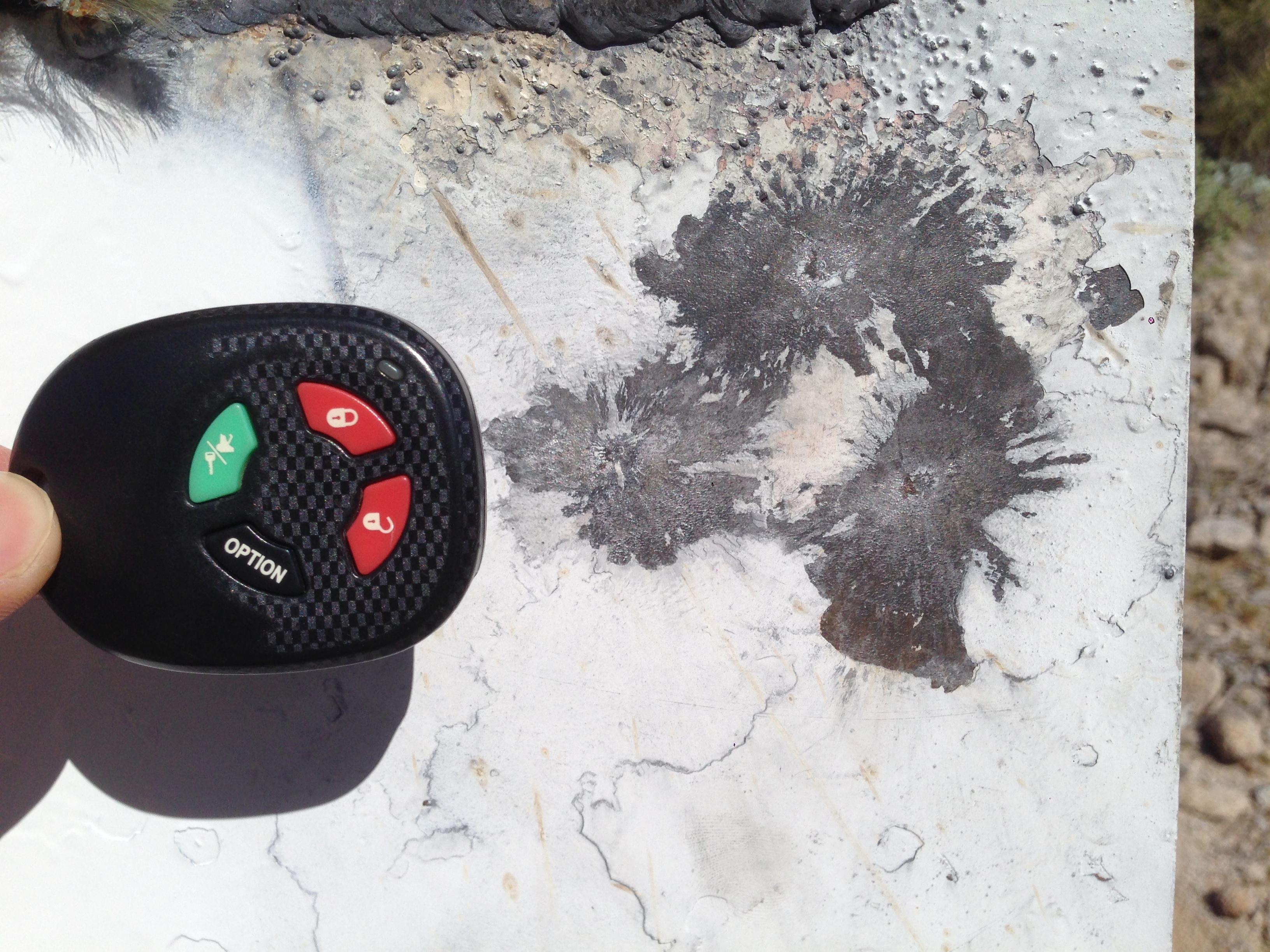

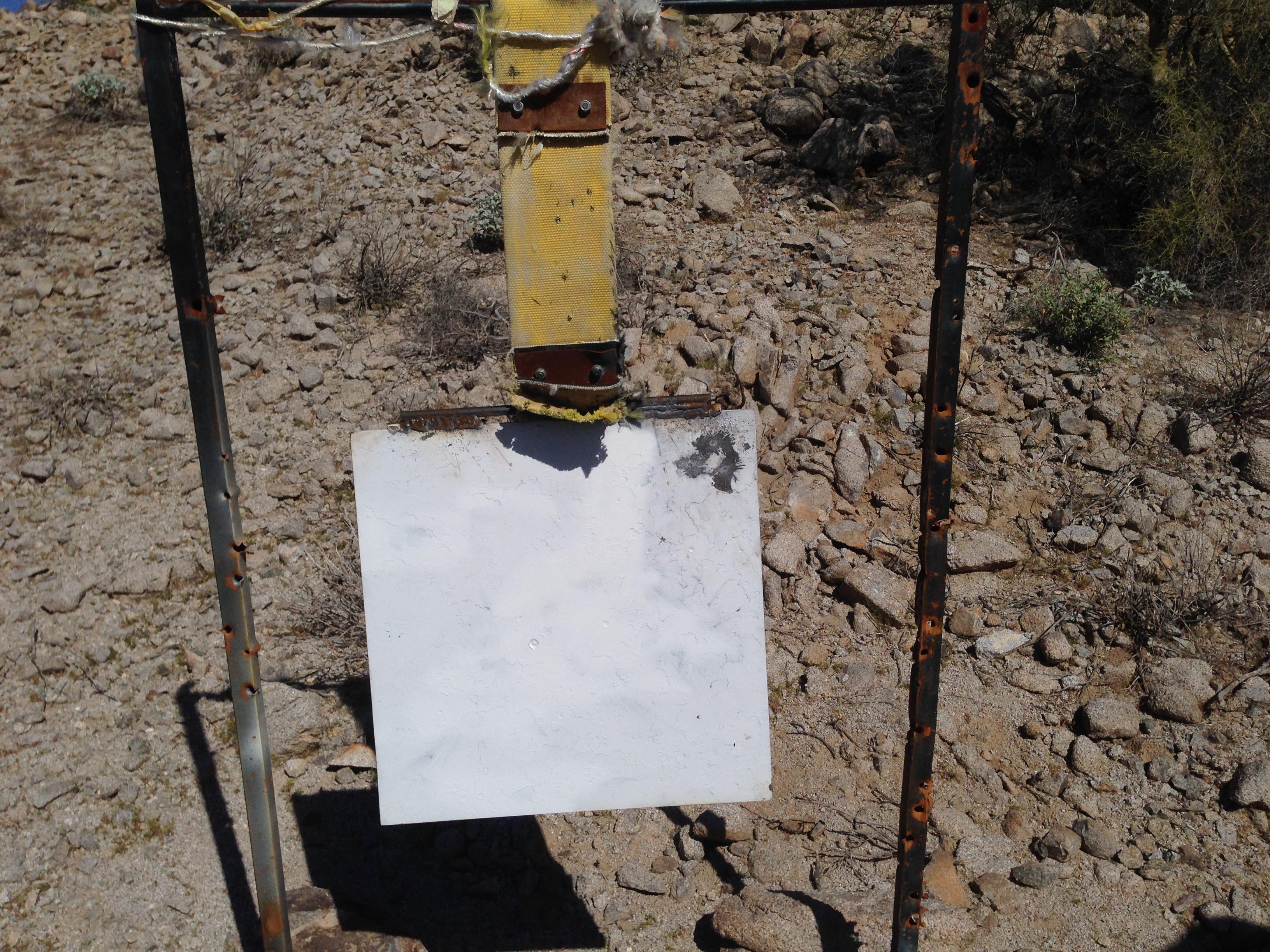

Anyway, besides that, this rifle is stupid accurate. Here are some pics to show proof. I still don't believe how accurate Phoenix Custom Rifles built this rifle. 300 RUM pushing 230gr Match Berger Hybrids @3,048fps!!! The steel at 1,000 is 20"x20"
3 shots at 100 yards=.322"!!!
3 shots at 1,000 yards= 1.75" at most!!!

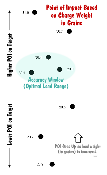

So what's happening on paper? You will get a vertical string of hits. (don't worry if they shift left and right with the wind, that is irrelevant right now, trust me.) First thought is that it's increasing velocity that makes the hits climb up the target, and that is true to a point. What is also happening for the most part is the bullets are leaving the barrel in a different state of barrel flex, or vibration.

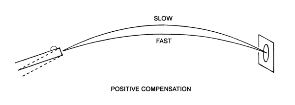

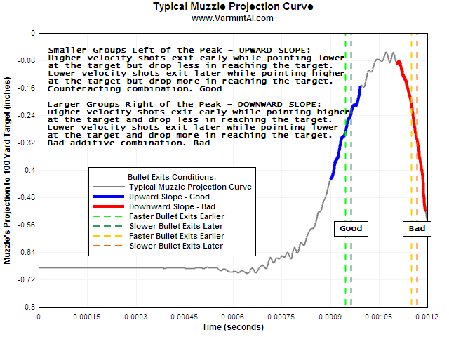

You need to understand this. When you fire your rifle, your barrel flexes in a sine wave pattern. What your getting in the ladder test is the bullet is exiting the muzzle shot to shot, with the barrel flexed more and more up.
BUT, ahah! We got some groups anyway! You will get a few shots that cluster, or actually make a decent group on your target, despite their each one having a(get this) differing powder charge!
ENTER THE "NODE." The node is the very top of the wave and very bottom. For ultimate accuracy, you want your bullet exiting the muzzle precisely when it has flexed all the way up, STOPPED [for a nano second] before it begins it journey flexing back down. This is why you had a decent group or two during the ladder test, despite differing powder charges.
So now your looking at the ladder test target. You got shots all over the place vertically, but some formed nice clusters, or groups.
Note each powder charge that grouped. Let's say for this test, bullet holes 2,3,4 formed a group, and 7,8,9 formed a group.
So this is awesome. In a mere 11 or so shots, we learned at what powder charges the bullets actually leaves the barrel when the muzzle is not moving(vibrating) around wildly.
So now we go home sip a beverage and study and DOCUMENT our findings.
We see 36.5, 37 & 37.5grains shoot in the node of the barrel.

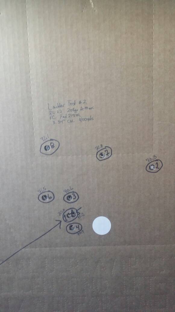

I just ran ladder test 1(course) and test 2 (refined) with my .300 win mag (FACTORY savage tac) I'm to where I need to move to 5 shot groups. But, for my 3rd and most fine/narrow ladder test I moved back to 500 yards. I fired two identical rounds to warm my bore and verify my point of impact on the 500 yard target, using a load from the middle ladder test that was already showing a good powder charge. My buddy who was not down range, not helping me from no where near the target board called back on the radio and said "Damn, don't change a thing, sighter shots 1 & 2 are within 3/4" of each other!!

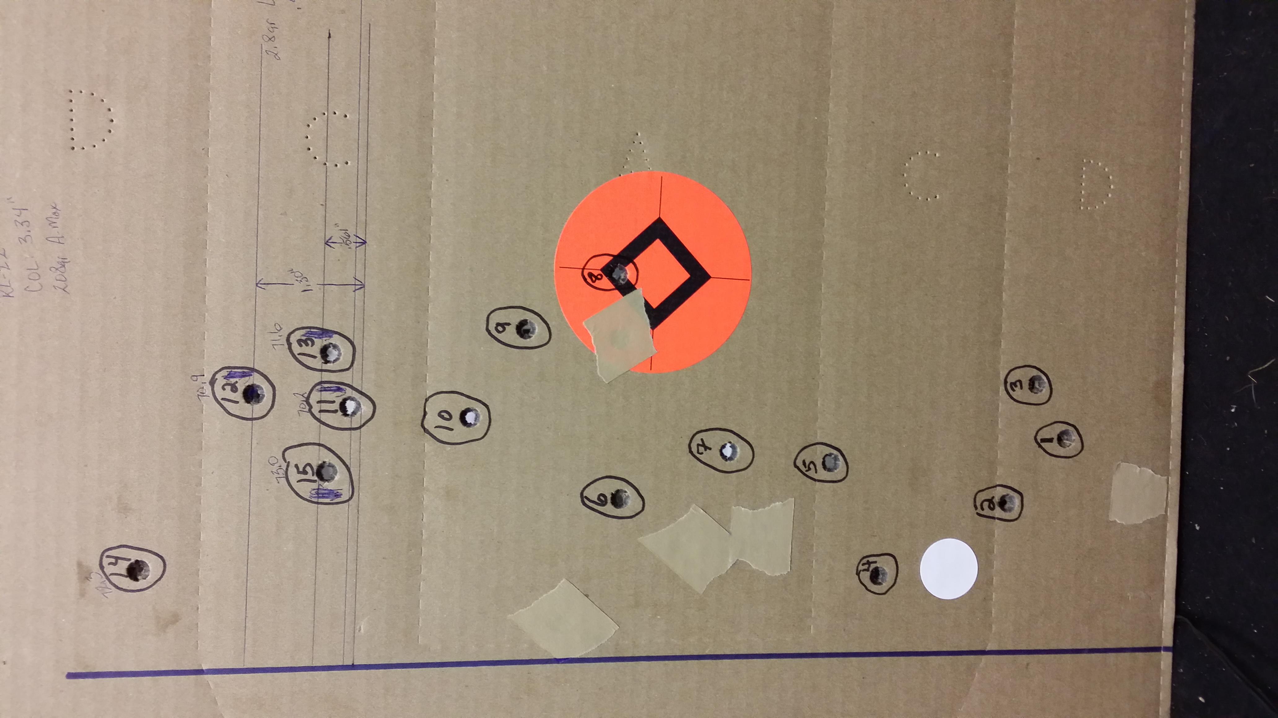

Okay fine! I’ll throw in a picture…
This picture below was the last ladder test I did with my .300 Win Mag Savage Tactical rifle. Each shot was .5 grains hotter (H4831SC powder) than the last.
It's really easy to see exactly where the node is on this target. Shot 1-9 are in the photo but #'s 10 & 11 strung on up the target out the top, not in photo.
Remember that no two of these bullets holes where fired with the same powder charge, but shooting in the node is where it's at- the "four shot group" shown here, #'s 6,7,8 & 9 formed a 3.130" group or .63 moa group @ 525 yards from a factory Savage, with all differing loads. (And obviously in the picture- this was all from wind. I was disregarding and shooting right through wind gusts. There's only .949" of vertical dispersion here or .19 MOA @ 525 laser'd yards.)
Going back and trying my 5 (identically loaded) shot groups should theoretically at least shrink this by half, most likely quitea bit more and identify my rifle's ultimate load with a 210 VLD bullet, and H4831SC powder. From what I have seen thus far with this rifle I'm looking for at least SUB(!) .35 moa 5 shot groups in the end. I'd sure take .2_ moa numbers.

I must be missing something here....
You guys are ladder testing at 300 to 600 yards?
That does not make sense to me at all because at that distance the faster bullet will always hit high and the slower bullet will always hit low and that will contaminate the efforts to identify where in the barrel oscillation cycle you are. Not to mention the effects of light refraction, wind... etc.
Ladder testing at 100 yards is meaningful because velocity spreads will not have enough of an influence on the vertical impact to offset the POI shift caused by barrel oscillation.
If you don't find a POI shift at 100 yards, then extending the range does not find it. That just drags velocity changes into the mix and contaminates the purity of your data. Unless you correlate your POI to the chronograph speed of each shot and run ballistic math on the expected drop relative to actual... and I doubt many guys are willing to work that hard for it. Even if you did, you still have verticals caused by atmospherics, so it would be just a mess of conflicting data.
Simply put... If you don't find a POI shift at 100 yards... then you don't have a oscillation problem within the powder range you are testing, so shoot what produces the best groups, or widen the powder charge variation until you do find a POI shift. But do not extend the range in an effort to find a POI shift and attribute that to barrel harmonics.
Before telling us that established methods dont work why dont you try to actually understand what the tests are attempting to find instead of telling us they couldnt possibly ever work due to your flawed comprehension.
The faster bullet doesnt necessarily always hit higher, in a closed system with no variables, sure, but thats not the case in the real world.
What the ladder test attempts to do is to find a point where the barrel is positively compensating for the rate of gravity on the bullet, aka, faster bullets are coming out low in the upward swing of a barrels sine wave and the slower bullets are coming out later at a higher point in the sine wave.
