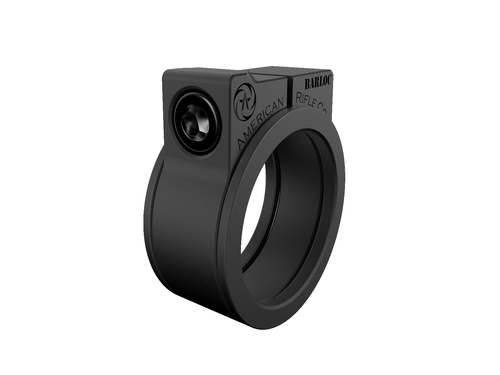

Ok, isn't this as simple as using this barloc,

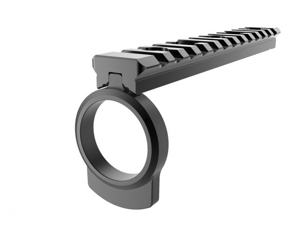

with this recoil lug:
and get rid of the action side tapered washer? It seems like just a different combo of already designed parts.
Ok, isn't this as simple as using this barloc, View attachment 6878732with this recoil lug:
That is the Nucleus specific BarLoc.
The other actions need the tapered washer on both sides. The Nucleus integrates the tapered washer into the Nucleus Specific lug.
Exactly what I said, I just attached pictures to explain. The nucleus BarLoc lug with the BarLoc for a shouldered barrel minus the tapered washer for the action side. The question of course is the id of the nucleus barloc lug. It may be smaller than the diameter of the barrel but it shouldn't be since that's dictated by the od of the action thread, or is the diameter of the tapered ring on the lug different than the tapered washer used in the shouldered barrel barloc?
The ID bore of the Nucleus recoil lug is made to fit the 1-1/16th inch nominal OD of the tenon thread. It's still dictated by the major diameter of the tenon thread.
So, I would guess that the major diameter of the barrel tenon drives the dimensions of the components. I think Ted can confirm or deny that the middle component (the block with the cap screw threaded into it to provide the tension to the two side components) is the same regardless of the outer components. My guess would be that they can be any combination of a nut with a tapered surface, a washer or two with tapered surfaces or a recoil lug with a tapered surface. In any case the dimensions of the tapered surface are the same on all of them. It seems like there could be a mix and match of combinations of a total of 3 components that could be used together to create a 3 piece barloc.
If not, the standard flat nucleus recoil lug could be used in combination with the standard 3 piece shouldered barrel barloc with the only the location of the shoulder dimension changing. 4 pieces not as elegant as the 3 but still possible with only a change in the length of the threaded tenon. The stack height of the total components (3 or 4) would determine the location of the barrel shoulder.
