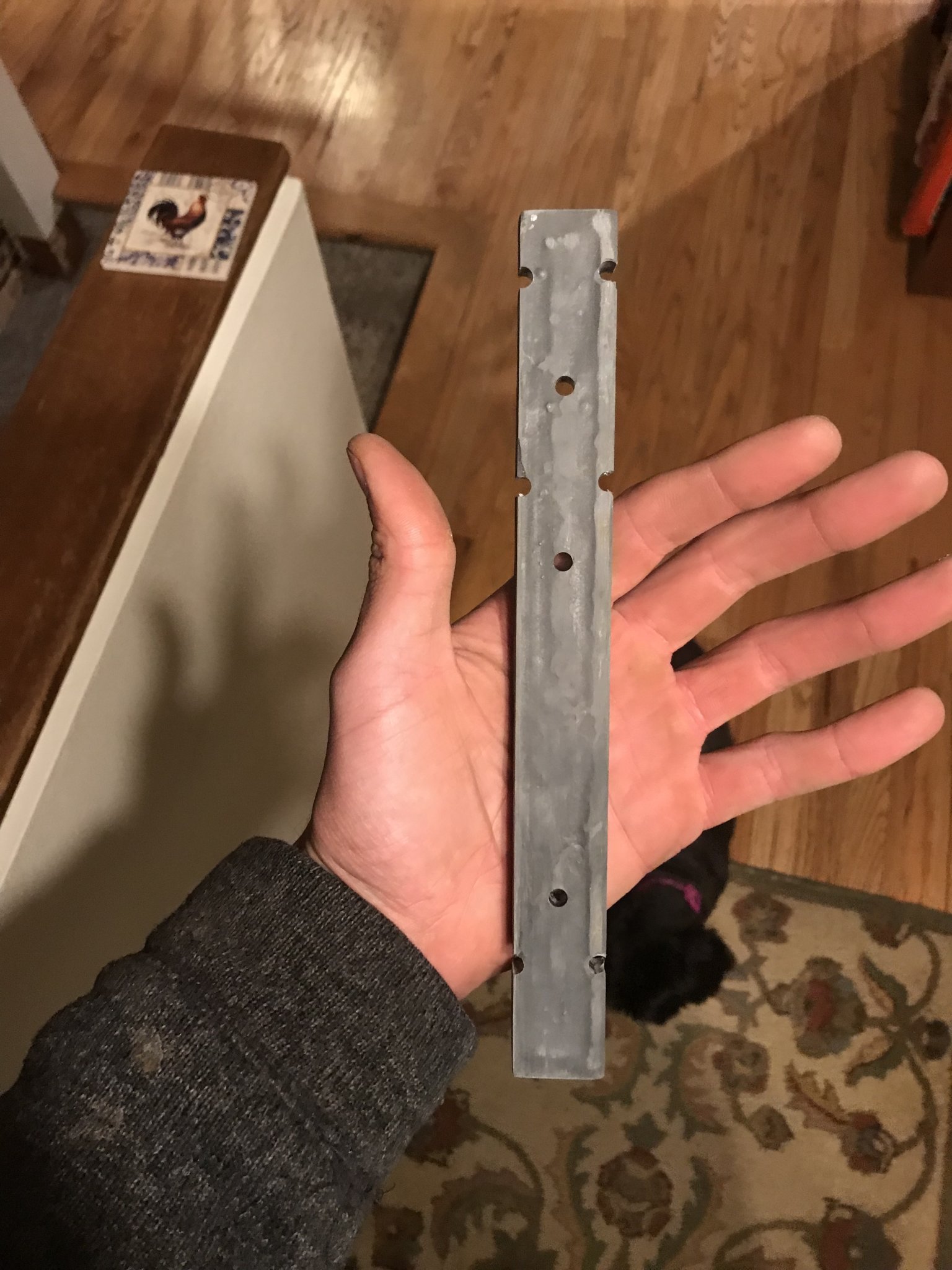

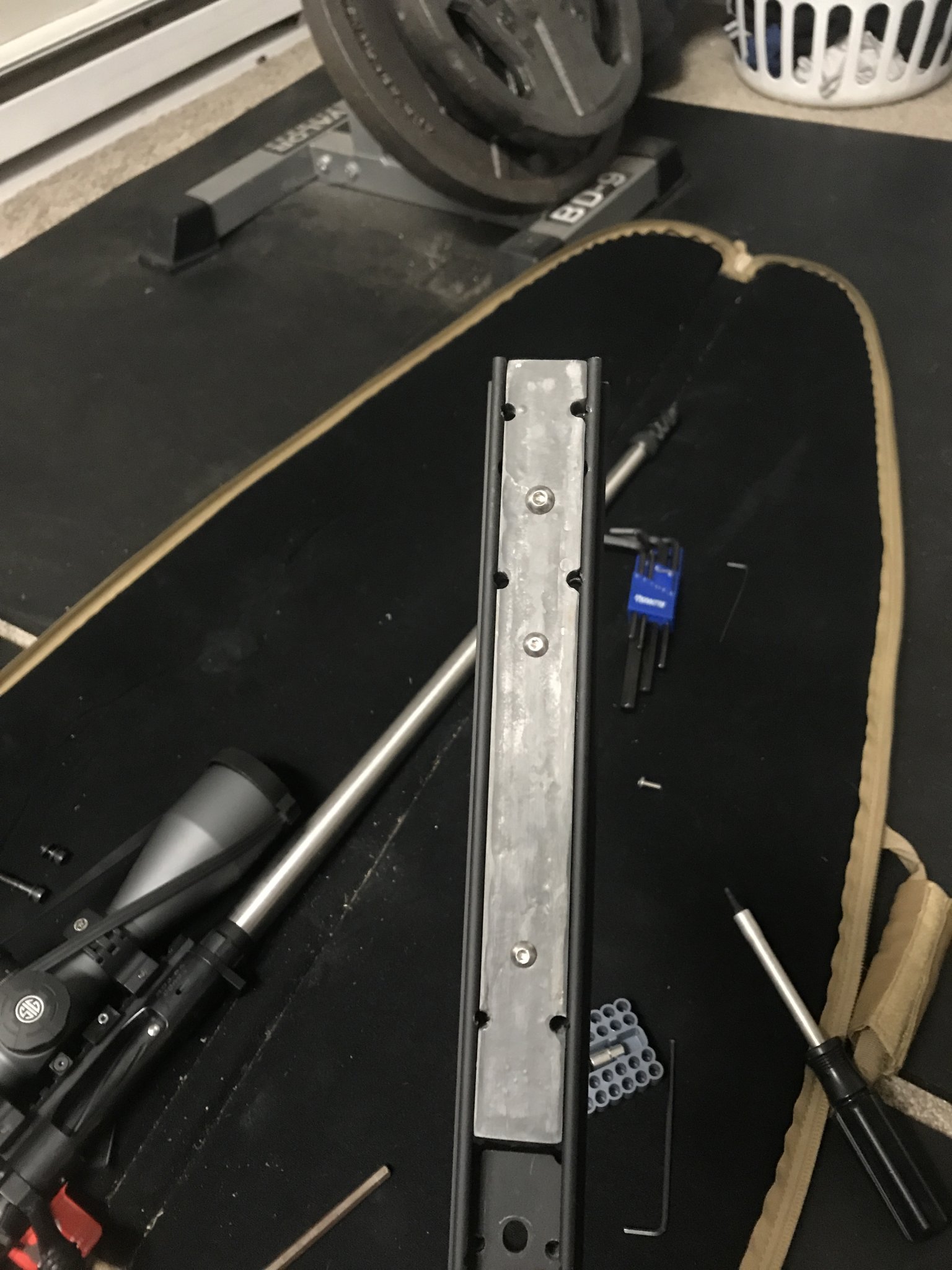

I made my own Forend weight. 12oz lead and 8oz JB Weld original. Made a 1x9 form and then used a drill press to drill holes 24hrs later. Rifle went from 14.4 to 15.6 lbs for $25

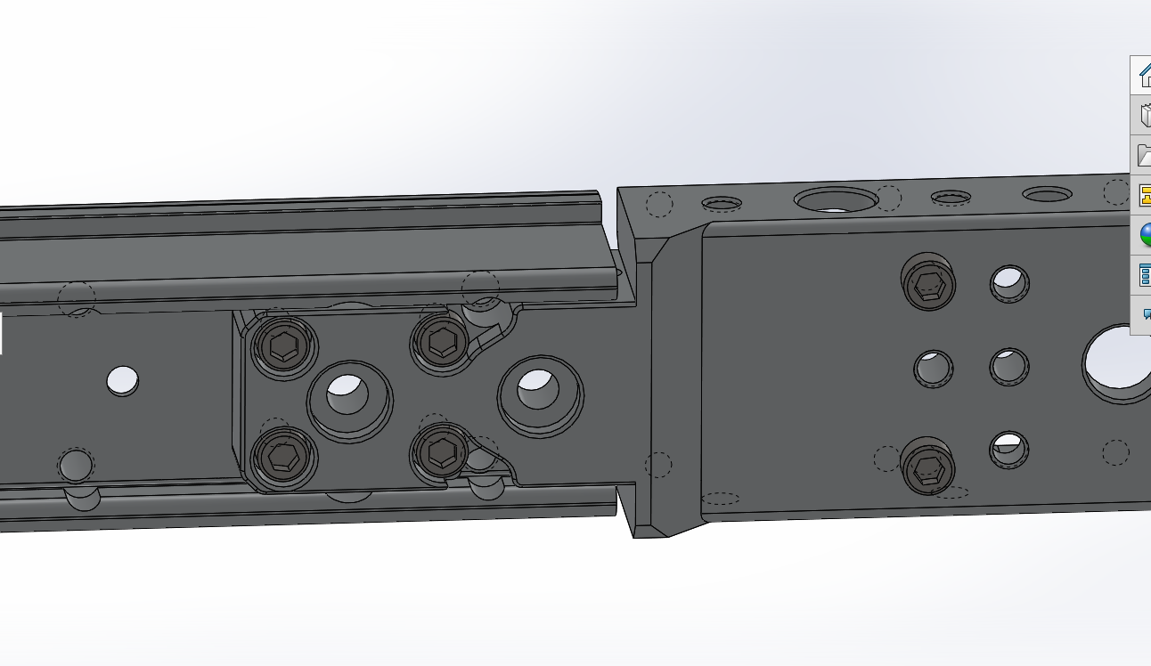

The Arca XL is only meant for the Enclosed Forend. It would cantilever out a little too far on a regular forend, even being 7075. The Arca Spigot would be a better option for sure or there be another company that makes a really stout rail that would work. We are considering a considerably longer Arca Spigot for PRS guys if that's something that would interest you.

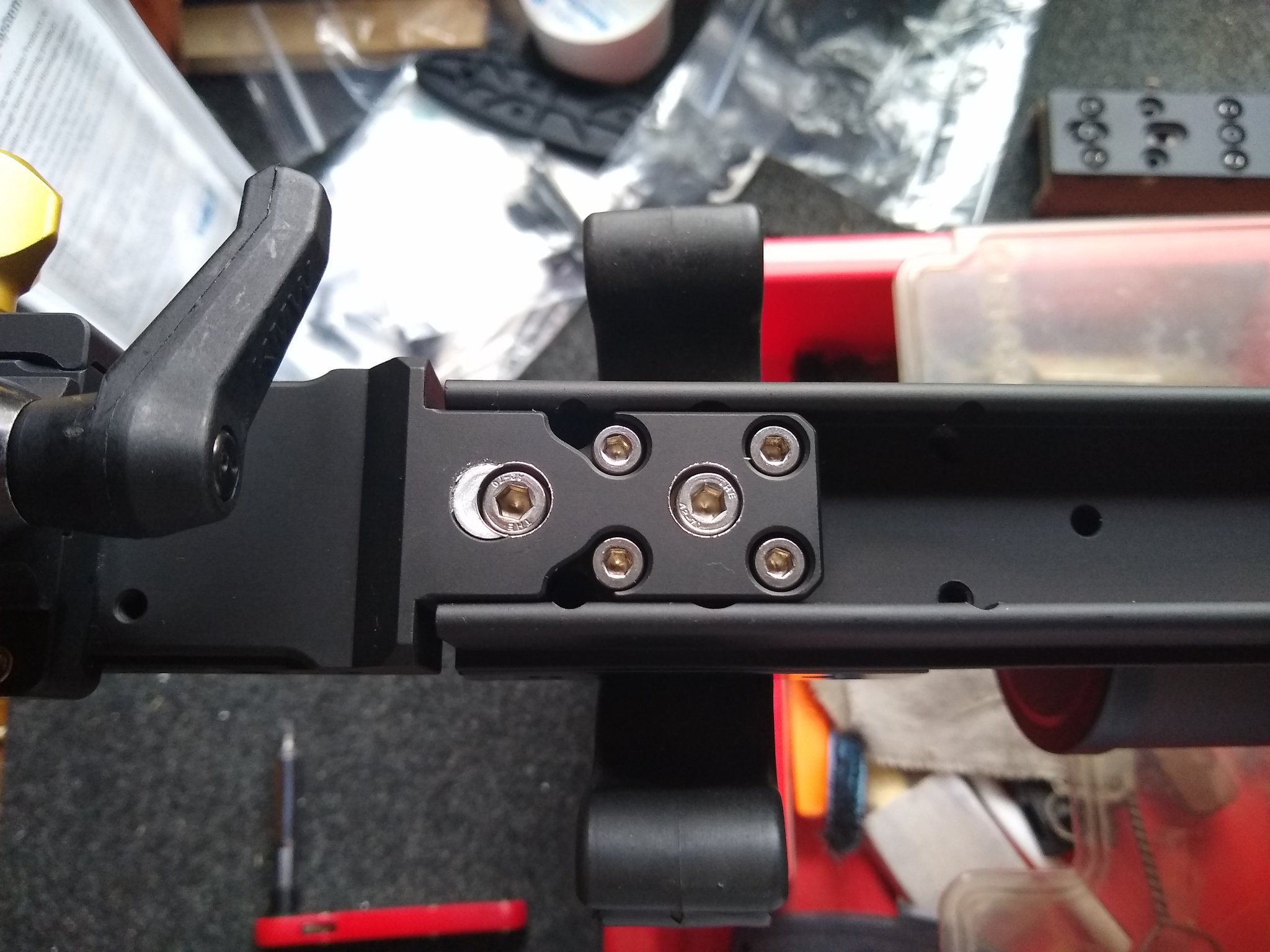

Sorry, mine didn't look like that...
It had the one hole up front, which I turned a plug for, then drilled the 2 holes your print shows.
Ah ok, yes we made a small amount without the holes because most shooters using a Spigot have been going to the NVMC Kit which mounts on the spigot instead of the INVR. We brought the holes back because might as well have them in there. Yours looks nicely done.
Justin
Thanks Justin. After you let me know it was possible, all it took was a Sunday afternoon on my buddy's Bridgeport & it works like a champ now.
I added 2¾ lbs to my Bravo last night, very happy with the outcome. Thanks for doing that, man.
