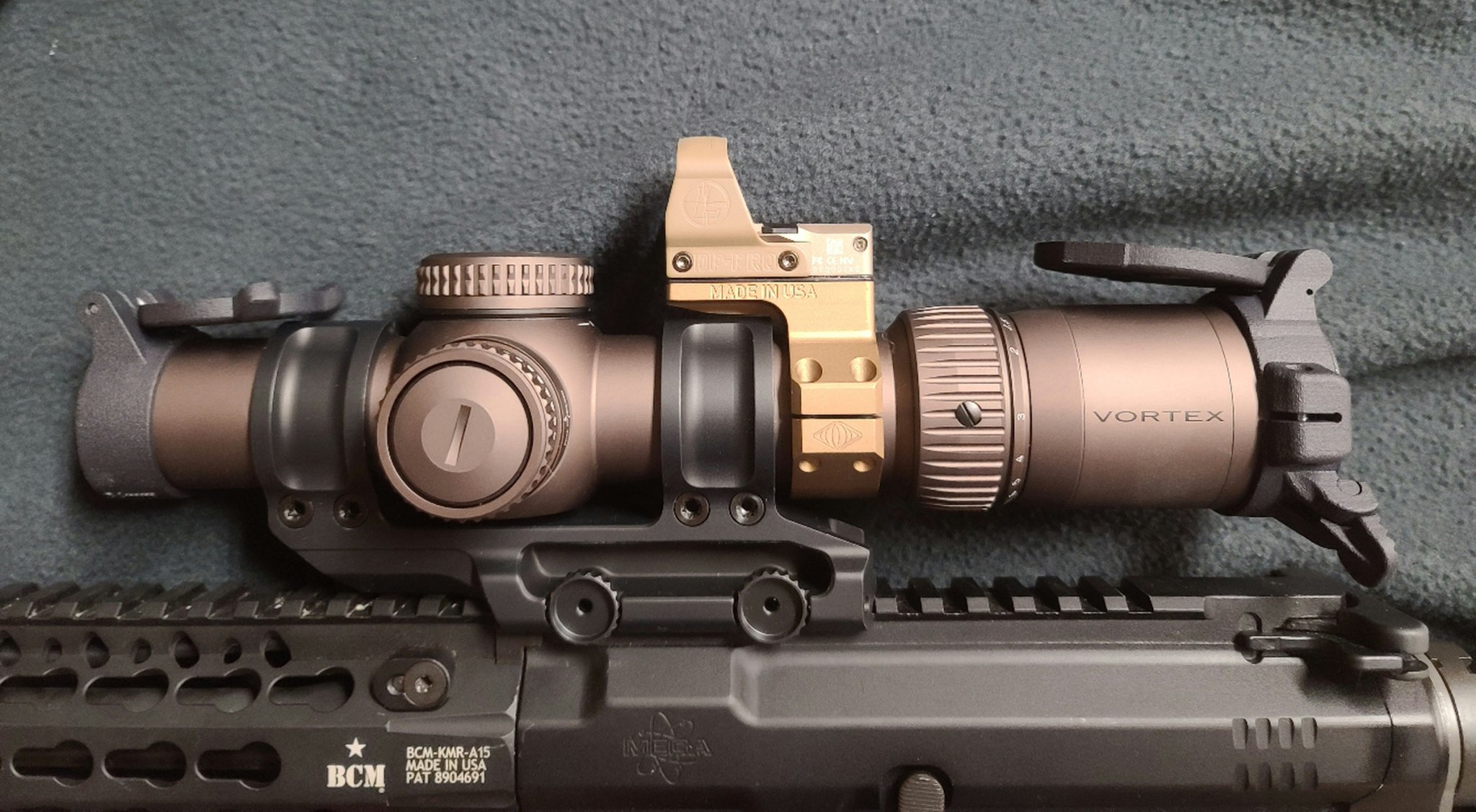

I think we’ve been moving forward. I’ve got an MRO, an EoTech, and a G3 Razor…outside of fighting inside a house, the G3 kicks the asses of the others…if the G3 had a red dot attached, which it will soon, then that combo seems to be the winner.
Agreed. I added a 12 o'clock dot and it's an extremely capable set up. I've only had it out a few times and after years of shooting mostly red dots I need a lot of practice to use it to it's full potential. It's a good enough system that it was immediately obvious to me that I am the weak link. I plan to pair it with a yoterC in the spring time which looks like a great combo.

Agreed. I added a 12 o'clock dot and it's an extremely capable set up. I've only had it out a few times and after years of shooting mostly red dots I need a lot of practice to use it to it's full potential. It's a good enough system that it was immediately obvious to me that I am the weak link. I plan to pair it with a yoterC in the spring time which looks like a great combo.View attachment 7744042
Great setup! I have a Yoter-C and it’s awesome. Great compliment to the G3.
