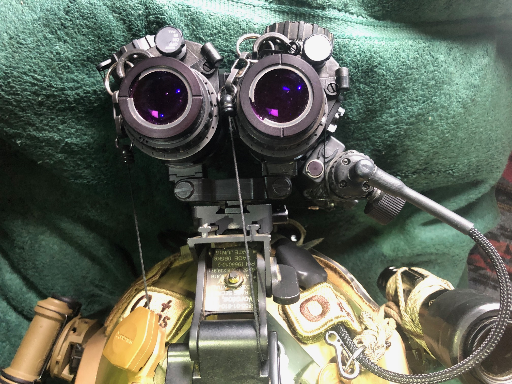

I run 2 Lanyards on my setups. I also have my COTI Lanyarded to my 3/4 " split ring on my PVS 14 which is connected to my helmet via Lanyard.
So another thing that cracked me up about his video, was his "high speed" flipping his NODS up drills.
So if you need to see so fast with your God given peepers, learn to raise your head up and look under your NODS. I can have both of my 14's down and hit one button and effectively use white light and Overide Vis Green laser in a split second with my peepers. Much faster than raising a set of NODS of any sort whether Force to Overcome or Push Button.
If I need to get down on a rifle scope lickety split I just rotate my right PVS 14 up and get on down to business.
Choosing mounts and how your NV system really works and the functions a particular setup offers and affords is very important to getting seamless and solid performance no matter what situation occurs.
Also, if you notice the bolts that hold my shroud on are longer so I can double nut and locktite them. Point being none of my stuff ever gets loose and and all my stuff whether Helmet or rifle mounted is pretty much lanyarded off such that you can NOT loose you NV-Thermal equipment. I also will not tolerate any wobble and wiggle in a system. Slivers of electrical tape in strategic areas to take up any "slack" is a good skill to learn. :)
You spend enough time out in the "wild" and you will learn how to secure your equipment properly or either shell out some big bucks replacing lost or damaged items.
