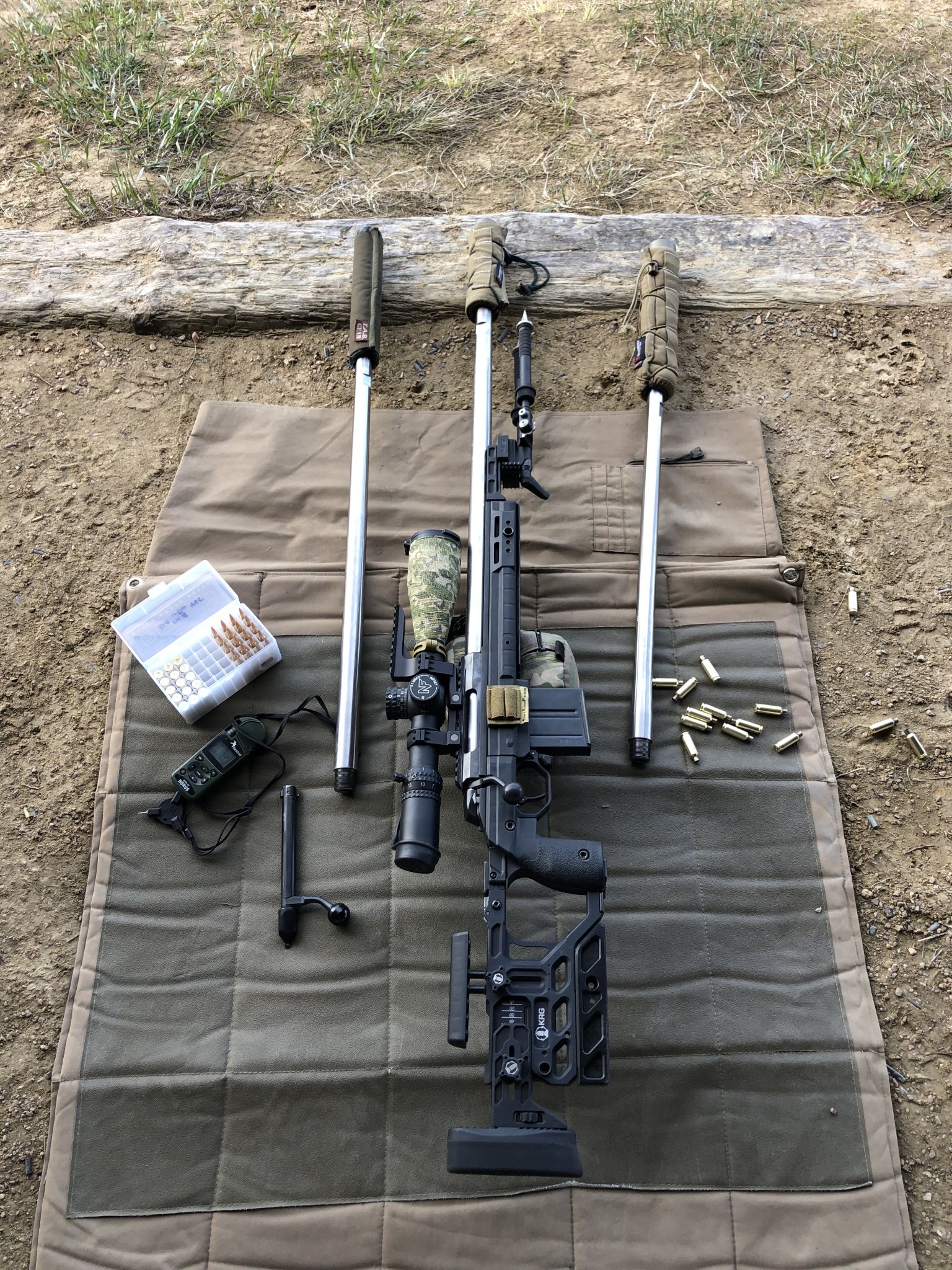

I think of my set up as the poor mans axmc, just no long action. I have three bolts and numerous barrels. 233, dasher, creedmoor, 6.5 saum. Accuracy wise you give nothing up with gunsmithed barrels. Cadex does have a chassis you can swap bottom metal on, could do a long action

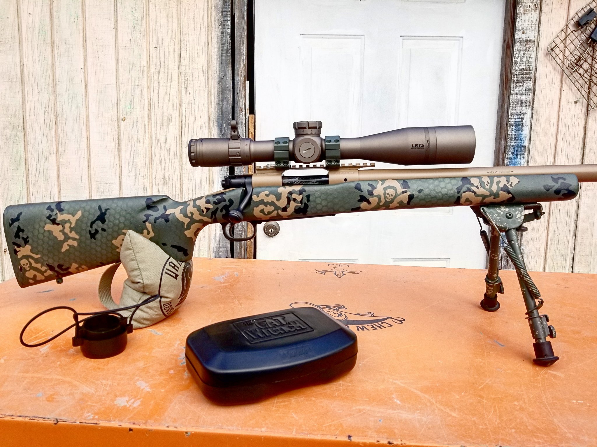

For what its worth I still like my first precision rifle based on a Remington 700. Criterion barrel, Tubb T7T trigger, Grayboe Renegade stock, PTG bottom metal. No additional work has been done to the receiver.
I also have a Defiance Deviant build, and while it is much nicer, the "custom" Rem700 will shoot right with it.
Ejection is about the same, no issues with the Rem extractor, and feeds reliably.
Where the Defiance shines is the overall fit and finish, integrated scope rail and recoil lug, and primary extraction is functional.
